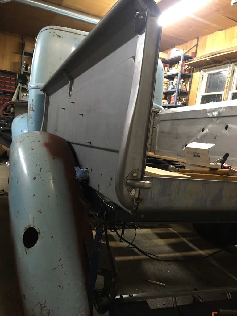

    I wanted to drive the truck to lunch last Friday, so I rigged the filler pipe with some lock wire. I got to lunch and back , but the lock wire was not doing it. I had painted the bed where the rivets went so the next step was to start assembling the bed. my logic was/is that instead of fabbing a temporary brace for the gas tank fill pipe, I should put the bed together. I could then re install the fenders and thus .... the fill pipe.;)
    Here are dome pix. IMG_0706 (800x600).jpg IMG_0707 (800x748).jpg IMG_0708 (492x800).jpg
  8. Isn't there some sort of cutout for the gas fill in the lower panel of the bed? Can't remember ....
  9. joel
    Joined: Oct 10, 2009
    Posts: 2,482
    joel
    Yes there is; it is smaller than on the car.
    1Nimrod and Fortyfordcmm like this.
  10. Gotcha - thanks. I just didn't see it in the photos ....

    Joel, I like the way the truck is coming out. I noticed the oak floor had cut outs by the wheel wells, I Used Mac's in MO. for my wood with SS strips and there were no cut outs, I also used hidden hinges with spring loaded pins and added SS cables with PVC covers and Heim ends instead of chains.
    See Picture Suggest a little metal work on the gas tank filler notch to make it easier to install rubber connector to the fill tube in the driver's side fender to prevent chafing
    Geoford41

    My kit is basically a Northern Classic Trucks unit supplied by Midwest Early Ford and the boards in the pix are "spacers" and the real floor sits on top of them. It appears that Macs is the only one that makes the steel floor ( as original ). I'm just learning this stuff; my original bed was so rough that I didn't know how it is supposed to be.
    Good idea on the filler notch. I thought I'd loosen the tank bolts and see if I can get a better alignment. I just finished the welding required on the rear of the bed. Next is some modification on the hinges to improve the tailgate fit. IMG_0718 (600x800).jpg IMG_0719 (600x800).jpg
    I'm not going to mess with the bed wood now; I just want fenders and lights for now. My coupe is yelling at me from the other room.
