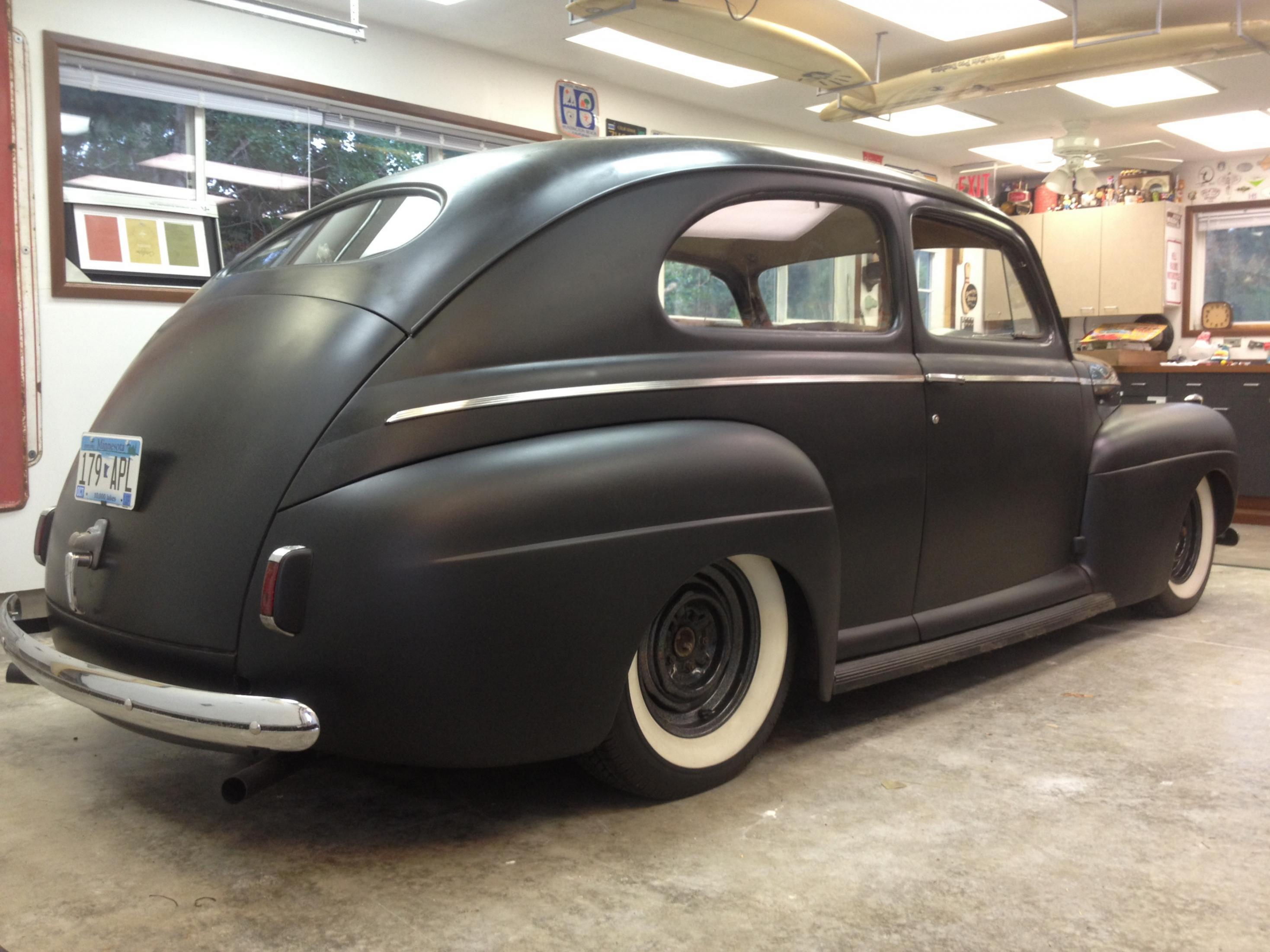

  11. mbrede
    Joined: Aug 7, 2008
    Posts: 53
    mbrede
    from Minnesota
    My '41 sedan sits on a S-10 frame. Only mods needed were to shorten 5", shave a bit off the front rails, and c notch the rear. Kept eveything else intact, brakes, steering, suspension, etc. Easy to slam and rides, stops, and steers like a dream. Couldnt have been easier.

  14. mbrede
    Joined: Aug 7, 2008
    Posts: 53
    mbrede
    from Minnesota
    Sliced it right down the middle.
