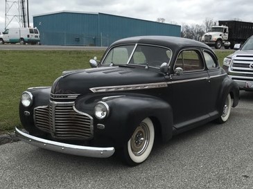

    Apparently it's got a camaro clip up front. I'd rather it had been original but I don't mind a little creature comforts. The sofa isn't too pretty in there and I agree that there's a change needed there too.

    They look sweet sitting lo. Funny how the lower they go the fatter the fenders look.

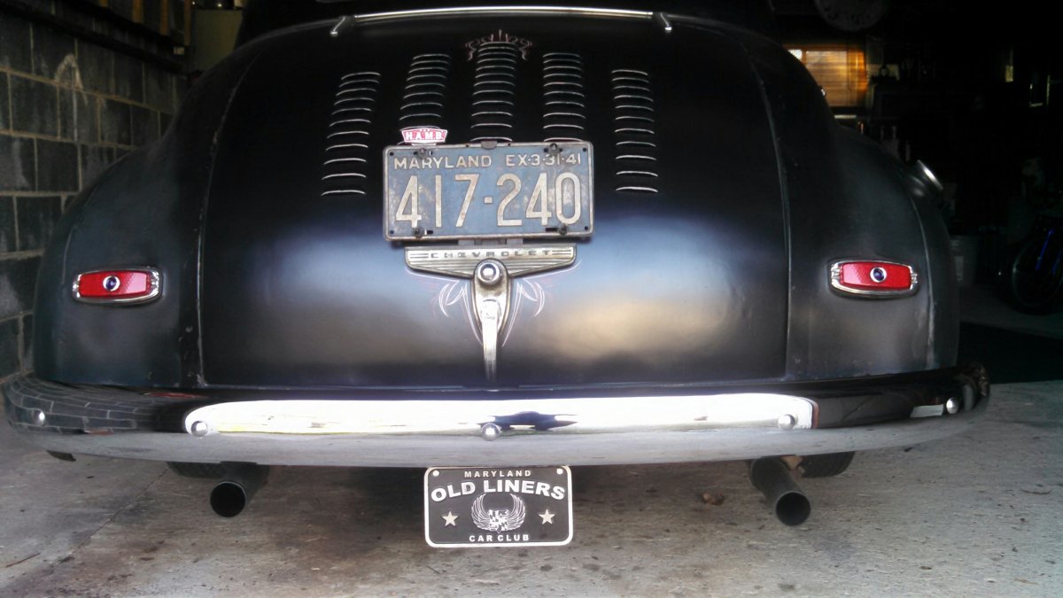

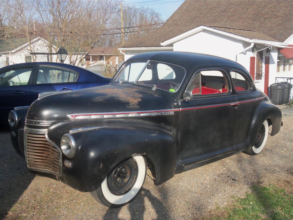

  16. Hey looking forward to seeing your progress. Here's mine. I ultimately would like to build a non adjustable suspension taildragger (Chopped, skirts, custom early 50's hubcaps) but not sure if I'll ever get there. This is the day it was delivered to me in April 2014.

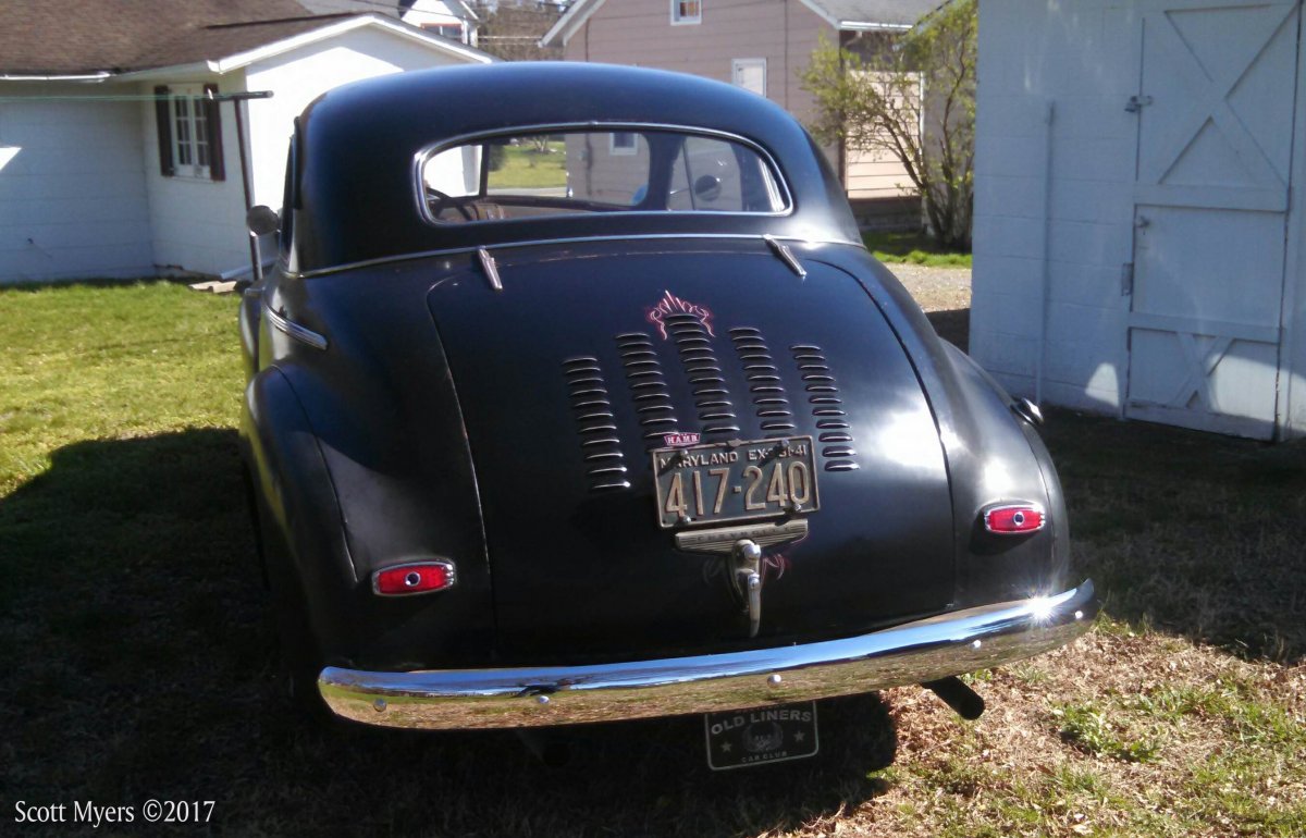

  17. Added spider cap/ rings, chrome bumpers, and louvered the hood and trunk lid. Has a small block 283 and 4spd on the floor with a HAMB #41 Shift knob :). 4" drop in the rear, and up front I cut 2-1/2 coils from the springs. 51275357802__0EB48D01-F7B8-4D55-AAC0-55CB78D5F97A (2).JPG IMG_20170402_160304_693.jpg IMG_20170402_160322_052.jpg IMG_20170402_183402_572.jpg

  25. I meant to say 2-1/2" of the coil spring was cut. lol
