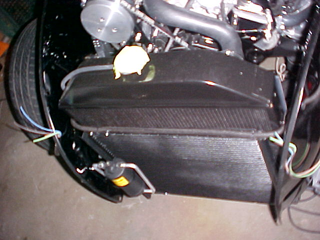

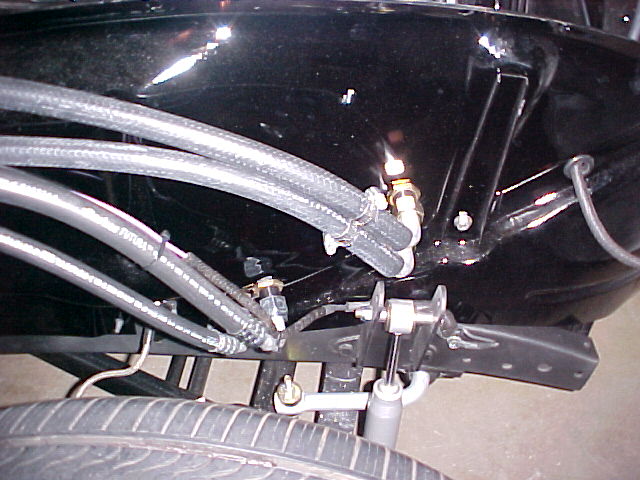

    don't run your lines/hoses thru the firewall. run the drier and lines between the inner fender and fender on the passenger side. drill holes in the passenger side cowl
  6. cafekid
    Joined: Dec 4, 2008
    Posts: 380
    cafekid
    This is how I run the lines on customers projects. I also build hangars for the lines to mount off the hardware that bolts the inner to the fender, that way there are no extra holes or hardware.

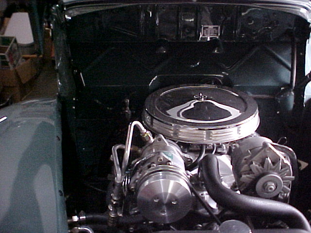

  13. olscrounger
    Joined: Feb 23, 2008
    Posts: 4,606
    olscrounger
    done a bunch ----no lines thru firewall,cowl vent functional,no ashtray vents--still have short glove box---nothing odd under the hood--very little shows inside as well--send me a PM--have done 12 so far in 40's since 02--doing one now,a 40 std coupe

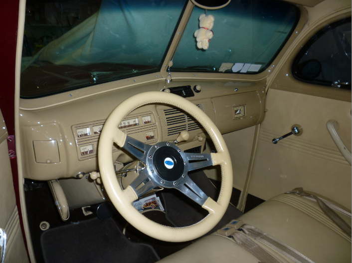

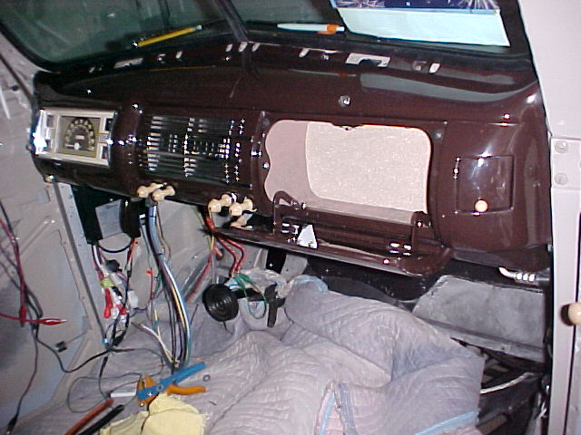

  16. olscrounger
    Posts: 4,606
    olscrounger

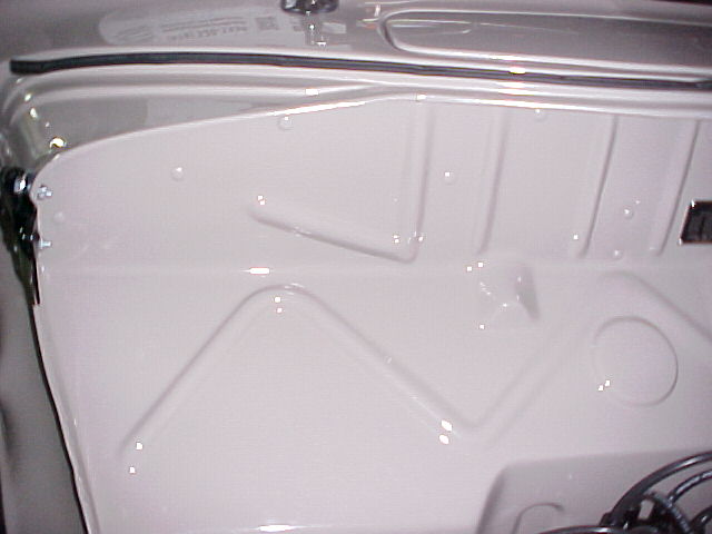

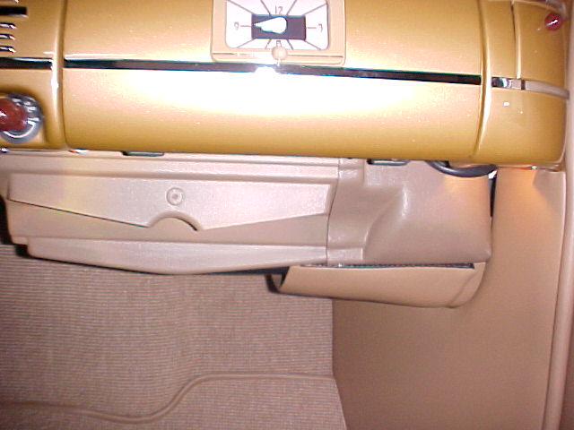

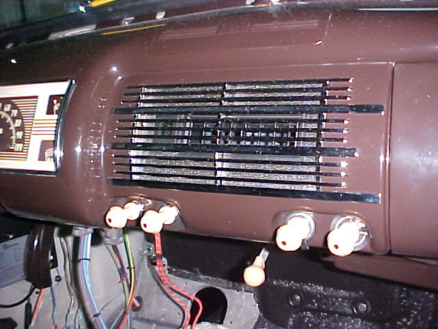

    here are some pics I hope-stock knobs control ac,you can see one vent behind radio grille--other are at corners of dash under the edge-pass kick panel has alot ot stuff but is hidden by panel-kick panel is out at bottom 1" from stock=cowl vent functional-hope this helps someone=not quite done yet but you can get the idea. ac is held to firewall with small stove bolts painted that look like ford rivets on firewall elsewhere

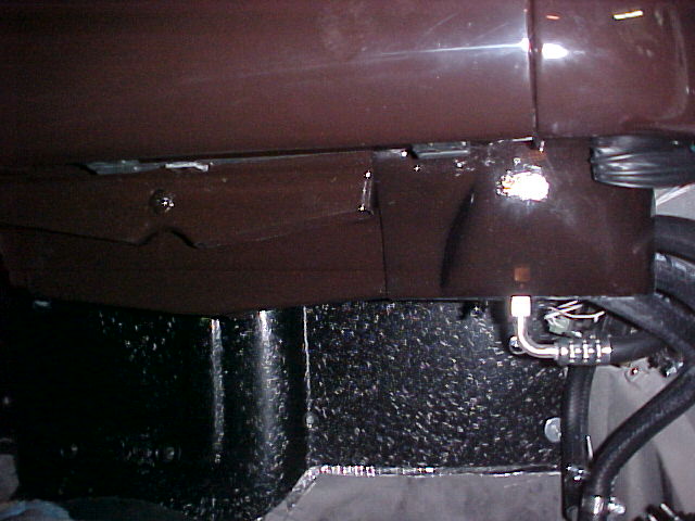

  17. olscrounger
    Posts: 4,606
    olscrounger

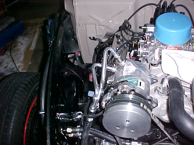

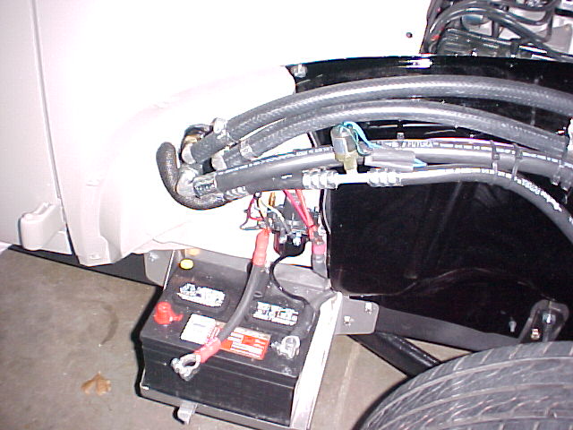

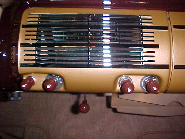

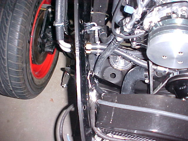

    more pics-there is a soft rubber flap near the top of the fender rear that hides stuff somewhat and blows back when fan is on or driving.Excuse the mess-not finished with many items-still need to do the stock column with detents and finish radio/XM install and lots of other stuff too-not done yet---maybe in 3 weeks I hope

  18. olscrounger
    Posts: 4,606
    olscrounger

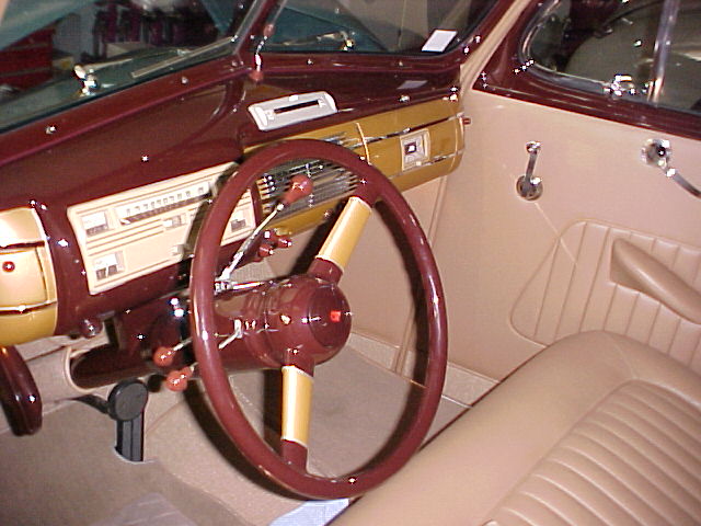

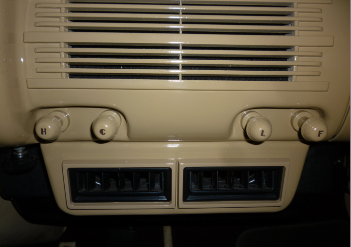

    heres the air in my 40 dlx. You can use the defroster vents that come in the ac kit--just need to modify a little to clear wiper mechanisms-much easier to do with dash out but can be done with dash in as well--just more difficult

    I ran my hoses outside also but havent completed everything yet. good to know it works, I was concerned. also I love the idea of the vents in the speaker grille. But I have the a/c controls, cruise control switch, and heated seat switches on an engine turned aluminum panel in place of the grille
  22. okiedokie
    Joined: Jul 5, 2005
    Posts: 4,568
    okiedokie
    from Ok
    "there is a soft rubber flap near the top of the fender "
    Tim, could you show us a picture, or maybe explain a little more. Thanks for continuing to share your builds with us.
  23. Aquaroscoe
    Joined: Apr 13, 2006
    Posts: 315
    Aquaroscoe
    See Pic MVC-017F.JPG there is a rubber flap that has been added between the top of the fender and the top of the battery to hide where the hoses enter the side panel to the inside of the car

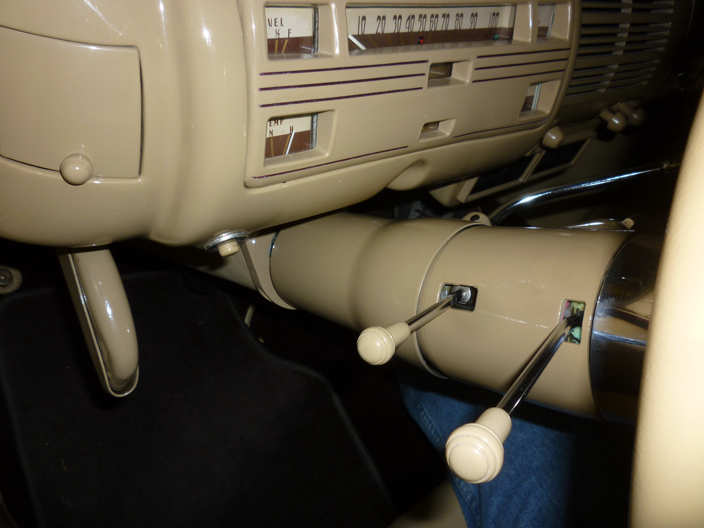

    Your AC installations look great! I really like the way you made things appear to almost be "stock". I ran my AC hoses in a similar manner, but inside the engine compartment.

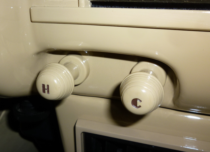

    I also used the stock 40 knobs on my coupe, and dad's tudor.
    I see that you used all cigar lighter knobs, I used those on my coupe; I just cut the threads off the backside.
    I used light switch knobs on dad's tudor. The light switch knob shaft can be removed from the knobs and the hole drilled out a bit; they have a cupped skirt that completely covers the switch attachment nuts (cleaner looking). With the exception of the actual light switch knobs, I sanded off the "L" (or the "O" dot on the cigar lighter knobs I used on my coupe). I then cut single letters into each knob that matched the "art-decco" style, and painted them to match stock knob lettering ("F" for fan speed; "H" for heat, "T" for temperature."C" for cool.). I turned down cigar lighter knobs to make radio, turn signal, and column tilt knobs. I opened up the hole in a stock gear shift knob, and glued it onto the later shift lever.
