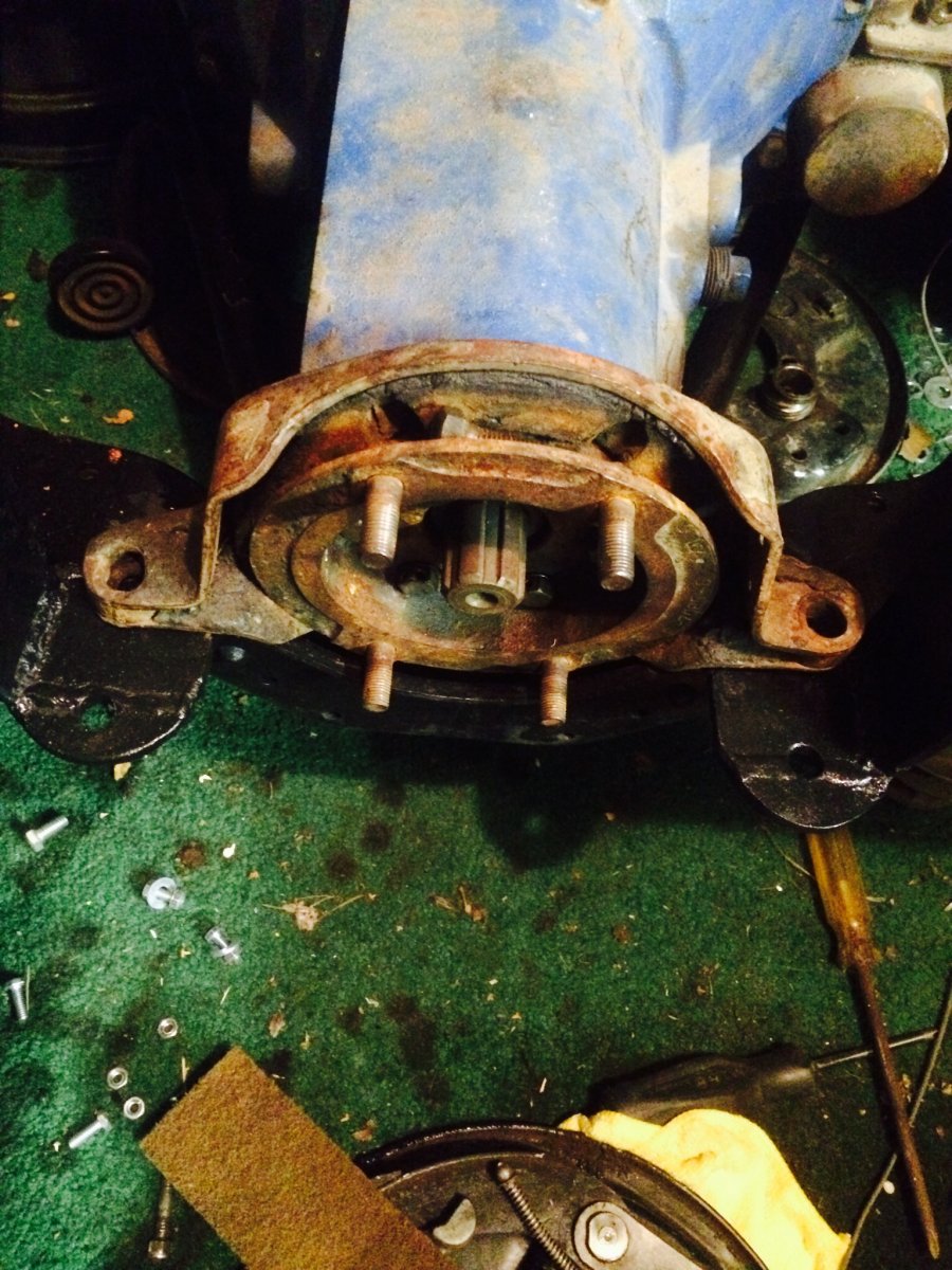

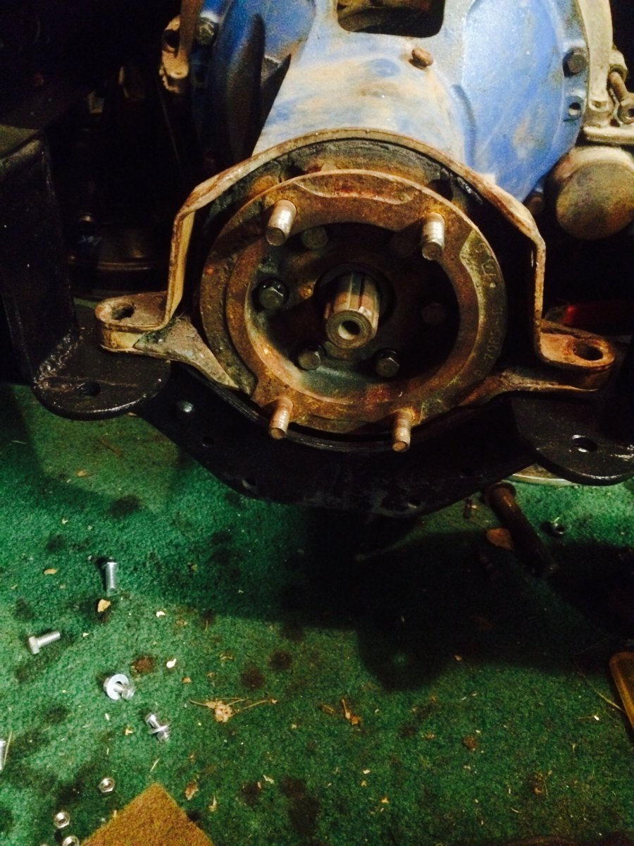

    My trans ears or tabs are cast as part of the case. Are you saying I need to wack'm off and bolt on a 32-36 style?

  9. There are bolts around the shaft where the U joint resides. Unbolt those and that entire rear piece comes off. I can see the seam in the pic

    Thanks Dan, I see it now too and recognize it as the style that I've seen that removes.
    I was writing this while away. The trans is also buried. I was just starting to plan this part out.
    I should have cleaned it by now and would have saw this, I feel so stupid now.

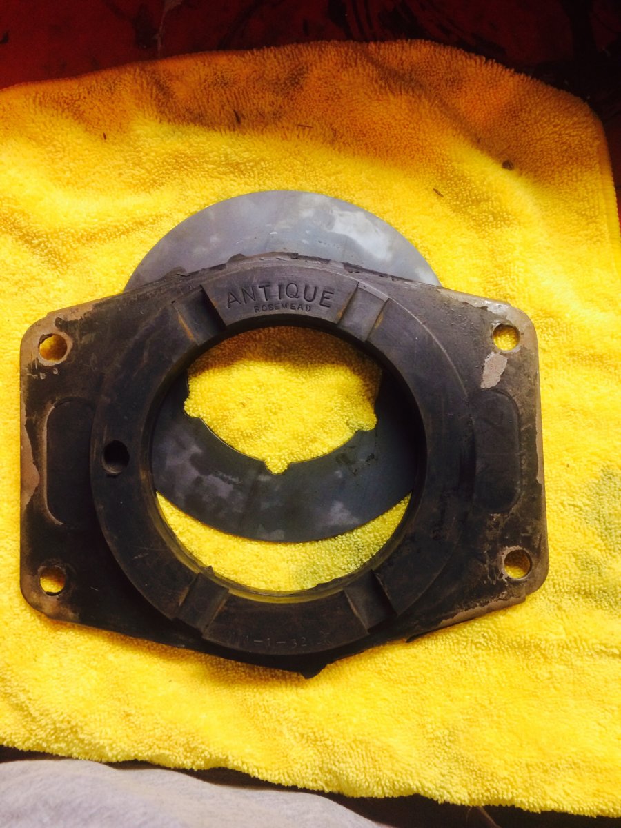

  13. image.jpg image.jpg image.jpg image.jpg image.jpg Here you go Wyatt. First is 32 for k member, second is 35-36 and I'm not sure the last one. It might be 33-34 but not sure some help here would be nice from the teachers. Last is bob drake I guess the last mount may as we'll be 40-48
    Runnin shine likes this.
