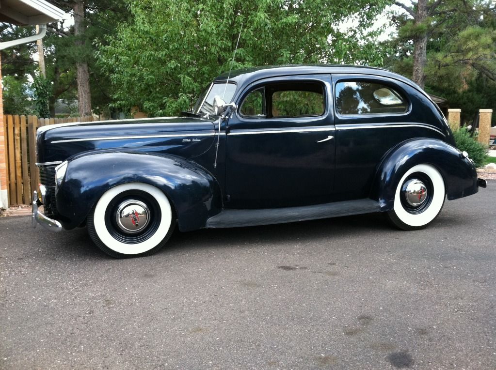

    One question. IIRC, the earlier V8-60's had transmissions that were quite a bit "lighter-duty" than the 85HP cars. Is this also true of the 40's, or did they use the regular transmission?
  25. CTaulbert
    Joined: Apr 8, 2007
    Posts: 1,306
    CTaulbert
    from Detroit
    The '40 V8-60 trans carries a different part number, but I believe that is only because the starter mounts closer to the centerline of the crank due to the smaller diameter flywheels.
    That said, a '40 V8-60 trans is equipped with the same gearset of the 90hp car.
