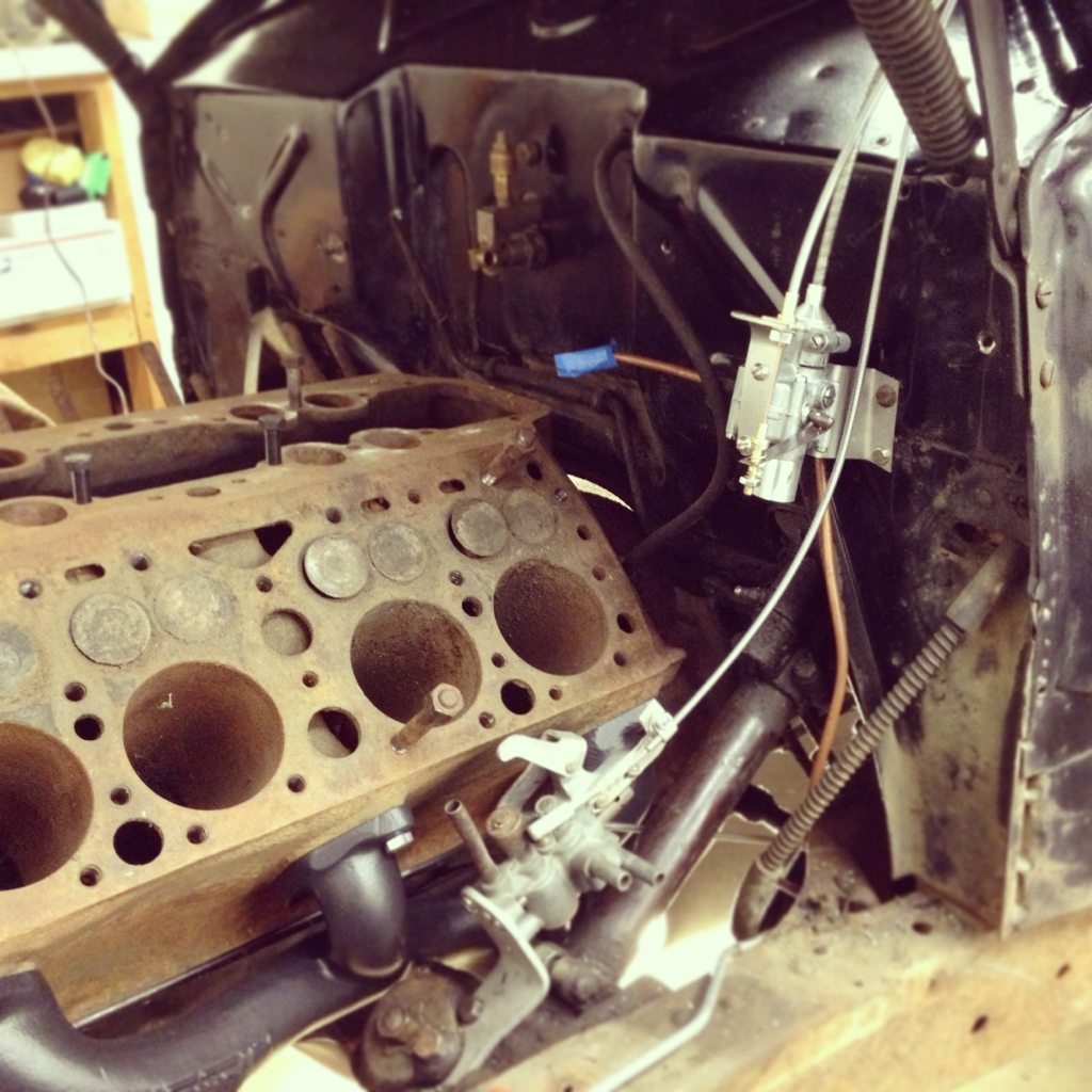

    Finished mounting and adjusting the Columbia controls tonight. I still need to run the plumbing to the rearend, but that shouldn't be too hard. The exhaust fab starts tomorrow.
    Posted from the TJJ App for iPhone
