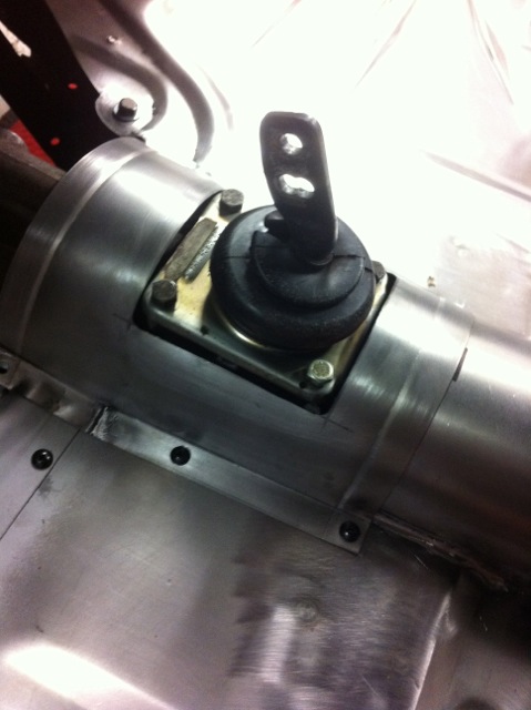

    I've got a T5 in my 40 sedan, the chap that fitted it had to remove the top of the chassis brace, and modify the bottom of the brace for the mount. There are pics in my build thread, if you want more info, just ask, ad i'll do waht i can to help

    Just looked at my build thread, looks like Pbucket's dumped all over it, so here's a few pics, hope they help

  10. Is that a mustang t5? The shifter is right where my seat is in my 39.

    Thanks for the pictures, you did a great job. Unfortunately I have to do this with a finished cab and bead in place. Seeing what you did will make it easier
