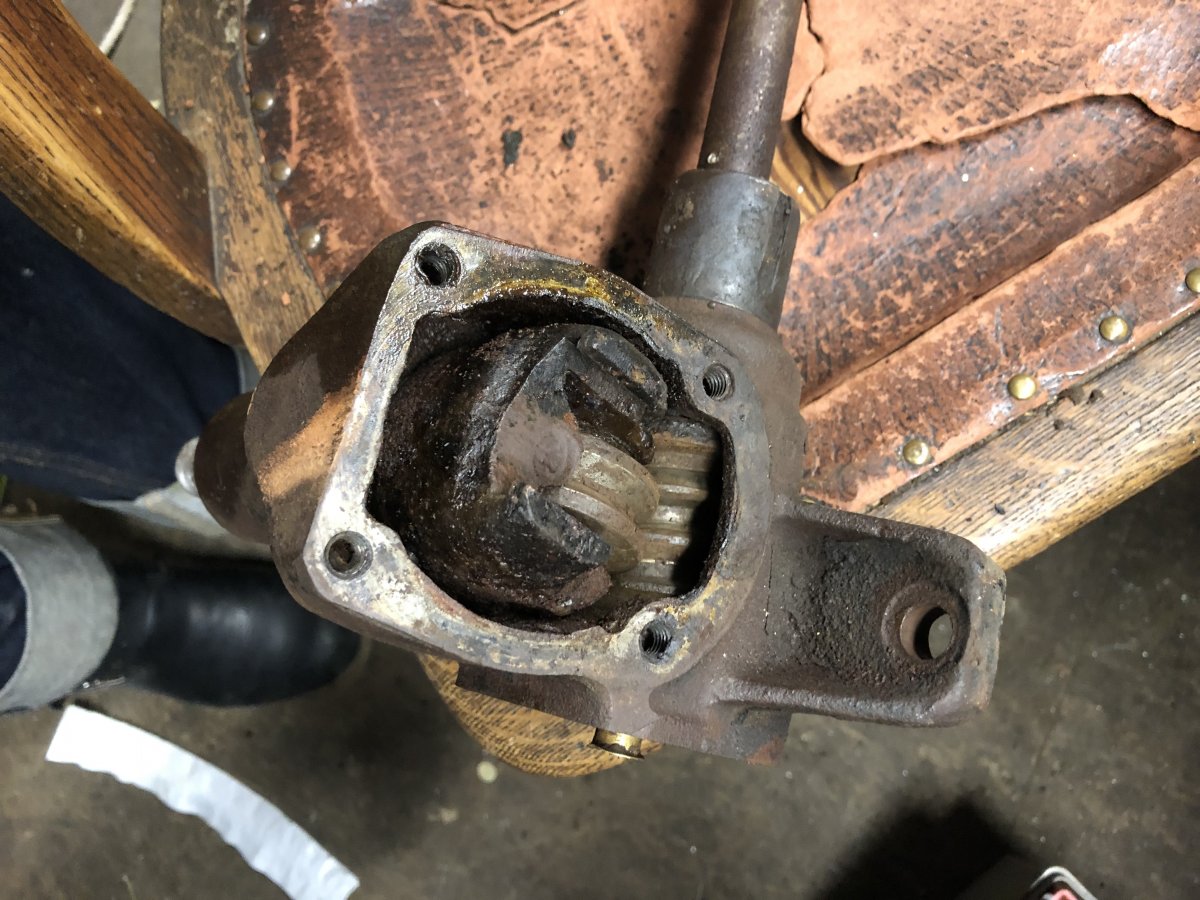

  1. '40 Ford box out of Frank Maratta's original '30 coupe, I've found a rebuild kit but before I break anything how is the sector shaft supposed to come out? IMG_1041.jpg IMG_1042.jpg IMG_1043.jpg

    once you got the tin cover off the back, it comes right out that hole. should just take pushing on the spline end. stiff from old grease and wear, but just push it out

    Just last week my son & I were taking one apart that the old lube inside had turned to shellac making disassembly near impossible. We dumped some gas into the cavity and let it sit for a while. It loosened it up to let the sector slide out.
