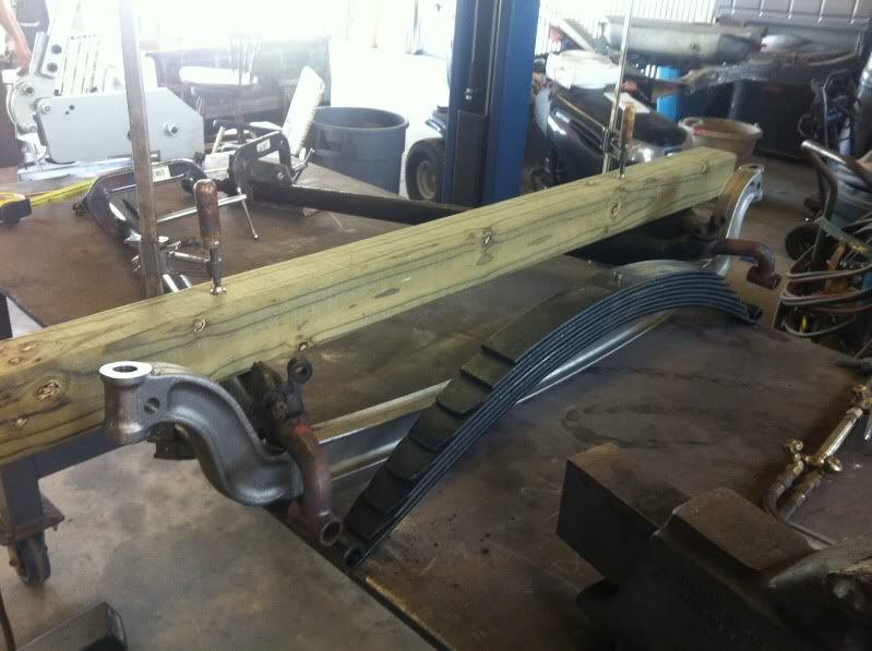

  7. A couple of weeks ago we had an official CrossMembers CC pow-wow at Roothawg's ranch. I threw the front end in the truck and after the meeting we jigged up the assembly on Root's table. We heated up the spring perches to cherry red and with a large pipe wrench, we persuaded the perches to again be perpendicular to the axle
    After I got back to Texas, I got to work painting and assembling. For the chassis parts I'm using Rust-o-leum's appliance epoxy gloss black. It's good stuff. Even though this is a fat fender car and the underside will never see the light of day, I couldn't help but detail it a little. With the angle grinder I smoothed and polished the ridges of the axle, then covered it in clear. Not show car, but I like it.
    Assembly... What you can't see in this pic is Limework's Oil impregnated bushings. Those things are cool, went in with little trouble, and will last much longer than nylon.
    Bolting it up.
    This picture doesn't do it justice, but I jacked it down to a rough estimate of ride height. Approx 13" from the kingpin center to the floor. (Half of a 26" 550-16) With a motor and assembly it will drop and inch or two more and sit pretty darn good....even though it doesn't look like it here. The stance is one thing I did a lot of research on. My car must have the right stance.
    Up next is the steering arms, kingpin reinstall, tie rods, drag link and sway bar. This front suspension is almost done!

  14. What are using for a front spring? Judging by the unloaded shackle angle in your pictures, it appears a little wide. I am using a narrower leaf (about 36" c-c) from C.E. on a similar front end.
  15. It's the CE narrowed spring for the 47" axle.

  17. I think I know what you're seeing, it's an optical illusion, because the spring is not on the same bolt as the shock. The shock is on its own stud. I know that most aftermarket shackles have the spring and shock sharing a stud. From the angle of the pic it does look like the spring is too long.

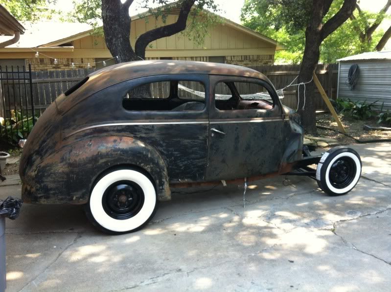

  30. Today it's back on all four wheels for the first time in a year. I was very motivated to get it back on wheels because I have to take it to the automotive theft task force for them to verify the VIN. Then I can proceed to get a bonded title. The car came with a good and correct title, but it was signed (forged probably) and not notorized. Several guys suggested finding a wink wink notary to fix the problem, but I just couldn't do it, my conscience wouldn't let me.
    I know that it's pretty early in the build to buy tires, but I came into a chunk of money unexpectedly, and the wife graciously agreed to a set of Cokers. And with two kids, if ya don't spend it, it'll be gone on something else! haha:D
    Up next is to lower the rear about 4 inches, so those meaty 750's tuck up in the fender nicely. I've got some Tardel 2" shackles, and I'll use a Posies spring or see if a local spring shop can work some magic on the original (Reverse eyes, de arched etc) Then I need to check all the bearings, wheel cylinders and then give it a coat of rust-o-leum.
    Anyways, here's some pics in the driveway with new shoes!
