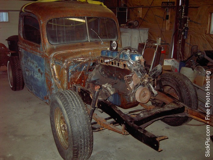

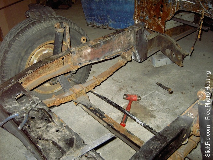

    she's not a dead horse any more, she's a roller.......going with the inline 6, 300, and the '65 toploader 3 speed.....
    in the process of making new frame motor mounts......
    also my new limited slip unit........

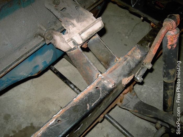

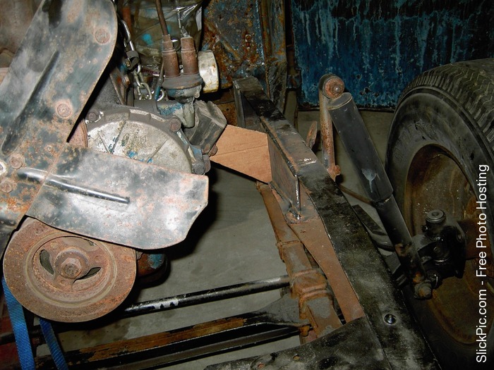

    got the mounts fabricated and motor bolted in........

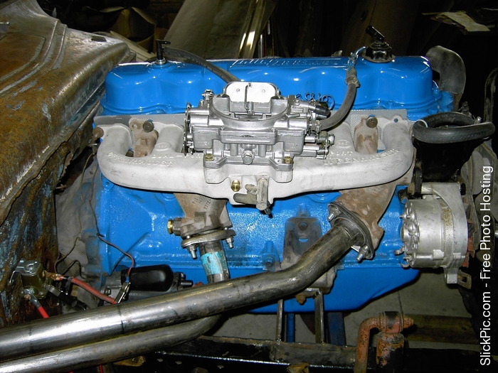

    my buddy and I got her running today.....not quite sure which way the carb should face. Have to do more research on that. She sounds real good. Glass, and rebel wire kit ordered.........Going to run the '37 plymouth grille. I think it fits the build.

    That looks to be the right way to mount the carb, based on what I've been told by 300 guys.
    Your carb and valve cover are up there. What are you going to do as far as hood and/or air cleaner?

    open motor, no hood.....6" air cleaner with way cool topper

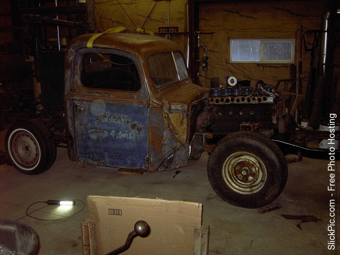

    I can tell your working hard on this build and I applaud your efforts but bro, for real, please rethink the nose proportions. You can change it now, your nor too far down the road. Nobody is doing you any favors by not pointing that out.
    Roll that truck outside and walk around it and visualize the finished project.

    I just read through your whole thread, and am impressed with both your enthusiasm and your ability to handle some fairly harsh criticism that you have been dealt. I hope you can handle some more given with the best of intentions.
    I think it is time to lose the parallel leaf spring front end. The front axle centerline of your truck needs to come fairly seriously forward to balance the shortness of your frame's rear. Basically, what needs to happen is the front axle centerline needs to end up under your radiator/grill shell centerline. It won't be simple fix, but you seem pretty capable of changing on the fly as you work your way though this build, and that is another good trait. A spring over dropped tube or beam axle and radius rods or hairpins would be the best way to go, and this is why you see this sort of front suspension on most hot rods... Pure and simple packaging. This type of set up is available from aftermarket from companies like Speedway starting in the 600.00 range, and could reuse your spindles and disc brakes from the current front axle.
    How I would approach this, would be to first move your engine back closer to the fire wall, and down quite a bit as well. Ideally, it would fit beneath an "imaginary" hood line. Once that was done, I'd pull the front suspension, and make a flat cross member fairly similar to a Model "A" type to span the front rails with just enough room for a fan to radiator clearance of about 1"-1 1/2" then nail it all together. From there cut any excess frame horns forward of the cross member off and discard them.
    It would be a bloody lot of work, but it would improve the proportions of your truck 100%, and is probably closer to what you see in your minds eye for this truck. I am actually a huge fan of this style of truck when done correctly, and what I have suggested will get you damn close.
    I hope you take this as what it is intended, constructive criticism from someone who has been at this stuff for many years, and is an obsessive "mock it up and stare at it" kinda guy before any fab is done.
