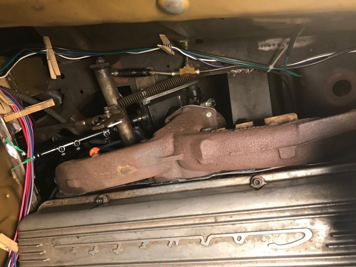

    here is a pic of the Z-bar. I am using 2.5 Corvette Ram manufolds with the Vega box. Z BAR 39.jpg

    One anti chatter rod can be seen on the left in the picture from the chassis to the engine block, to prevent forward/rear movement during clutch operation. Easy to modify a pair of original Ford ones to the Chev. I used some old spring shackles for the rod to block connection.
    The 39 pedal assembly is easy to adapt to a dual chamber Mustang master cylinder, chassis engineering and others make the simple adapter
    For the exhaust manifold to clear the original steering box, a 1968 pick up right hand side manifold
    Dorman 674-199 will work on the left side,

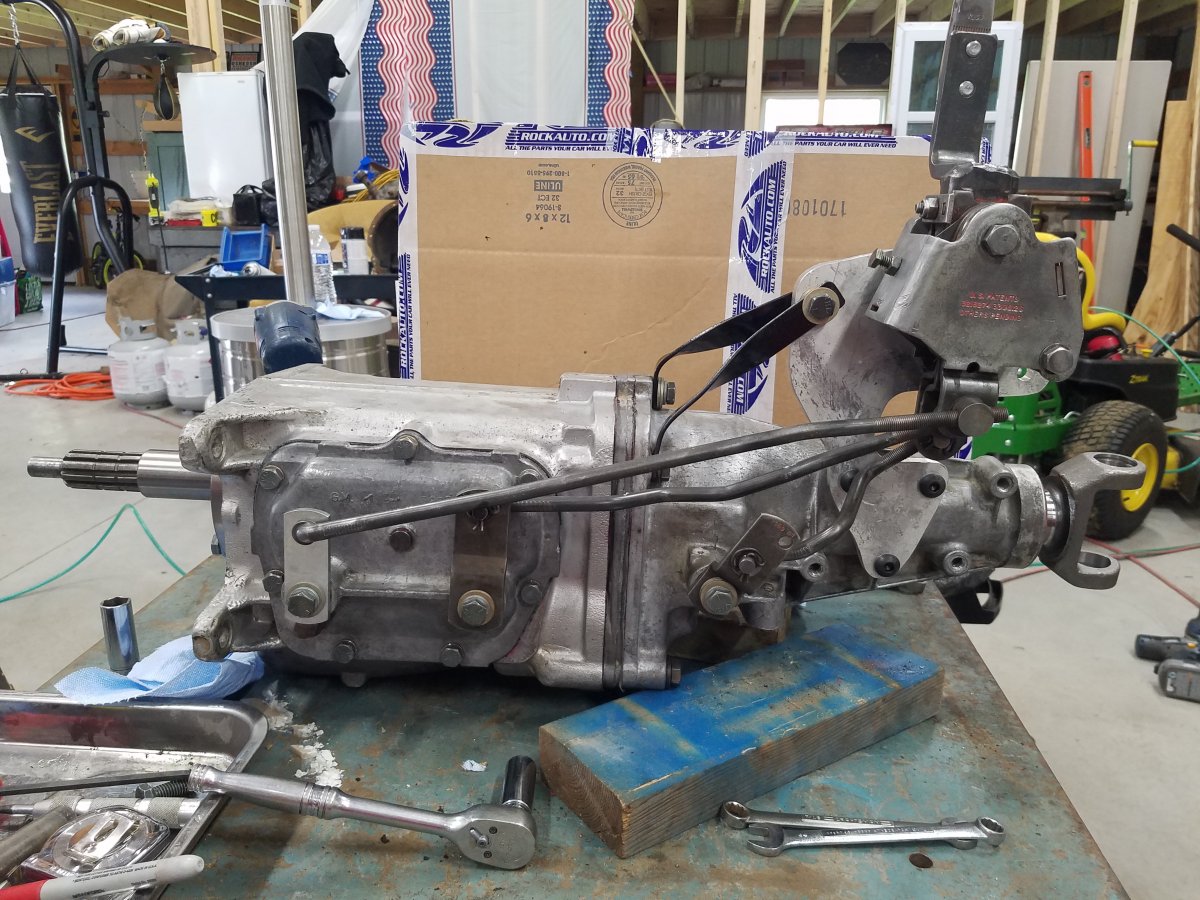

    Update on shifter relocation for the muncie and sbc in the 40 standard.
    I made a plate to relocate the hurst shifter up and to clear the floor and tunnel. I trimmed the tunnel lip on the bottom. The stock rods worked with a little tweaking. Reverse lever had to be flipped so reverse is now next to 2nd gear on the shifter.
    I uesed the offset hurst so the shifter in now centered on the trans.

    I had to heat the bottom of the 4 speed Muncie shifter and reshape it to clear the seat. Got lucky - did not melt the wire for the reverse lock out and dog ears.
