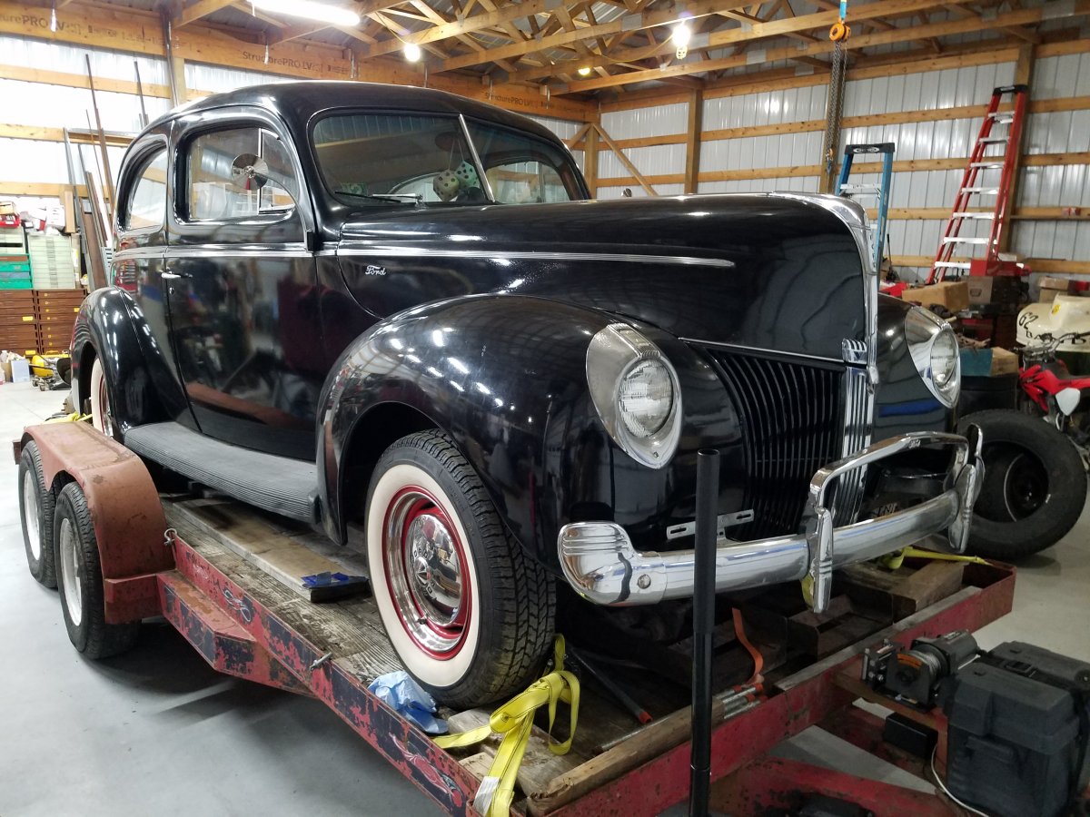

  17. Graybeard4545
    Joined: Feb 13, 2020
    Posts: 67
    Graybeard4545
    from Maryland

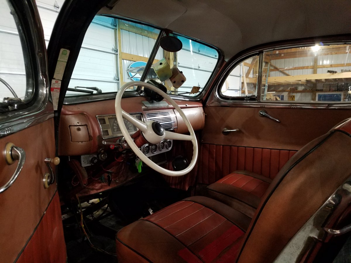

  18. Graybeard4545
    Posts: 67
    Graybeard4545
    from Maryland
  19. Graybeard4545
    Posts: 67
    Graybeard4545
    from Maryland
    j-jock, Gangrene, 32SEDAN and 4 others like this.
  20. pumpman
    Joined: Dec 6, 2010
    Posts: 2,674
    pumpman
    Wow, very nice and will make the engine swap easy. Keep us posted on progress.
    Graybeard4545 likes this.

  23. arkiehotrods
    Joined: Mar 9, 2006
    Posts: 6,292
    arkiehotrods
    That's a beautiful '40 Standard, not a Deluxe. Standard hood and grille, instrument cluster and visor only on driver side, not passenger side. Standards came with a tail light only on driver side, but someone at some point added one to the passenger side. Looking forward to progress photos!
  24. Graybeard4545
    Posts: 67
    Graybeard4545
    from Maryland
    You are correct, thanks for pointing that out. The tail lite on the right is on a bracket that hovers over the fender.
    I was lucky enough to score a very clean rust free complete, minus engine car.
    Thanks

  26. 4dFord/SC
    Joined: Sep 12, 2004
    Posts: 837
    4dFord/SC
    Also, someone added Deluxe headlight buckets; they were body color on the "Standards."
    lothiandon1940 likes this.
  27. Graybeard4545
    Posts: 67
    Graybeard4545
    from Maryland
    Looks like I have a clone. :)
    arkiehotrods likes this.
  28. 4dFord/SC
    Posts: 837
    4dFord/SC
    GMTA:) However, mine's still a flathead, although it's been warmed up a little with a Holley 390, Offenhauser intake and heads, and Fenton headers.

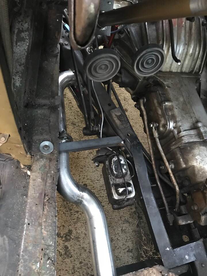

  30. MIKE STEWART
    Joined: Aug 23, 2016
    Posts: 271
    MIKE STEWART
    The front engine mounts will not work well with a late model trans such as Muncie 4 Speed. It will have a 3 point mount system vs 4 point like with a stock transmission. The tail shaft will move some side to side when you press the clutch. I started with Honest Charlie front engine mounts on the 327 in my Dad's 1939 Ford. They orginally were bought for a J-2 371 Olds engine and stock 39 Trans. With the Muncie 4 speed, even with new hardware, the tail shaft will move some when the clutch is pressed. I took out the front engine mounts and welded OEM side mounts to the chassis - problem solved. This car has the Z bar and uncut wishbone. Yes - a chunk of chassis must go for the shifter and linkage. See pic. 39 new clutch.jpg
