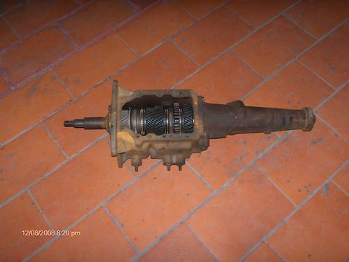

    Hey guys,
    Taken from a 70-72 Falcon (Argentine). Known as "3.25"s
    Real toploader ?
    Would it be a good choice for my 368 Lincoln ?
    Diego

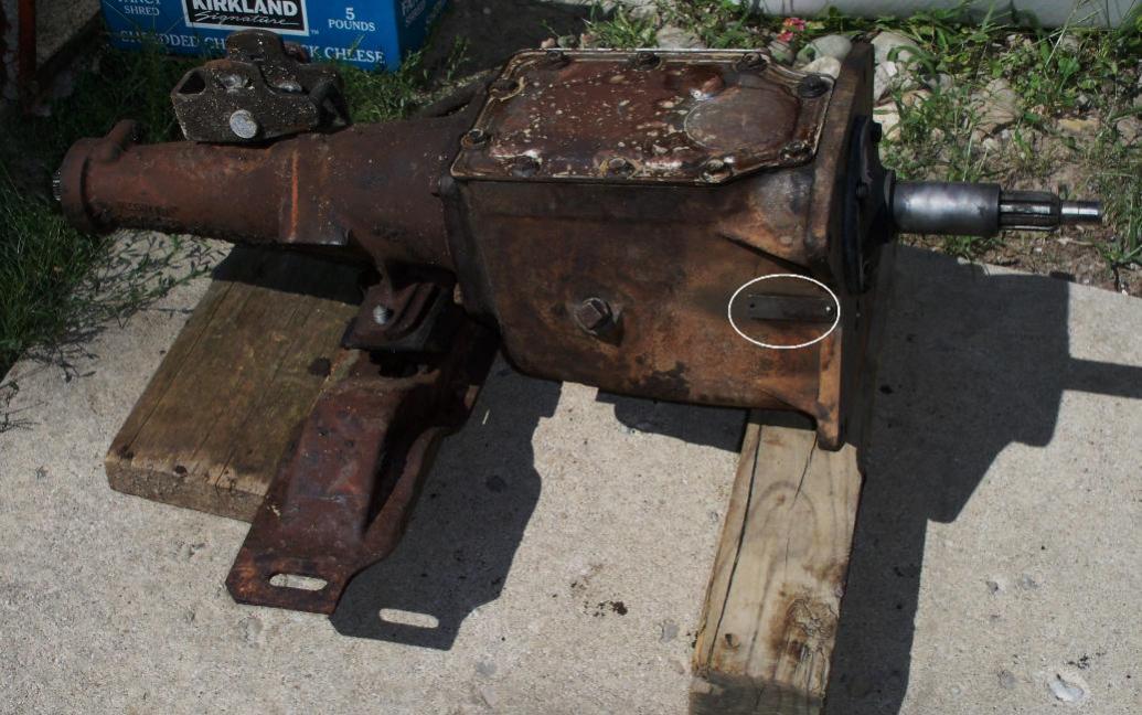

    The Shocker
    There should be an id plate on the passenger side with a "RUG" # or simular.There is a guy in Dallas that rebuilds them and has a page with all the codes , years ,and models .I think its something like David Keys toploader or something.I will try and find the link for you...

  4. I don't know that the 3.25 translates to anything - I couldn't find it. but I have a ford cross reference book but need the ID # off that tag to figure out what it is. As stated before it should have RUG, or HEH and some other #s on it. Sometimes those tags get ripped off even tho' they're riveted on.
  5. Tag circled in white - it should have the ID #s on it for your tranny

    That one you have there may be what David Kee calls a "toploader imposter." Here's a link to his page about these: http://www.davidkeetoploaders.com/imposters.htm These came in late 70's early 80's cars and trucks. They look identical to the real toploaders, but they are supposedly much weaker and 4th gear is actually a overdrive gear.
    I believe the 3.25 you are talking about refers to the 1st gear ratio. I have one of these transmissions myself that I pulled from an '86 F150 300-6 2wd truck, and the ratios are as follows:
    1st - 3.25
    2nd - 1.92
    3rd - 1.00
    4th - 0.78
    R - 3.25
    The main reason why I decided to go with this transmission (even though its not a real toploader) in my project is because unless your pushing gobs of horsepower/torque through these gearboxes, I don't think the weakness issue will be a problem. Behind my stock Ford 292, this thing should live up just fine. Remember, they originally came installed in trucks which hauled and towed stuff all day long.
    This transmission, coupled with a Ford 9" rear end w/ 3.00 gears I bought, should give me great highway mileage...
    I have a lot more information about toploaders of all kinds if you have questions.
  7. Yeah, I remember them trannys. didn't they share a few pieces with the real 4speeds too, like the front/rear bearings & gaskets/seals etc? Also didn't ford put them in Granadas & Monarchs for a few years or were they different? I remember the early ones ('77 or so) had lots of problems but the got better by the mid 80s.

    If its a real toploader ,it will have 8 holes were it bolts to the bell housing .If its a fake it will have a hump in the side of the case on the passenger side ( im told it had the hump to clear the larger 4th gear in the overdrive ) .A real toploader wont have the hump .

    thats a 3 speed overdrive by looking at the shifter there not real strong but work good for a crusier due to the overdrive

    As far as I can see the trans in the opening post only has two shifter arms. Wouldn't that make it a 3 spd?

    Your absolutly right, 2 arms 3 speed. His original picture showed a transmission with a shifter and a 10 bolt cover, which is a four speed. Now his pictures show a trans with no shifter and a 9 bolt cover which is a three speed. Diego, are playing with us, or did you goof up downloading the pictures?

    I found three trannys which I could buy
    1) I called the first guy and indeed that was a 77' OD 3 speed
    2) You are right, the one on top is a 3 speed. I realized late last night. The jerk has an ad selling it as 4 speed.
    Take a look at the picture at middle of the post. I think thats a real toploader. And I already offered for it on ML (local ebay).
