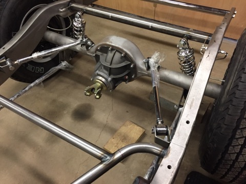

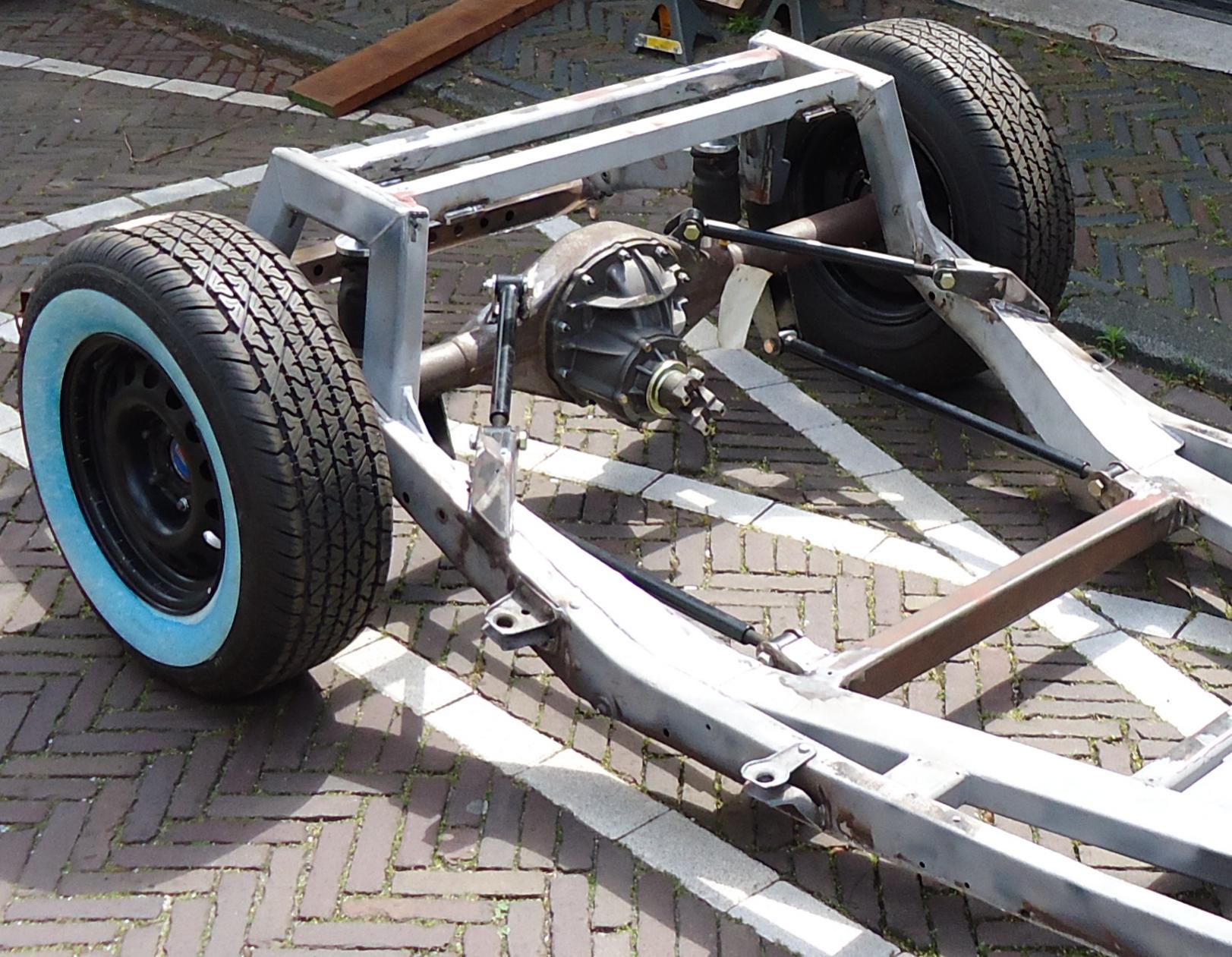

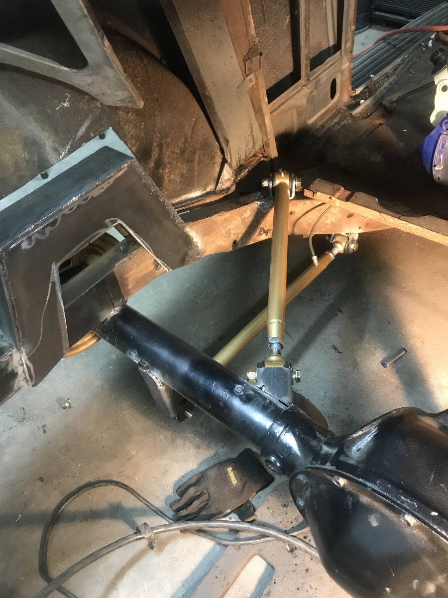

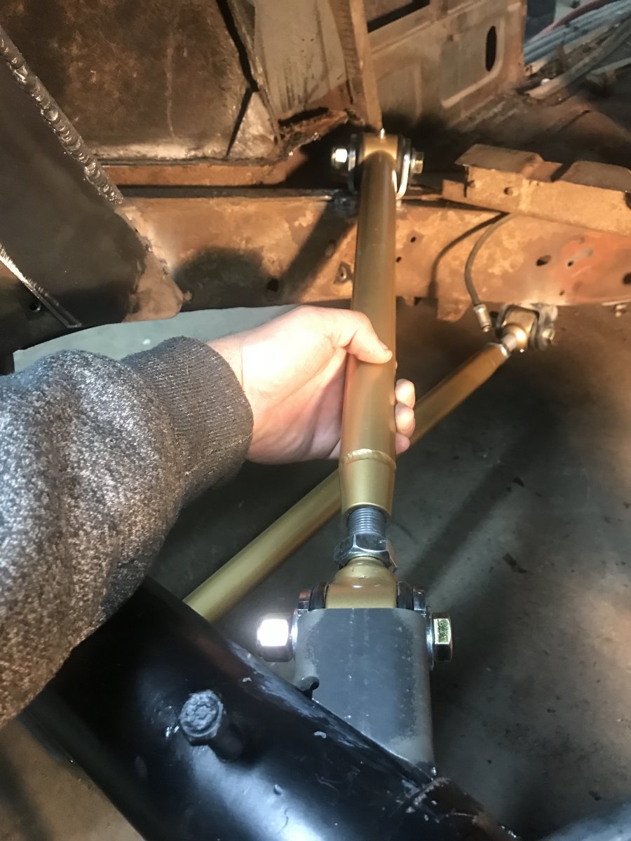

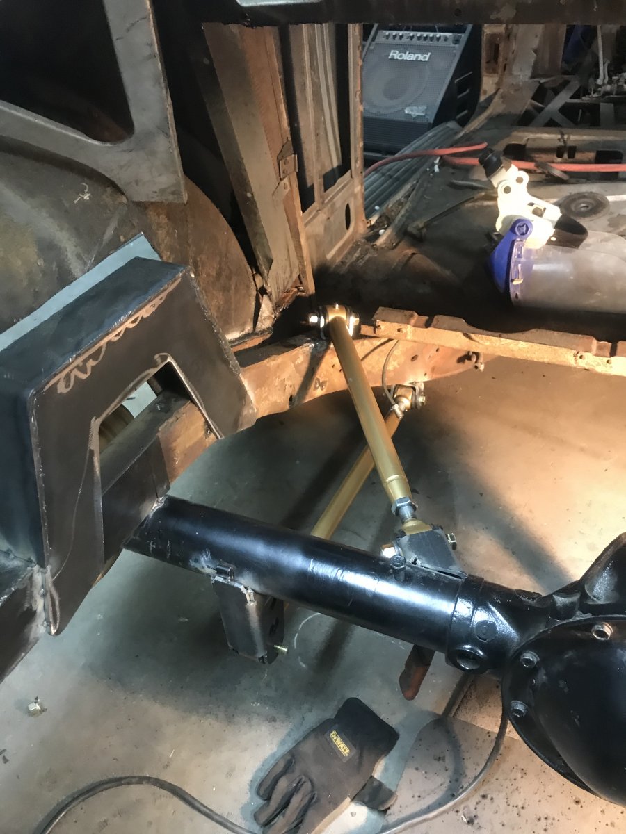

    E5F98805-FCBF-4DE2-9BE0-0AE98C8473C5.jpeg 1CC3609D-415A-47C8-A261-D4A1E855D4D1.jpeg D614F543-FF2C-4F33-B09D-4410093A6DA9.jpeg Sorry for revivig this old post; im installing a triangulated 4 link on my 40 Desoto Coupe and was wondering if these specs would be considered too extreme.
    At ride height, rear to front, Bottom bars are 1 degree down and upper bars are 5 degrees up.
    Any input is greatly appreciated.

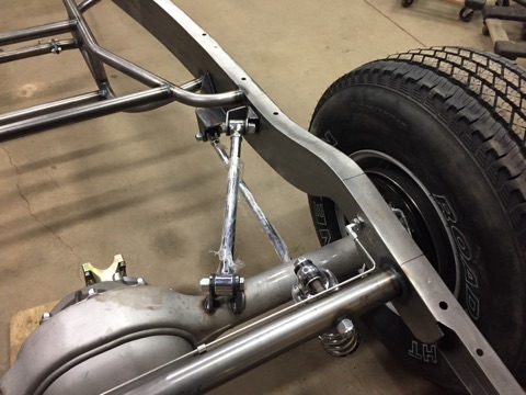

    This is a professionally built frame, if you are interested I can measure all the angles and lengths tomorrow. It's a '32 frame. Notice they don't go to the top of the center section, it helps with floor clearance.
    SPark
    40desoto likes this.

    You really should move your lower bars off of the X, and on to the frame rails.

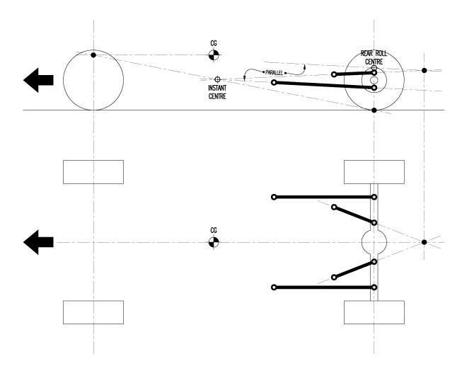

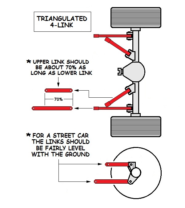

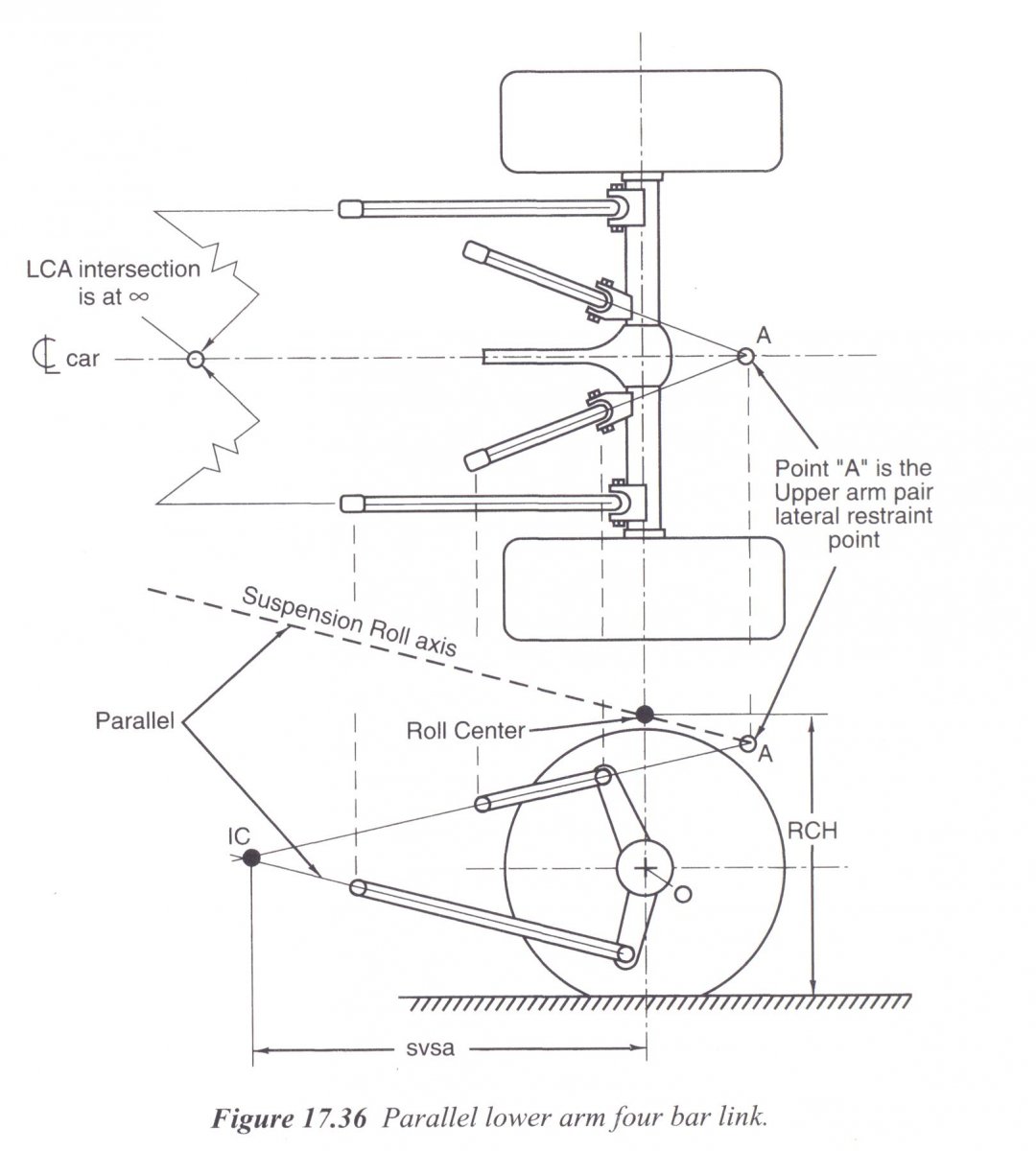

    As an example, here are measurements for a 32 frame but yours would differ. Remember to ensure axle is centred in frame and your wheelbase is correct and the axle isn't biased to the front of rear or to one side more than the other.
    Also make sure you pinion angle is correct. Measure twice, cut once. Once welded up it's too late. I already see that it was tack welded.

    The lower bars only have compression loads from pinion torque reaction in his build. [and tension loads during braking ]
    The triangulated bars are mounted directly in front of the axle and are subjected to compression loads due the axle thrust [every ft/lb of torque at the tyre footprint equals the same amount of thrust at the axle centreline]
    These thrust loads are better off being controlled by arms closer to the wheels to prevent the wheels trying to toe-in [bending the axle tubes, or torque steer]
    3rd gen F bodies have these arms out wide for that reason.
    Axle thrust loads are always greater than pinion torque loads due to mechanical gearing.

    Thank you LM14. Unfortunately my frame has an X crossmember, if thats the correct term., in the middle therefore Im unable to attach the lower bar bracket to the frame as in the pictures you provided.
