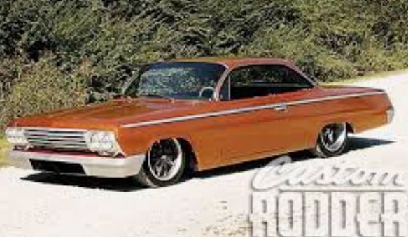

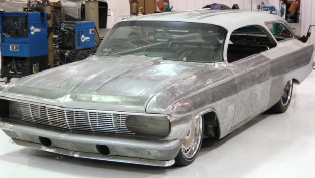

  23. anthony myrick
    Joined: Sep 4, 2009
    Posts: 6,761
    anthony myrick
    Probably left several out.
    Just trying to give the guy a general idea.
    I have seen several 4 door conversions turn out well.
    The amount of work is huge.
    This one began life as a 4 door
    Here is something similar.
