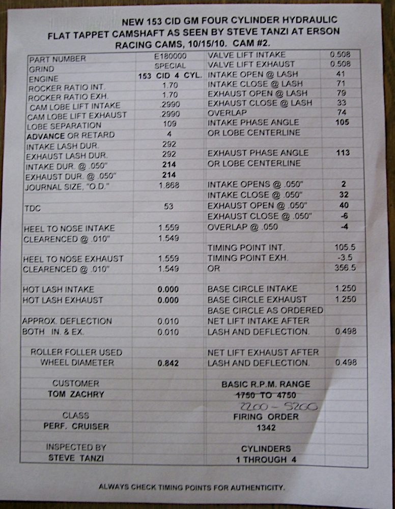

    Here are 3 cam profiles that Erson worked out for me several years ago. # 1 is the mildest and # 3 is the one I got. Probably #1 is the best street cam. Note that these are based on a 1.70 rocker ratio instead of the stock 1.75. I'm using big block roller rockers because I had some. I don't know how much difference the 0.05 would make.

    2.85x1.75=490 lift

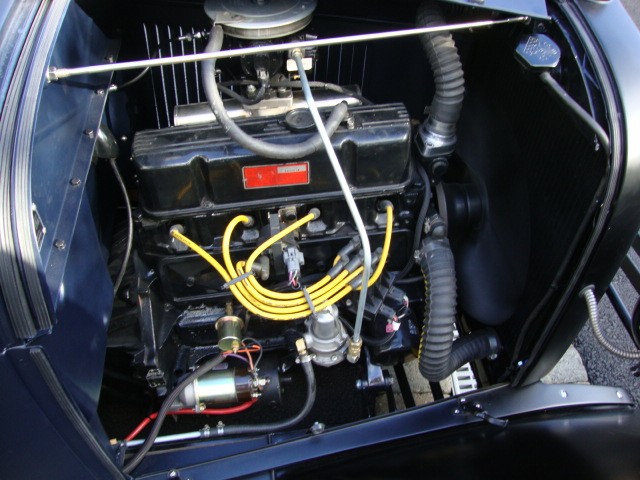

    This question may have been asked/answered before, but my 153/181head OMC engine does not have a vibration damper on the crank. Is this common on boats? and what should one do for a street car, if anything? 20160919_105927_resized_1.jpg 20160919_105940_resized_1.jpg 20160919_110003_resized_1.jpg 20160919_110018_resized_1.jpg 20160919_110522_resized_1.jpg
  9. Six Ball
    Joined: Oct 8, 2007
    Posts: 3,908
    Six Ball
    from Nevada
    The 153 had no dampener on the crank when a Chevy II, not sure about boat engines. The 181 has a dampener like a small block or six.

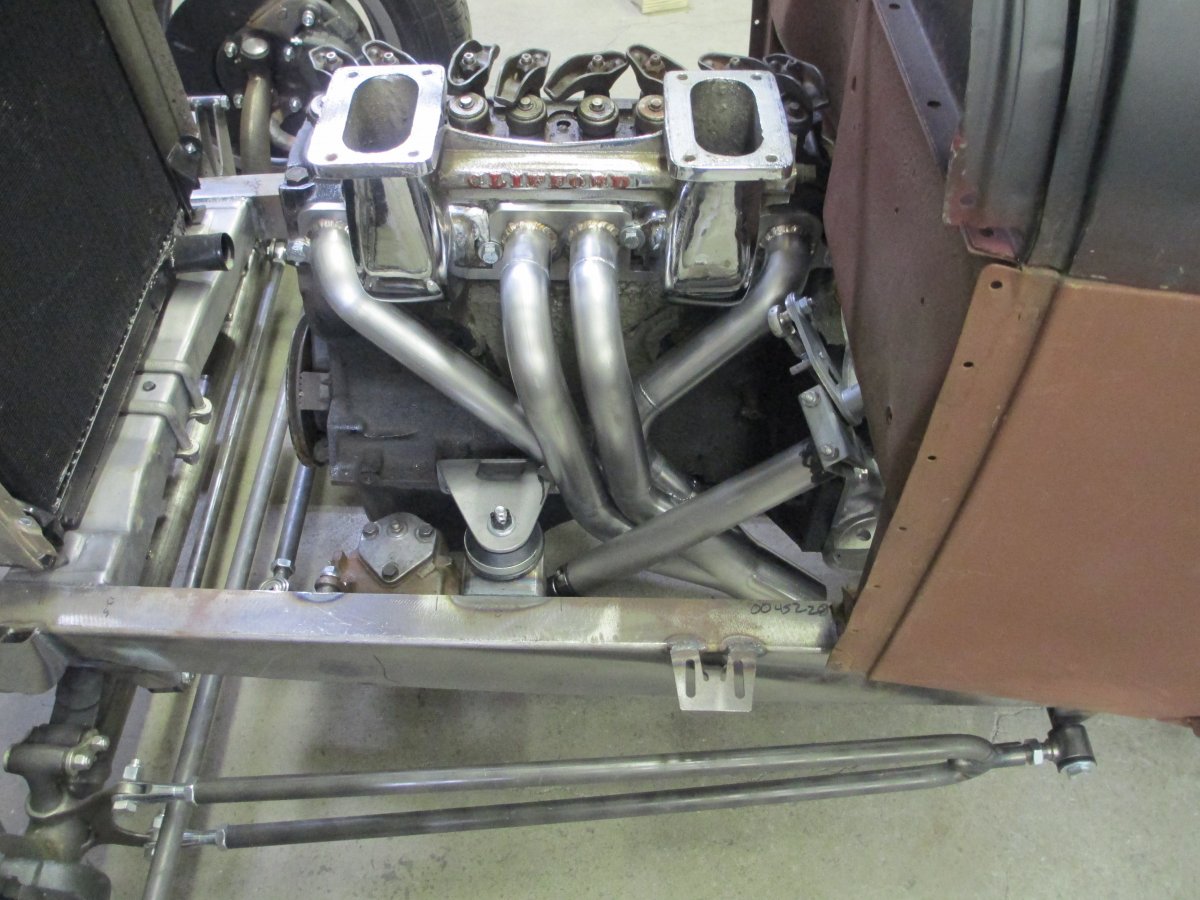

    IMG_2494.JPG IMG_2430.JPG I stumbled on this thread and thought I would post this 28 Ford Roadster I have. The project started in the early 70s in Portland Oregon and has never been completed. The chassis was built by Russ Meeks (RM Engineering) Unique for that era were midget style front and rear disks and rack; modified 4-bar front and rear; Spax coil overs and Borrani knock off wheels. It has a 120HP Mercruiser motor.
    Six Ball likes this.
