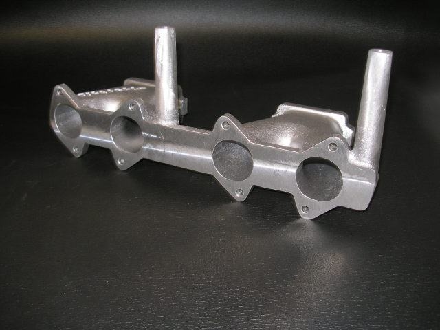

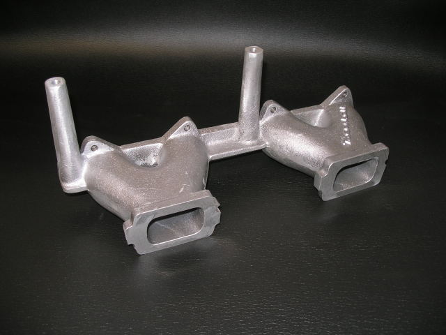

    CNC Dude, what have you done with these products?
  11. CNC-Dude
    Joined: Nov 23, 2007
    Posts: 798
    CNC-Dude
    I also have been working on completing some more universally friendly OEM style head configuration intake manifold patterns for the 153(Chevy II 4 cylinder) and the 194-292 Chevy 6 cylinder engines. I'm having to do a complete make over on the 12 Port head patterns for the 6 cylinder, but I have started more needed(requested) intake manifold patterns for the 153 and 194-292 engines as well. There is also a 4 cylinder head in the works too. Thanks for your interest!

    CNC-Dude, have you had any luck casting any parts?
  17. CNC-Dude
    Posts: 798
    CNC-Dude
    724wd, are you referring to the Mercruiser style engine this thread is regarding, I hate to go off topic but, I most recently got my new true EFI intake finished and cast for the Chevy 250/292 engines. But I would like to do some Mercruiser stuff, these are awesome engines and have huge potential. So if anyone has some ideas on what they would like to have for them, let's start a list.

    I have a finned side cover already 3D modeled and am ready to make the pattern for that. The problem with a crossflow head is the ports will not be siamesed like your Clifford intake, so a crossflow intake will also have to be made to fit this new port layout.

    Most of that stuff has ended up being a case of Joe cleaning out his garage and getting rid of things that were needing a complete redo. The head patterns for instance ended having cores mismatched from previous head patterns he had years earlier or cores missing completely. So I am gradually moving towards more and more complex patternmaking projects with my intakes and then move toward a completely new updated head pattern. I think i'll start with a 4 cylinder version first.
