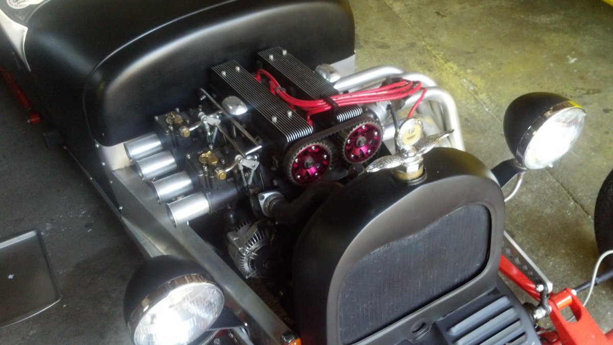

  12. stude54ht
    Joined: Dec 30, 2007
    Posts: 548
    stude54ht
    from Spokane WA
    This is a Toyota 4A-ge in my 26 roadster
