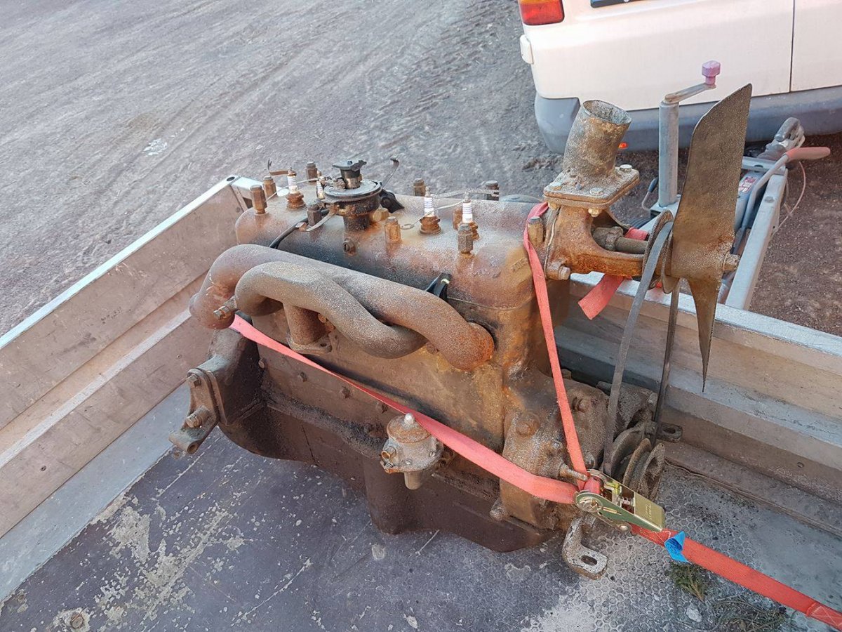

    Have just bought an old Model B engine. I do not now anything about how to build this engine. I'm going to build this engine with tips and help from everybody about how to do.
    I want the this engine to work well on road and track.
    This is not one of those super expencive engine builds, but we'll see how that ends :eek:) .
    I hope I can get help from start to finish. Going to ask for one and one thing. This is not a quick build.
    Hope others can read what comes of proposals, and make their own decisions out of this.
    I will have a Facebook side at the same time for the build.

    I guess the first thing I have to do is to take it appart .
    Then i have to figure out what I want it to be in the end.
    If anyone have a setup that is a killer for a Model B engine.. speak out ;o)

    Full teardown, engine runs and is ok. Want to build a solid runner+.
