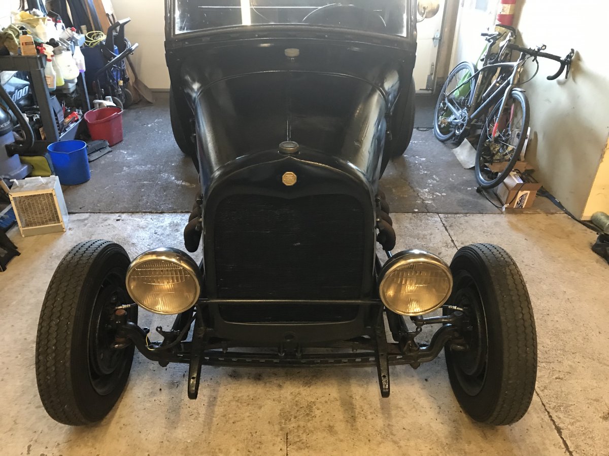

    CEDAEADB-7D19-4C32-9C76-C7A5B36F36A9.jpeg 22EC11AC-3C0D-4D2E-BBD7-5154A829B655.jpeg D8DAC13E-6B94-4389-BA91-66DA75878F30.jpeg 30C881EE-299E-4A9A-97F3-2A552344FDAF.jpeg More updates! Painted the hood and added an old ford wheel cap as a grill emblem i had lying around.
    Starting to take shape:)

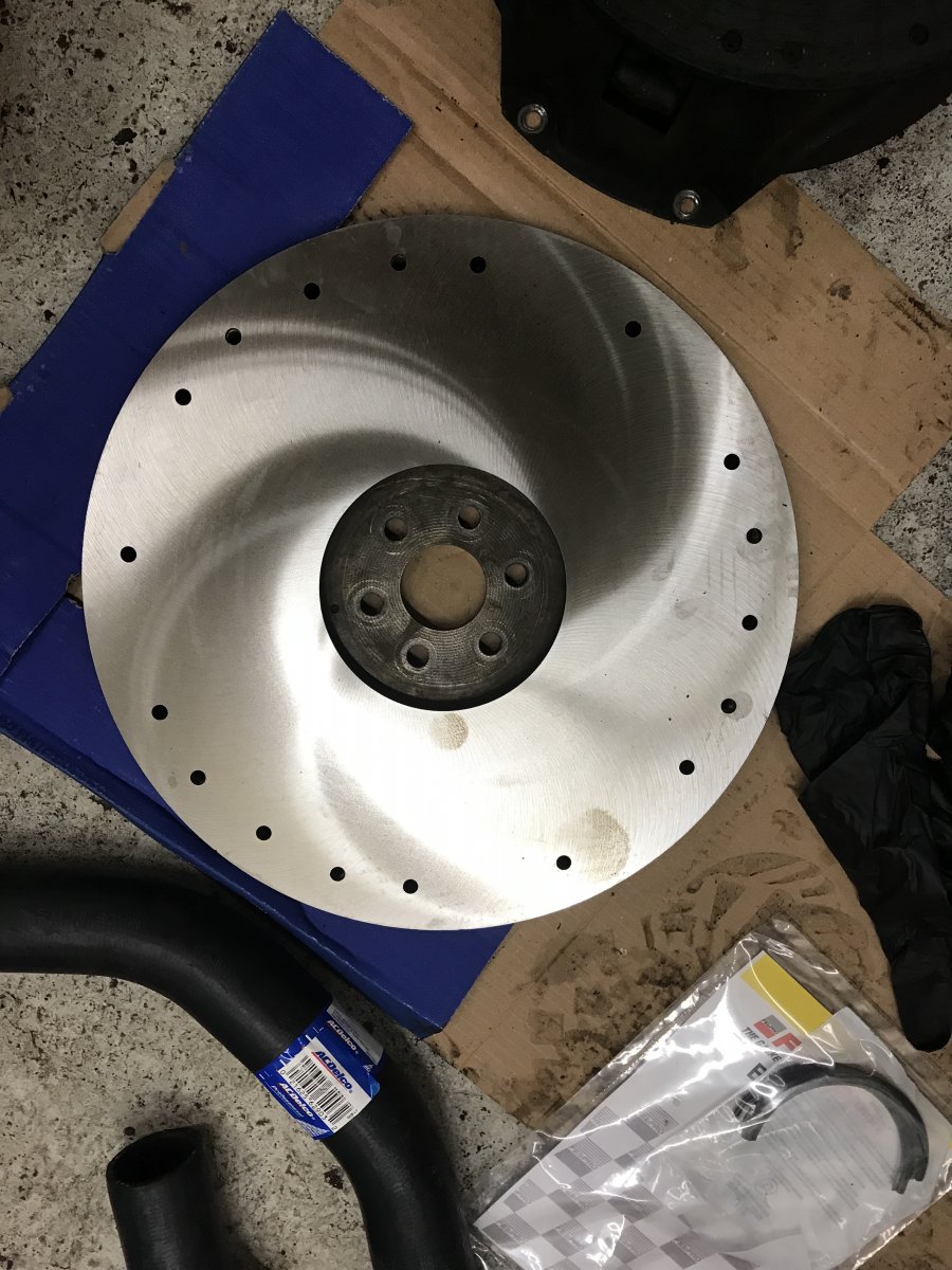

    Then it escalated quickly...which turned into ordering a new clutch, surface flywheel, new ring gear, thermostat and housing gakset, rear main seal, pan seal, basically resealing everything.
    Also fan belt was too long wearing a groove in the lower rad hose so got a shorter fan belt, more of a bend on the hose (will post pics when its back together) 3EFF5D5E-1DFD-4861-9864-E47C05485163.jpeg 46E25DA9-003C-4A2E-A36B-4A97340E4857.jpeg 78783B22-C1B9-4C61-A162-8F8E282DAF1D.jpeg D70AFD88-656F-4469-B747-63E429EF33E7.jpeg 18678BB2-2460-456D-AA80-C3989B9D7862.jpeg 5027E1FE-0CF9-4613-8578-779649414CB4.jpeg D83F7D6D-6250-404F-8A1C-A23585F9DADA.jpeg 71A2E5FC-8ABC-4C9B-BCEA-5373795F82F0.jpeg 10169724-7070-484D-B384-86A56BC800E7.jpeg
    Also a shot of the old clutch up there, should last the season hopefully after all this

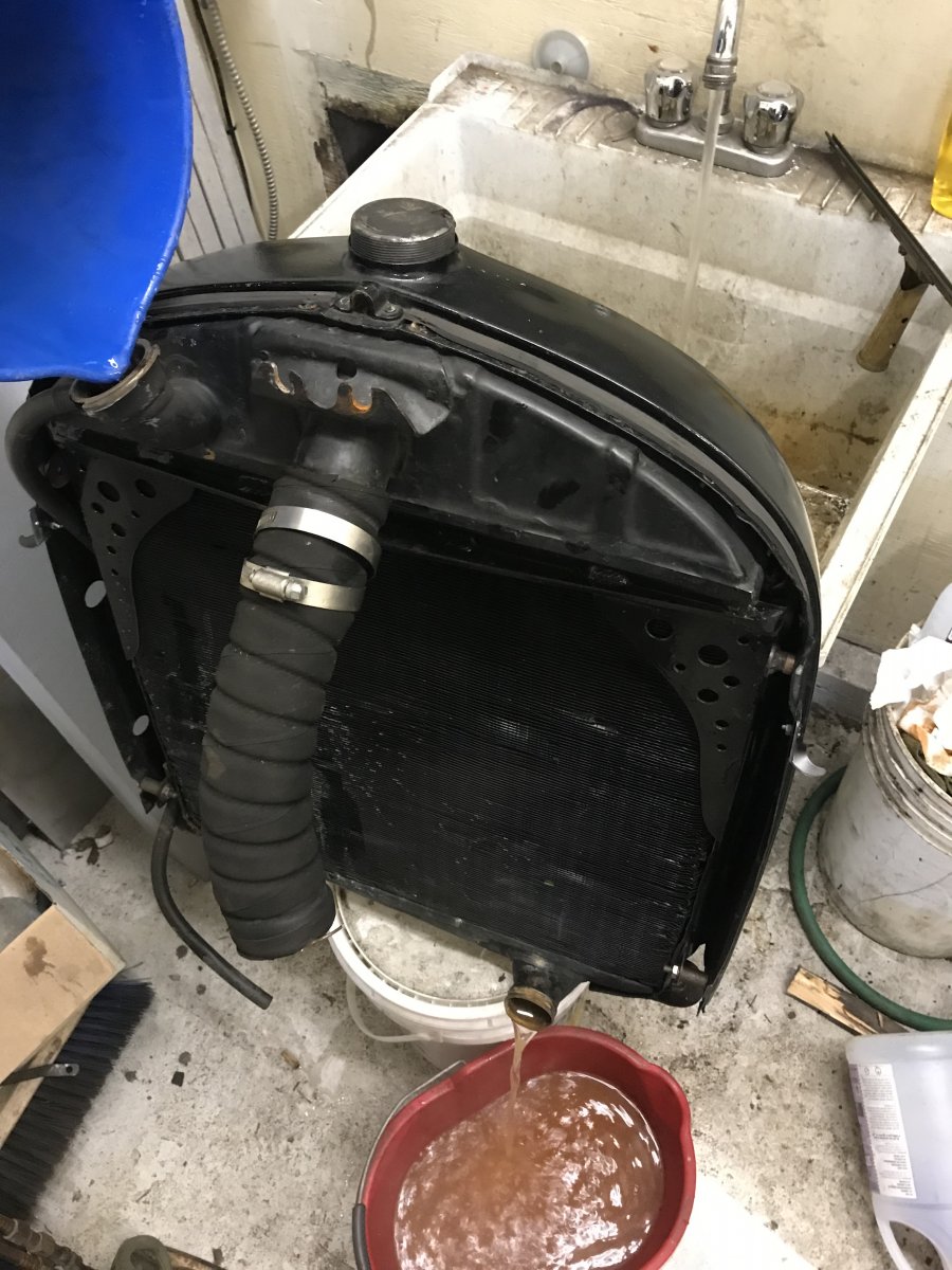

    D1EAF507-E5F4-46A5-9B9A-4813B4E0E72E.jpeg Also winter rad flush (indoors as its freezing outside) for good measure, the inside of rad and block was caked in crud, including the block drain being plugged solid.
