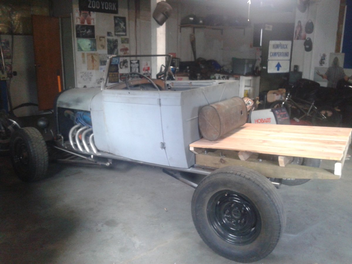

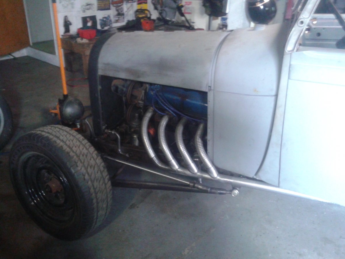

    Everyone has a scrap pile, I think we can agree on that. I'm currently building a car that consisted of me digging through scrap to build a body,which left me with a scrap pile of my own . A friend went digging through that and is Putting this together.
    He usually builds motorbikes, but decided to have a go with a car. I think his total build is under 500$ at this point (thats like 63$ american). I am stuck at home with the flu, and figured this is a good a way as any to spend some time.
    Lets see how long it takes him to find his own build thread, since he lurks here often....

    That's a man I can get along with, someone who takes cast offs and makes something really nice out of them.

    i like it so far. Nothing wrong with starting with someone else's scrap to build a car

    a lot better parts than in my scrap pile

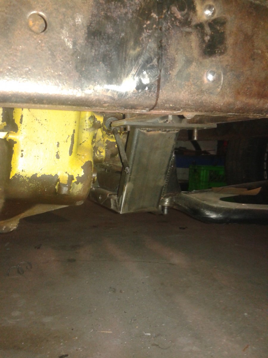

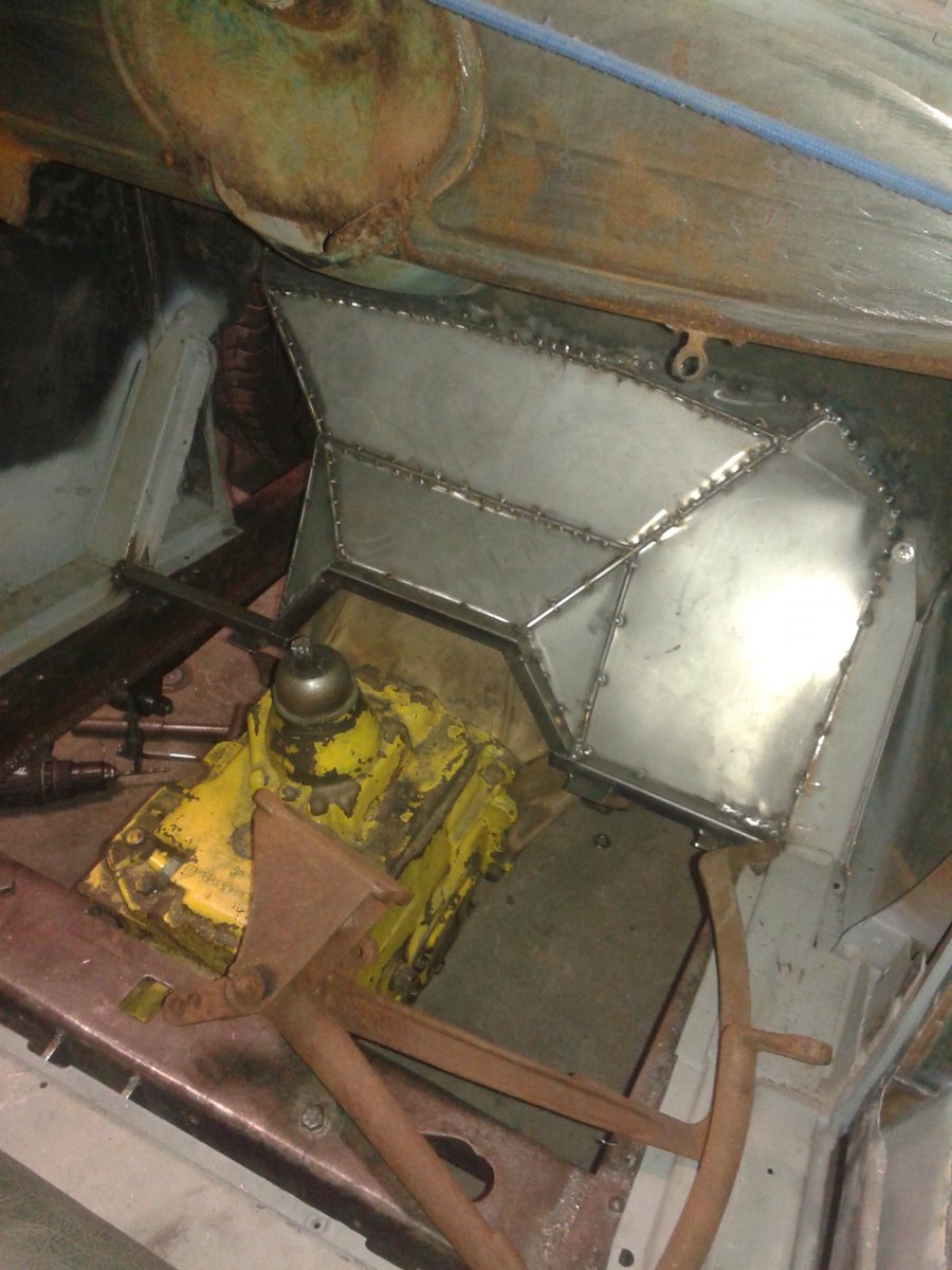

  10. Pretty neat roadster pick-up construction. Know it's a truck; but kinda wonder how that trans is gonna work out.

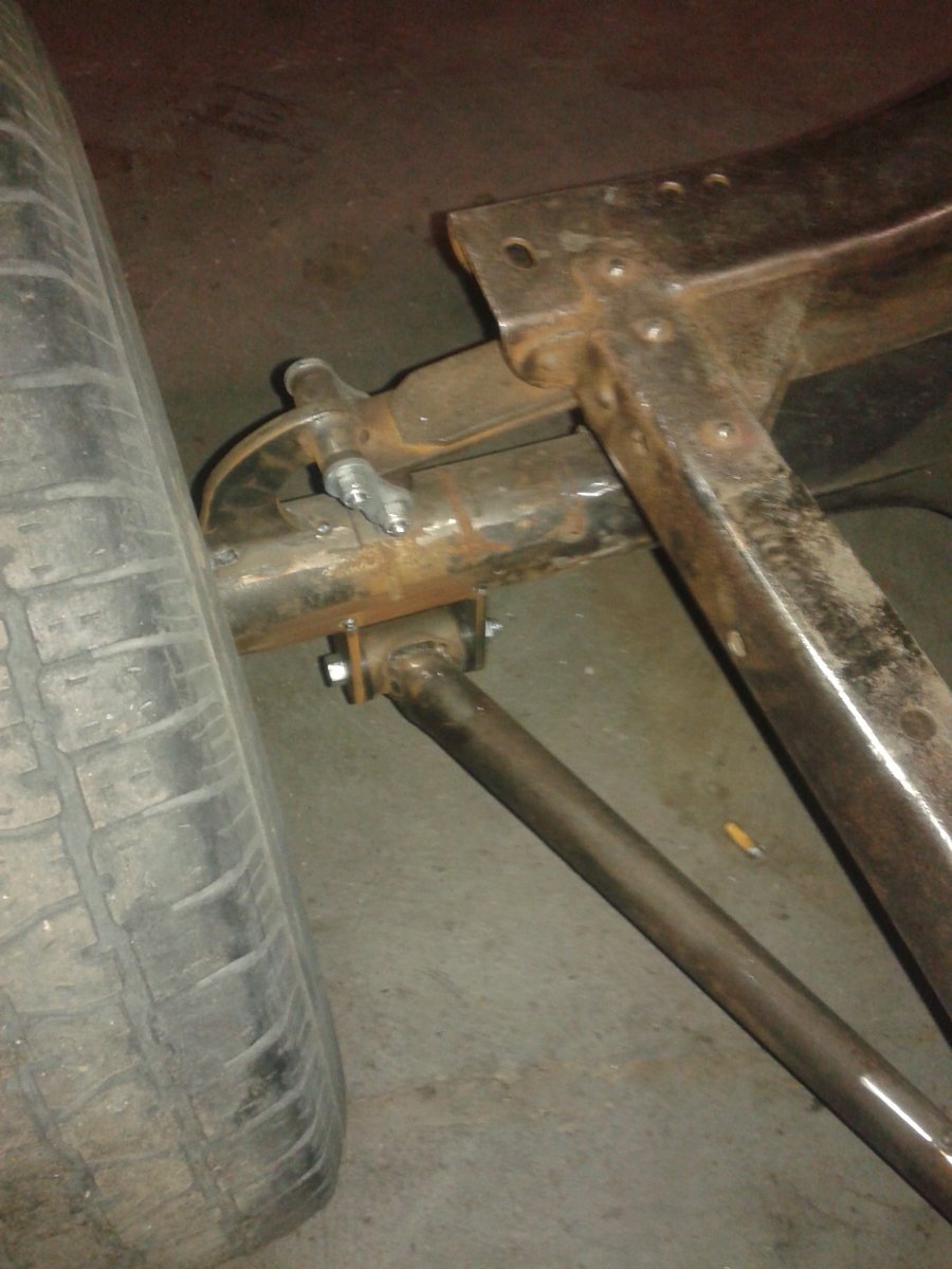

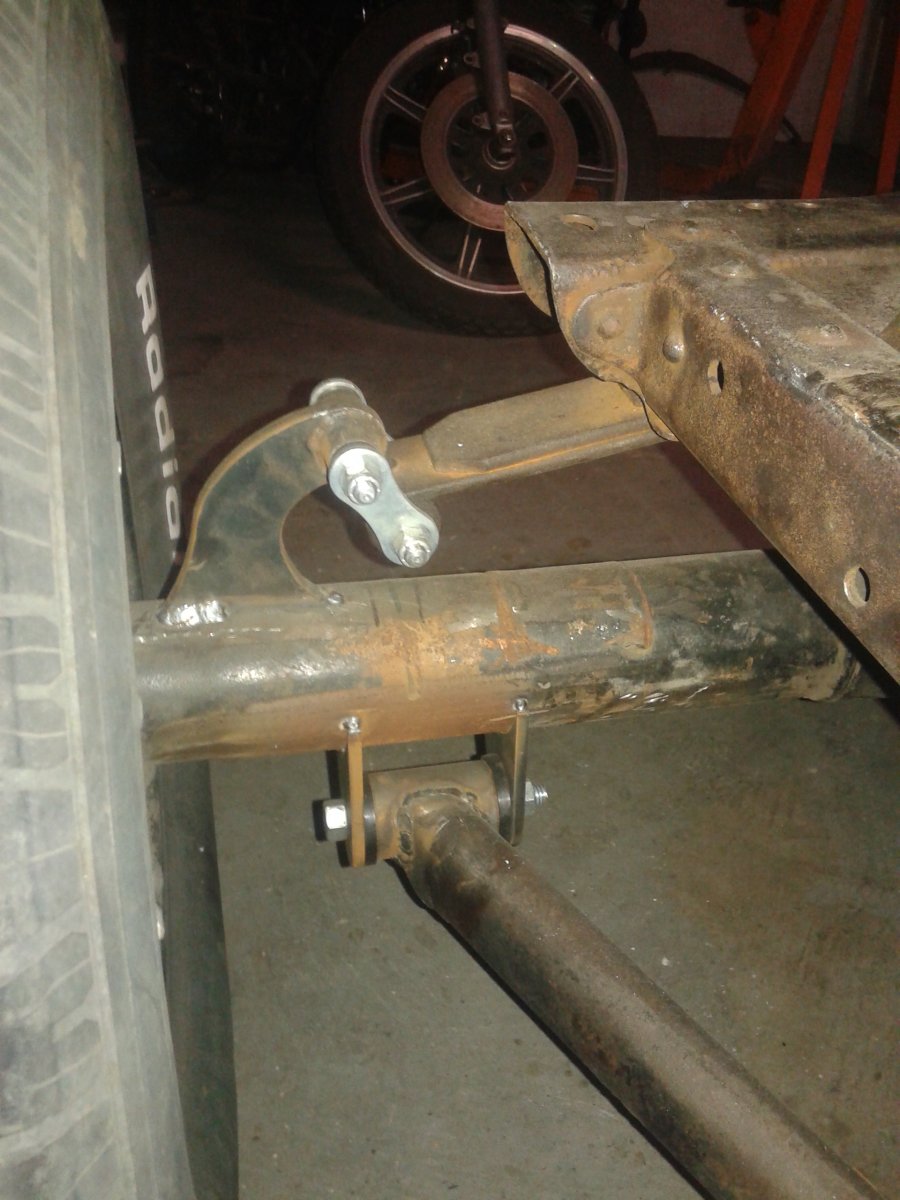

    What were the brackets that were made into the windshield posts?

    Guess he still hasn't found it, the body consists of 3 sedan/coupe doors (that were missing the bottom 6")and a very rough 28/29 closed car cowl. The rear perimeter of the body is actually pieces of door window frame that were cut off by some one else. Since he used A pillars as B, he mounted the doors suicide on the stock hinges.
    the windshield stanchions are Harley soft tail rear frame pieces that were cut off a project bike years ago.
    I find the whole thing pretty interesting (enough so that I made him a build thread)

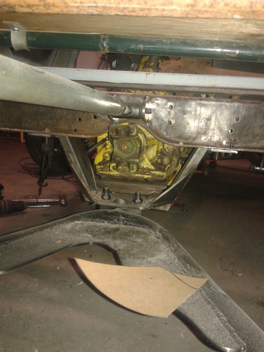

  27. $63 USD bought all that?! I've been getting ripped off for years!!! Seriously, what transmission is that, though? Is that one of the 4-speed top shifts Ford had in trucks in the '80s?

    its a massive cased granny low 60's truck 4 speed, I keep telling him to put a pto on the side of it and at least run an air raid siren.
