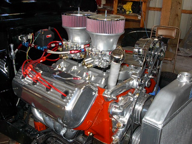

    No studs anywhere on the valve covers or the headers. Just bolts. Looks like they've been leaking a long time. Freeze plugs leak too- nearly every one of them. They have a bolt in the middle of them. Tricks to sealing them up too?
    This motor sat a very long time after build. Can't have more than 1200 miles on it. Just leaks like a sieve everywhere!
    Griffin X flow radiator installed low- a lot lower than the water neck on cross over. Hose has a fill in line & I'm sure the cap is junk. Pukes water out overflow hose (no catch can) too.
    This motor is in that chopped 41 Willys I posted about in another thread. I picked this car up for the right price.
    New aluminum heads are on my short list. These are cast iron.

    Oh and BTW- who's the dumb fuck who though to stick the oil fill in the rear of the finned valley cover instead of the front? It's under my 871 BDS blower! Lots of access in front.
    I believe the manifold & cover are Hot Heads.
    Another item for the short list.[/QUOTE]
    I hear ya on that Steve... I use a set Of Donovan water fills on each side of the Valve cover(If you have room)...and use them to oil fill.
    Just a suggestion.

    I hear you on the rear oil fill. I have that valley cover my self and I welded a fill tube to the front with a breather and used the rear fill cover for a pcv valve port. I don't know if this would work for you with the blower but here is a pic of where I added the fill tube to the front of mine.
  26. George

    Good idea but won't work for me. It would hit front of blower & snout.
    Just an O-ringed cap in front would be perfect.
    Just a suggestion.[/QUOTE]
    I have plenty of room for one of those!!!!
    Link?

    Something like this.
