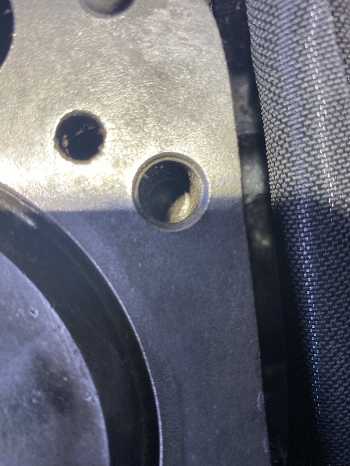

    Tried to get a pick. The bottom of the hole has a nice score, like the bolt was bottomed out and a torque was put on it, causing the gouge.

    Certainly looks like touchdown to me.

    Did you check the length of the head bolts?
    Also, have a look to see that they have a small shoulder just under the head, of about 3/8".
    Just making sure that these are Hemi head bolts, and not just any old grade-8 bolts.
    I have seen some odd stuff on, and in engines.

    Yeah and it’s fresh, so not like an old scar. The rest of the old is all dirty and what not...

    Bolt length is correct and they have the shoulder.

  6. [QUOTE Yeah and it’s fresh, so not like an old scar. [/QUOTE]
    I have to agree with that.

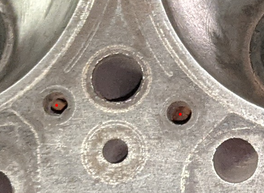

    If you have a micrometer compare the thickness of the fire ring on both head gaskets. I agree in the one pic that it doesn’t look like it was touched.

    A common resurfacing of a block or heads removes 0.010".
    Your fire ring compression differs by 0.002". I am not sure that is enough to do this, but frankly, I have never explored this as a failure path. I could only speculate, and I do suppose that this could allow combustion gasses by, to a near cooling passage.
    There are two small ones that are somewhat closer than others.
    Explore the crack situation. If there are none, put washers on the head bolts and try again.

    I looked at all of the gaskets that I have, Dodge-DeSoto and Chrysler, and all have a hole, however, each different gasket has a different sized hole that I presume is for the purpose of metering water flow. Real hard to know exactly what the gasket manufacturers are thinking.
    IMO, Chrysler wanted some water moving at that point or the head would not have a hole so the question is only that of quantity.

    I would not be able to explain why Chrysler would bother to machine holes in blocks and heads, if they were not needed. Time and tool wear are a thing.
    I mostly deal with 354's, as they seem to show up more often than others where I am. On all of the "never-apart" ones that I have opened, the factory installed gaskets had tin rings around all cooling passages, and all cooling passages were utilized. None were blocked.
    I have three pair of 354 heads on or next to the bench right now. All six of them have evidence of a gasket halo around every single passage.
