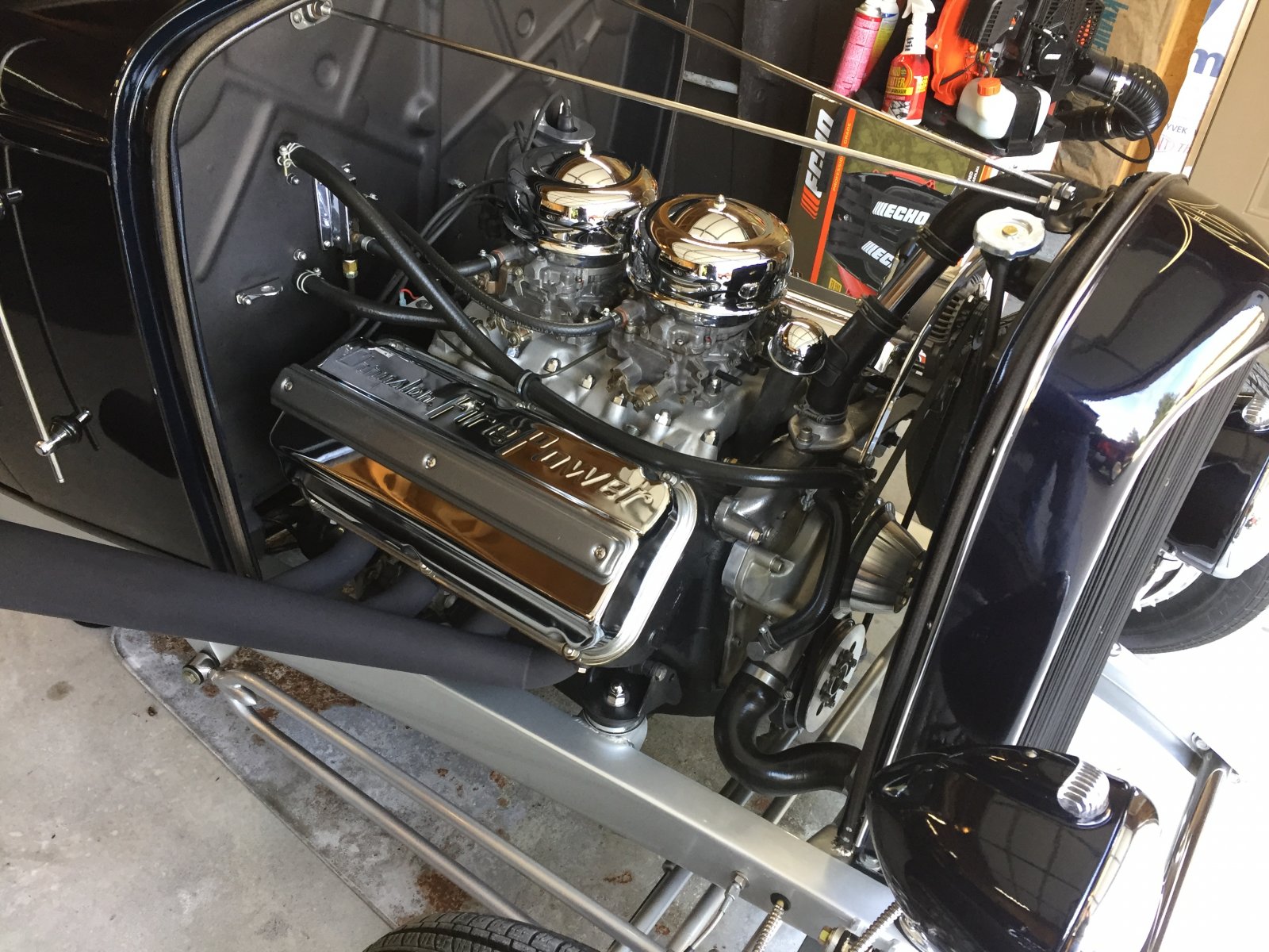

    IMG_0228.JPG This is how I have my bypass run, 185 degree thermostat 14# cap.
    Good luck, KK

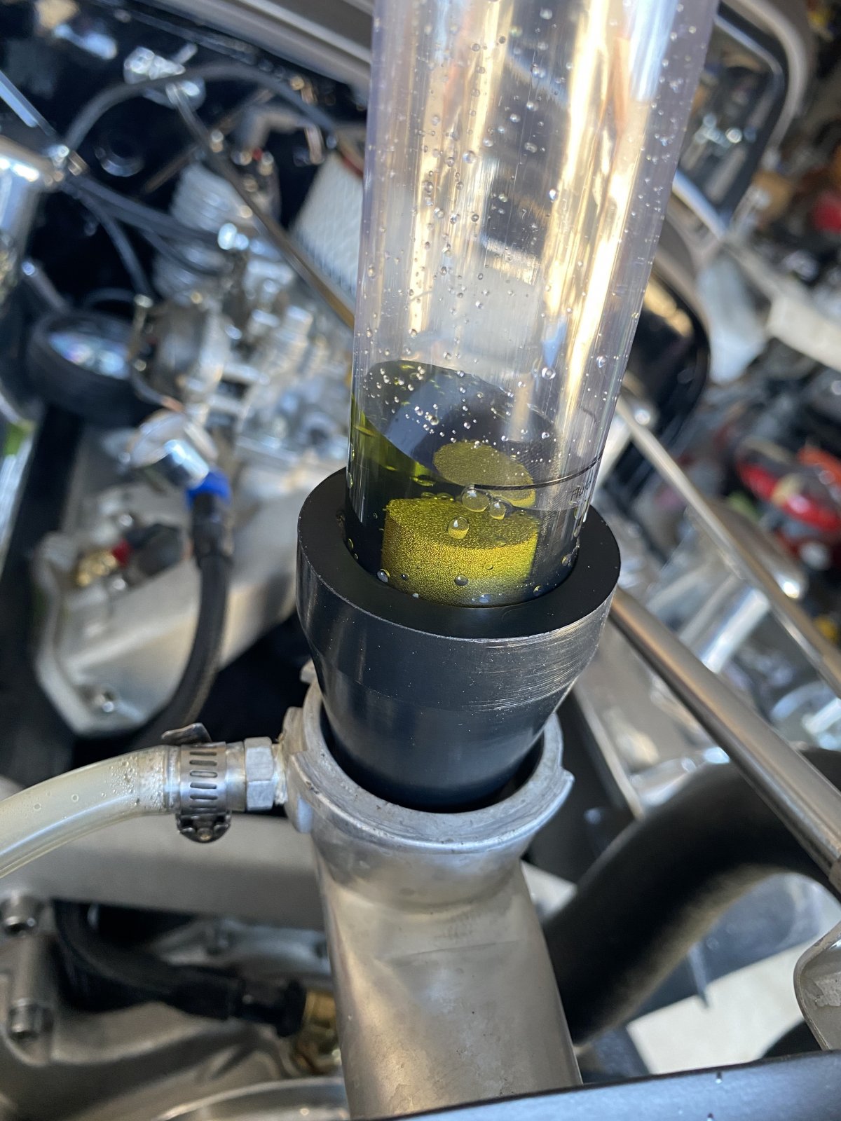

    Well there it is.... radiator test confirmed I have combustion gas in cooling system. Blue liquid to yellow damn quick....
    GordonC, ottoman and gimpyshotrods like this.
