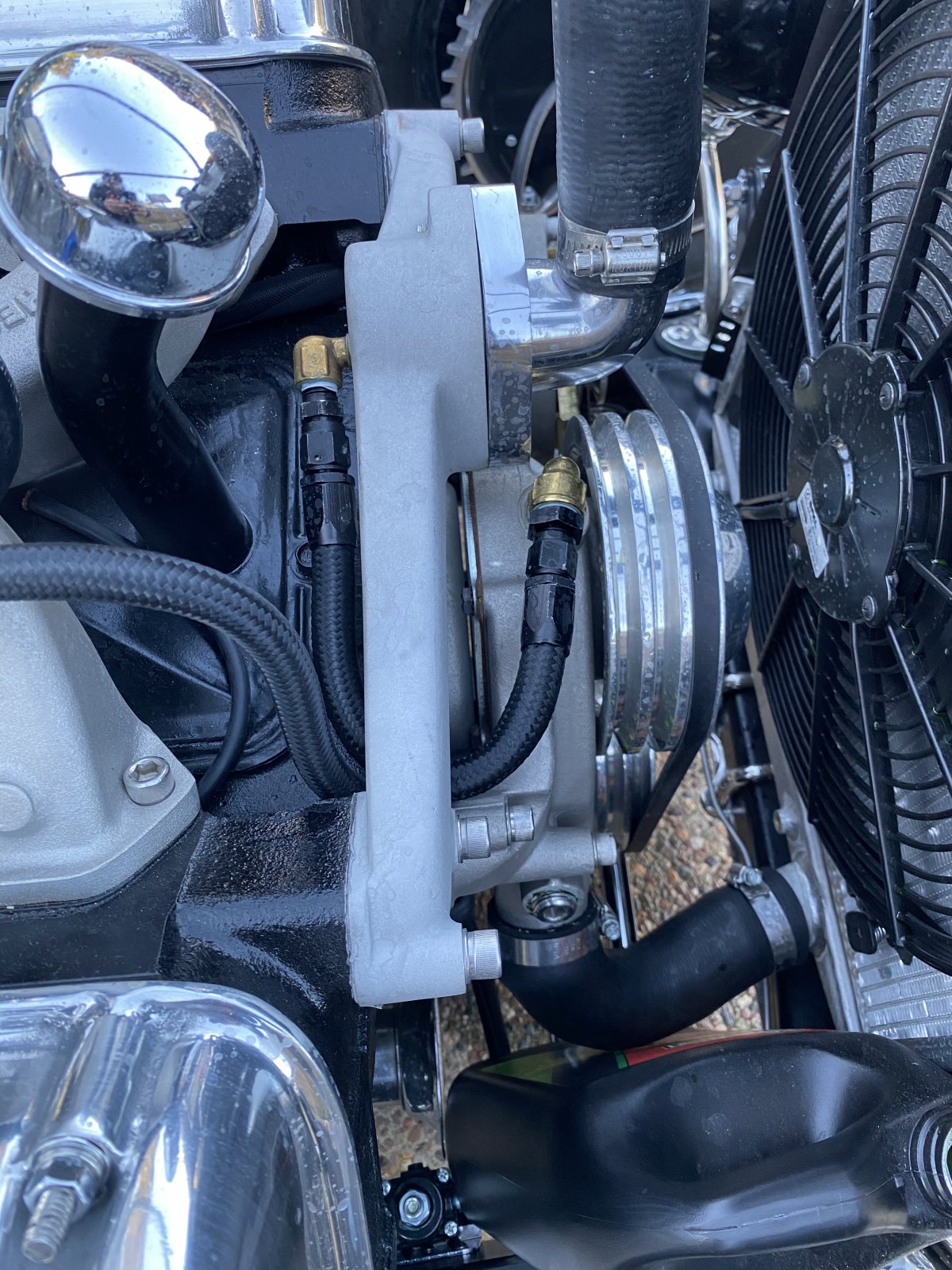

    Ok I guess it’s time to bring it to the pros. I’ve been on here for the last 3 days and nights reading every thread I can find about this. Tried a few things I found on here, but no remedy yet. This is a first fire up minus run on a motor stand after rebuild about 9 years ago.
    Start with:
    1957 392 rebuilt basically stock with a very mild cam. Stock valves, not bored over... blah blah
    Hot heads BBC pump, cross over, intake.
    Blocked off at rear heads.
    180 thermostat with two 1/8” holes drilled
    Bypass run from water pump to back of cross over (see photo)

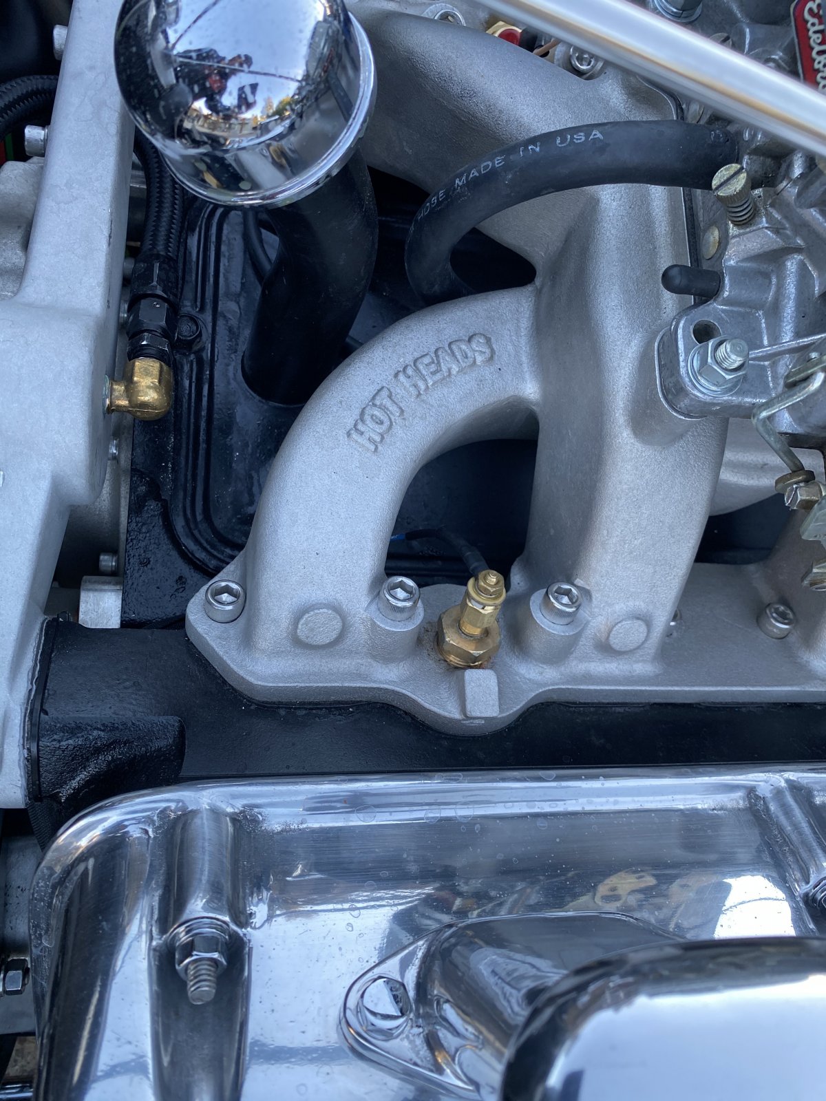

    What is the brass fitting in the intake manifold for ? I believe the stock location for the temp sender is in the rear of the water crossover manifold ( yours has a hose connected there ). I would make sure that hose is not full of air ( connected to the top of the pump ). Mine connects to the front of the water crossover , it's a really small 90 degree hose ( very similar to stock from memory ).
  6. babblewon
    Joined: Aug 19, 2007
    Posts: 202
    babblewon
    from cali
    Brass fitting on water pump, brass fitting on backside of crossover. Hose connects them for my pump bypass.
    brass fitting on intake manifold is temp sender. Passenger side has the same fitting for my electric fan sender. Both are front of the HH manifold

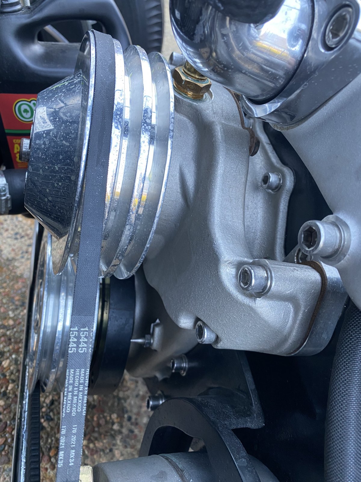

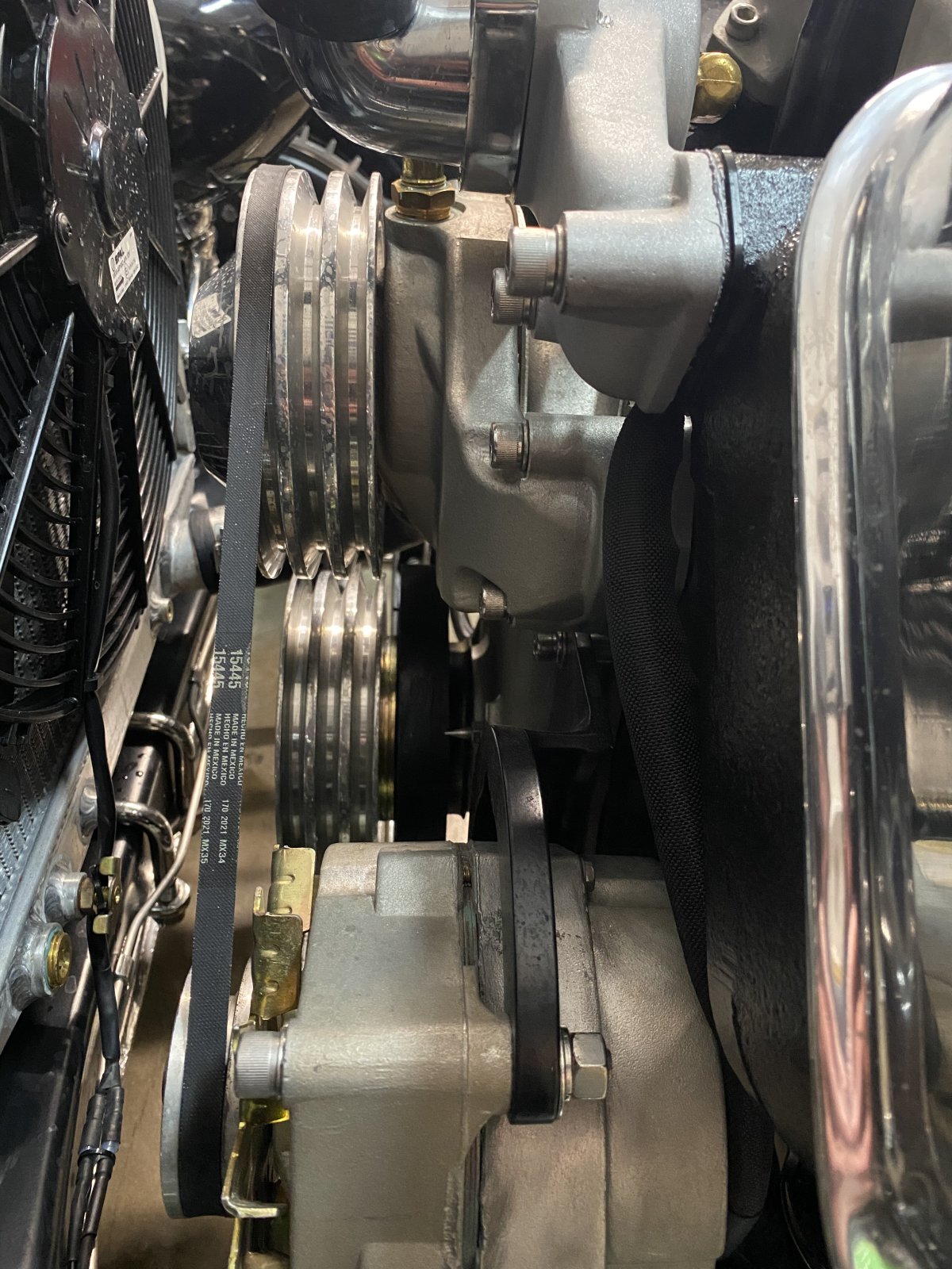

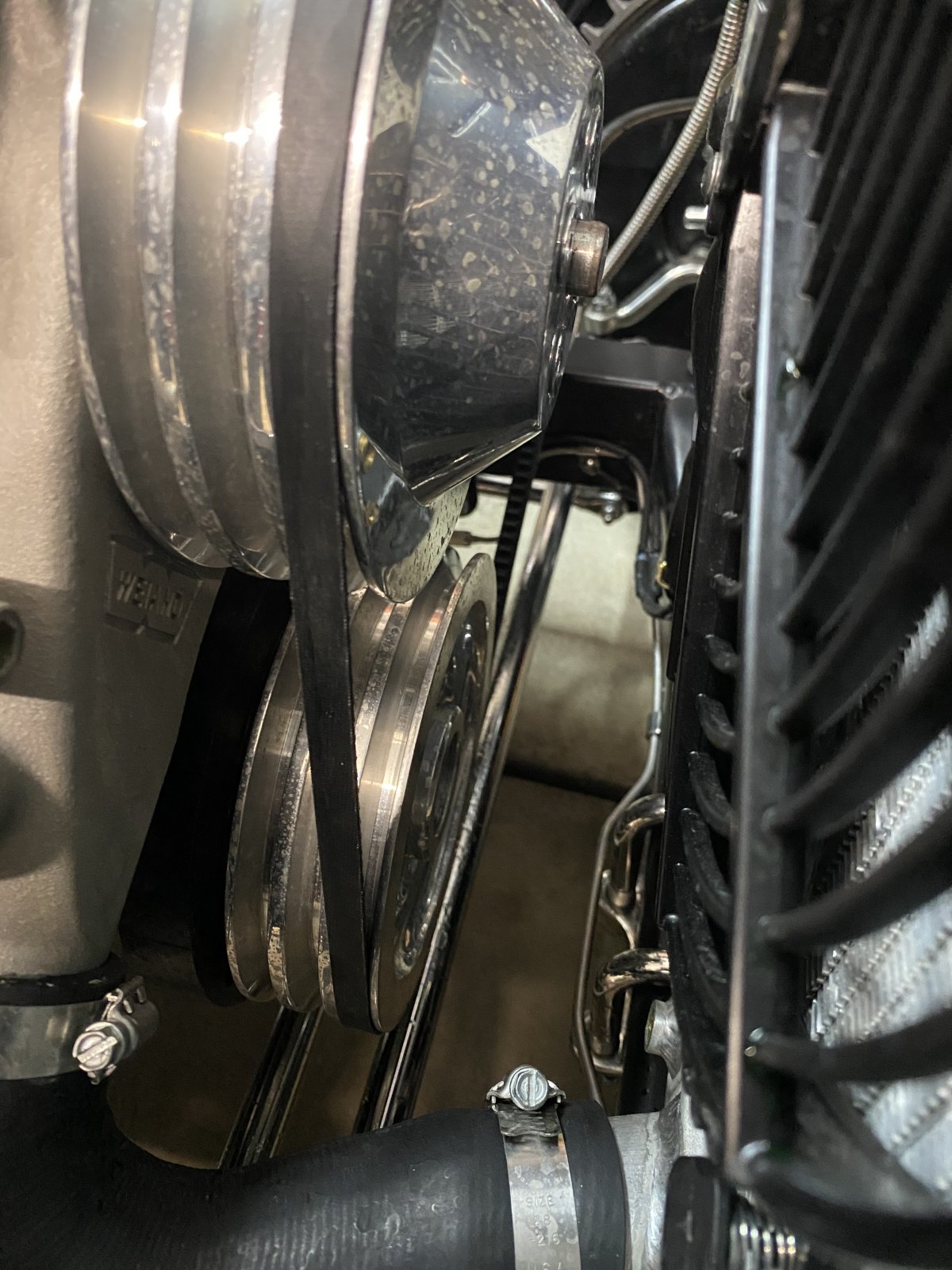

  7. dana barlow
    Joined: May 30, 2006
    Posts: 5,126
    dana barlow
    from Miami Fla.
    1. Y-blocks
    Only 3 pic?,more would help,,The water pump pulley an crank pulley look missmatched size wise in pic=water pump running too slow for rpm. Pic angles not real good though to really tell; Can be lot of other stuff or combo of.

  8. babblewon
    Posts: 202
    babblewon
    from cali
    crank pulley and water pump pulley are app. 6.5” diameter
    Crank pulley is closer to 7”
    dana barlow likes this.
  9. babblewon
    Posts: 202
    babblewon
    from cali
    Pics are hard to take, it’s tight in there. I’ll try a couple more

  12. Jim 392
    Joined: Apr 10, 2021
    Posts: 30
    Jim 392
    I'm not seeing a mechanical fan so I'm guessing the electric fan is on while you are getting this figured out ? I am not sure of the function of that location on the intake manifold on later heads ( 55-58 ). It is a leaving water passage on 1954 and earlier car and all truck heads ( 331 all -354 truck ) I believe .

  15. babblewon
    Posts: 202
    babblewon
    from cali
    are you talking about where my temp sender is? Intake manifold port at the front of the heads?
