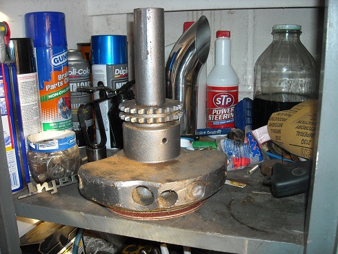

    What I'm really torn on is the crank as I'm trying to weed through fact and fiction on the "Machined in the US" strokers and 391 welded cranks. This snout is from a welded 427 stroker built by a FE performance shop, it snapped off on the first fire up in the car around ten years ago. It does a great job of keeping my grinding discs flat but while this one was free, I'd rather not have another.

    We've put alot of SCAT cranks and rods in plenty of motors Ford, GM and otherwise.....we use both the forged cranks and the 9000 series cast steel cranks. No problems with any of them .....ever. It's no longer worth the money, effort or time to use a welded up stocker if there are off the shelf alternatives purposely built for the application (like a stroker FE, etc).

    I generally run billet cranks when I can but I've yet to find one for FE in the $1,000+/- range I'd like to spend. I have seen the cast cranks fail but those were in abused high RPM small blocks in other people's engines. One would likley last me in the 406 but I'd rather have an economy billet or forging. I'm trying to nail down if any one company provides a better part in this range but so far all I see is Survival make claims of extra machine work on the Chinese forgings.

    Yup, rods too from what I have heard, and the chinese cranks are cast steel, not forged.
