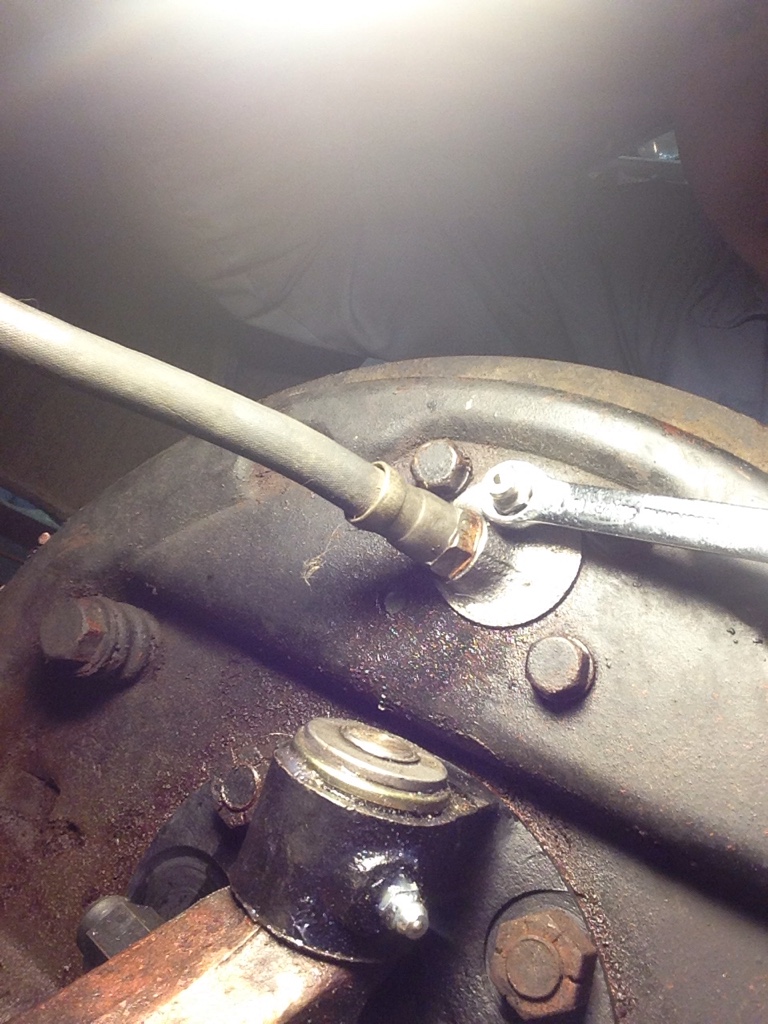

  8. Can you post some pictures of the cylinders. When you say no pedal is it just going straight to the floor with no pressure? Is there any inline proportioning valves??? Or pressure holders as I like to call them. Are the bleeder seats correct with the right bleeders. And you say there is no leaks anywhere but you went through 2 quarts of fluid? Did you hit the metal lines with a air hose and blow them out? Unhook the front line from master cylinder and hit it with air see if you can hear or see a line crack. I love brakes

  10. Standard 39-48 Ford master cylinder.
    Drivers front wheel cylinder.
    Passenger front wheel cylinder
    Pedal goes right to the floor.

  12. I've unhooked the drivers front brake hose, plugged the line, and I have a solid pedal now.
    So I've narrowed down to the drivers front wheel cylinder.
    I'll take the hub apart and see what's up.

  14. 3 wheel cylinders are Raybestos. One is Macs auto parts. Guess which one doesn't work!
    I can't get another wheel cylinder until Monday. So I'll change it out then, and report back.
    The macs one appears to be "working". It moves the shoes. It's not leaking. But doesn't seem to hold pressure.

  20. Replaced the Macs wheel cylinder with a Raybestos. Problem solved.
