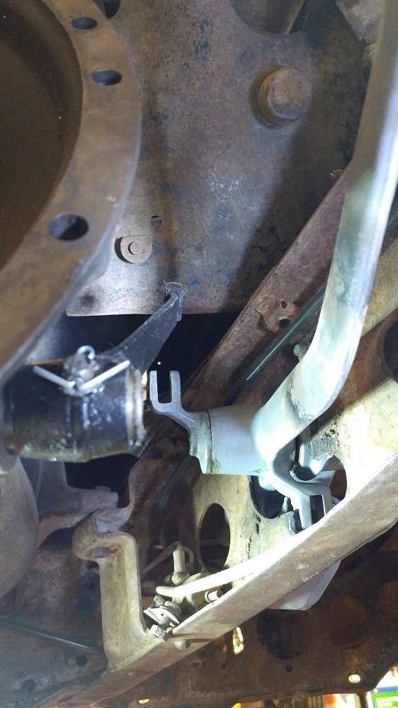

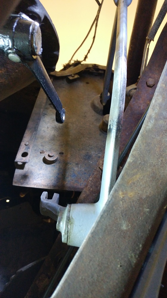

    I have a little different twist on the 1940 vs 1939 petals: I have a 1939 Ford Coupe - 327 Chevy and 4 speed Muncie. This car has 1940 petals and the 1965 or so Chevy car Z-bar - to work the clutch. Refer to pic attached. The Z-bar is sorta in the way and I need about 3/8 more disengagement on the clutch fork - scrapes in reverse - forward gears are good. I bought the Bob Drake 1939 repo petals - and using the Mustang - later dual bowl master cylinder - which the Drake 39 petals are drilled and I can omit the adaptor in the 1940 petals - and I would like to reclock and I think lengthen the 1939 clutch petal fork. I saw a pic of this adaptation in Frank Oddo's Street Rodder build book - but not measurements. Has any one adapted 1939 Ford petals to the Chevy 4 speed trans? If yes - please provide pictures and descriptions. 39 clutch MNS.jpg

    Reworked my 1940 petals - with new clutch fork position and z- bar rod - moved mounting area out for better leverage and fabricated a long connecting rod from the Z bar to clutch fork while keeping the 1940 petals - Car is on jack stands - fired her up and forward gears shift good and no grinding in reverse. Will road test next weekend - hope this works. So for now I will not change to the 1939 petal set. But for a new installation - I think the 1939 Ford petals are better to do a manual activation on clutch fork - vs slave cylinder.
