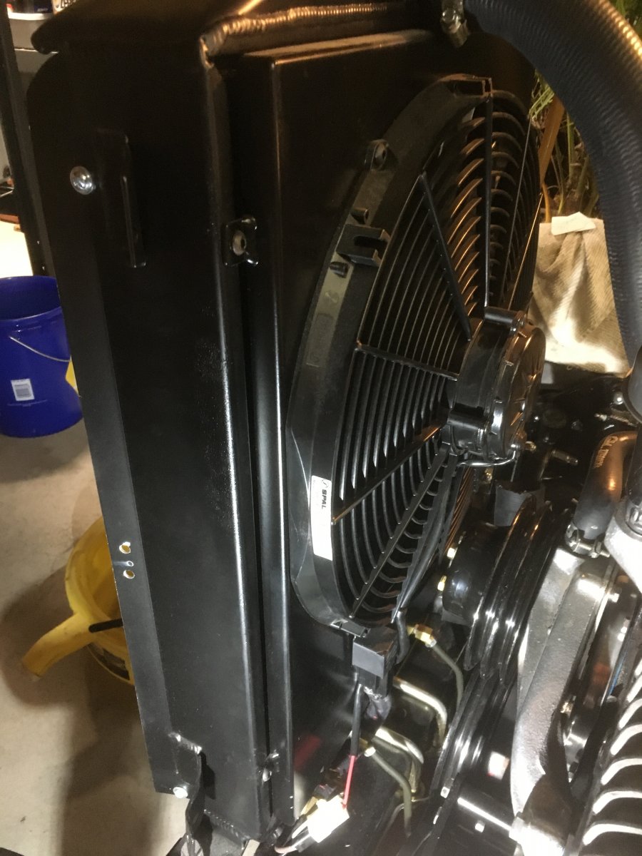

  12. I took great pains to block off the sides of my radiator where I had gaps. The areas were tall and narrow, I used aluminum angle from Ace Hardware and milled mounting slots in them. It did the trick. I was running a solid Chrysler fan and a shroud, went to a good quality flex fan and it ran 175* right away. I have an electric fan on a t-stat for when I get stuck in traffic. Have you considered a mechanical fan and shroud?

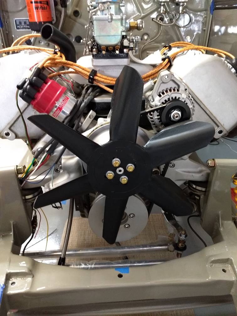

  18. koolbeans
    Joined: Apr 12, 2015
    Posts: 499
    koolbeans
    I had same problem. Check out Flex Fan #416. The blades are flush to front face of pulley...not forward.
    Good for 8000 rpm. Will suck the hair off a frog at 100 yards. IMG_20200607_111311706.jpeg IMG_20200607_111503835.jpeg
    Sent from my XT1710-02 using The H.A.M.B. mobile app
    bobss396, loudbang and AHotRod like this.

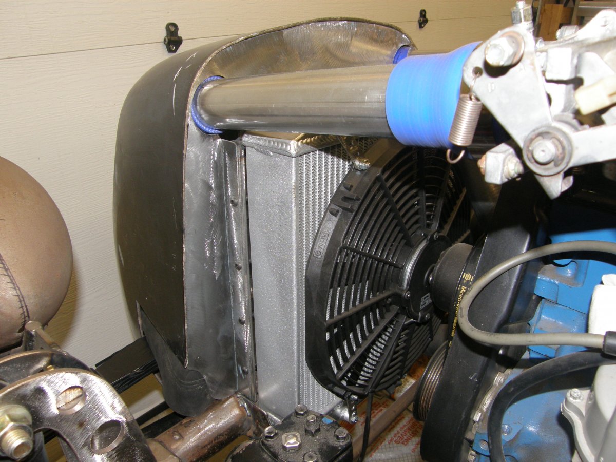

    I sealed up my rad to track nose while I was building the roadster. 18 ga steel trimmed to fit and bolted to rad support. Down low I put pieces of old pond liner to seal between the axle and track nose. Flexible so it could move with the axle. I also installed an air dam underneath to help with directing the air.
