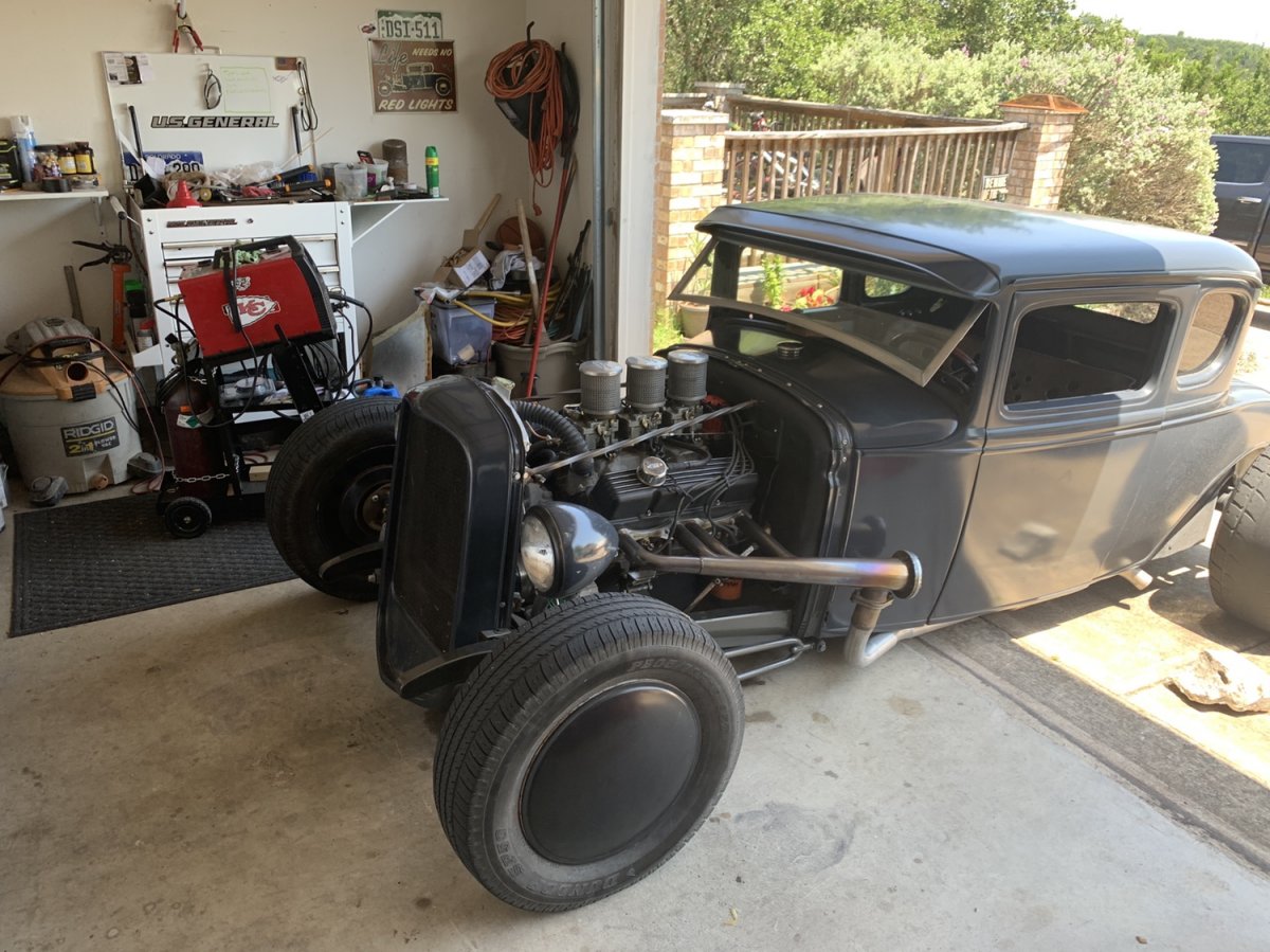

  6. Jchill40
    Joined: Jun 22, 2020
    Posts: 15
    Jchill40
    Pusher was necessary for lack of room for puller or a flex fan. Picture hopefully attached this time. I maybe made a mistake adding it in original post

  7. Jchill40
    Posts: 15
    Jchill40
    Appreciate the reply. Original post I thought had a picture, guess not. Pusher solved the problem in Colorado. A 220 mile cruise in 90° temps in Colorado the day before I hauled it to Central Texas. Temp never got over 200°. Since I’ve been here in Tx can’t keep it under 230° at hiway speeds.

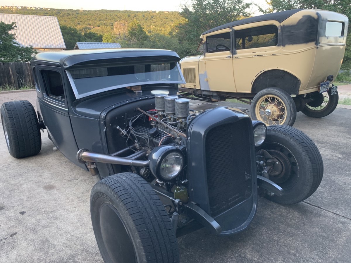

  10. Jchill40
    Posts: 15
    Jchill40
    1930 Model A

  13. greybeard360
    Joined: Feb 28, 2008
    Posts: 2,078
    greybeard360
    Short or long water pump?
    I can't see the front mounted fan but seeing what I can, it looks like the radiator could be moved forward in the radiator shell. If you are using the long pump put the short one on it with correct pullies and make room for a real fan. If needed pu
    t the a/c condensor under the back of the car with the pusher fan on it. That is how my brothers model A is done.

  15. trollst
    Joined: Jan 27, 2012
    Posts: 2,108
    trollst
    I see blue headers, all the way to the back, you're pushing a ton of heat out the exhaust, and in my opinion, WAY more than you should. There's got to be a lot of fire going into those pipes, in an open hood car, you shouldn't have that kind of heat, Start with timing, I agree the pusher fan is bad, they block a ton of airflow, but somethings wrong with your setup, the headers show it, even under a tight hood and side panels you shouldn't have that kind of heat.

  27. MAD MIKE
    Joined: Aug 1, 2009
    Posts: 782
    MAD MIKE
    from 94577
    We need to make cooling great again. Build that wall.
    He's right.
    If you look at your grille/rad pic you can see past the rad and I see the frame rail...
    At speed the air is going to find the path of least resistance.
    It's not going to go through the radiator, it's going to go around it.
    Air is hitting the rad, stopping and going around the radiator.
    You need to block off the opening between the grille shell and the radiator.
    It needs to be funneled into the radiator, otherwise it will go around the radiator and not cool.
    That is what is happening at speed.
