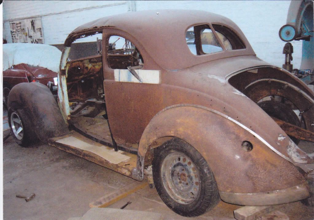

    Yeah a bloke said he had a 38 coupe i could have so i said yes before i looked then i found a sedan with no roof or doors
  3. mercurymitch
    Joined: May 14, 2011
    Posts: 194
    mercurymitch
    from Australia
    Then put the two together

    A bloke gave me 4 mudguards or fenders and that gave me most of a car ,sortof.
    I made the lower sections from 2ml sheet cut with jig saw and welded together

    Okay heres the pic all joined together[​IMG]

    Its not finished,ive been building it for a bit over 2 years

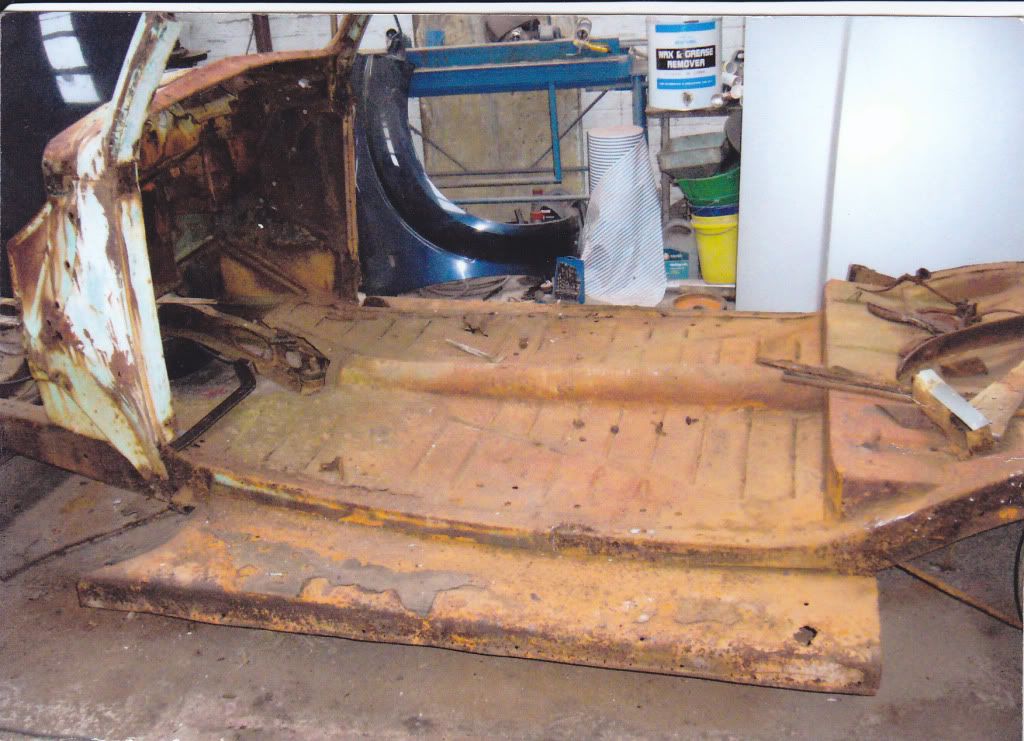

    Then i decided to cut the rusty bits off
