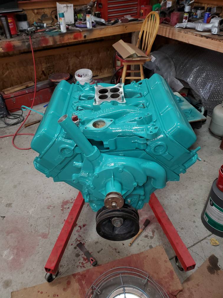

  10. rsmcewood
    Joined: Mar 6, 2013
    Posts: 23
    rsmcewood
    saltracer219 and jimmy six like this.
