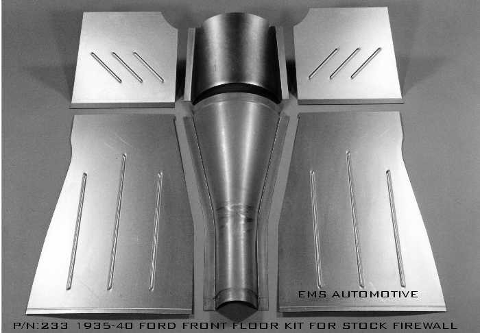

    this kit has a better transition from trans cover to drive shaft tunnel and it is included at no extra charge

    Thanks, but I'm beyond a different floor set. I'll keep a record of your co. As I plan on another 36 to 40.
    I really didn't have trouble blending the back of the tunnel DSM supplied, I only used the front 2 parts they sent. The only part of the floor kit I really don't like is the very forward section of the tunnel.
    The kit was for a stock firewall and it sits about 1 1/2 to hi at the firewall. I'm going to fit it after the body is back on the frame.
