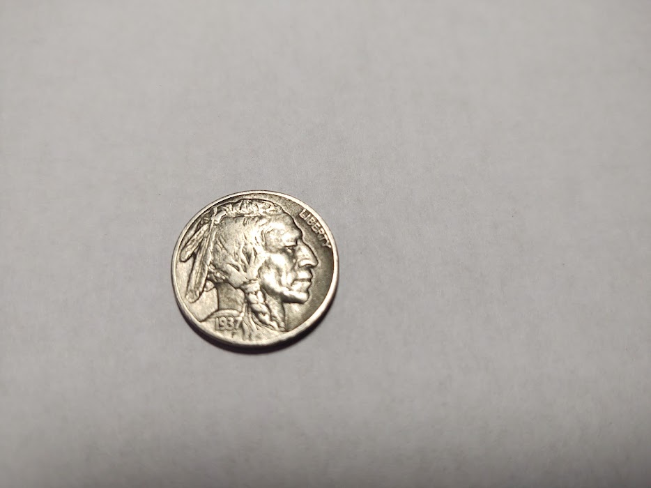

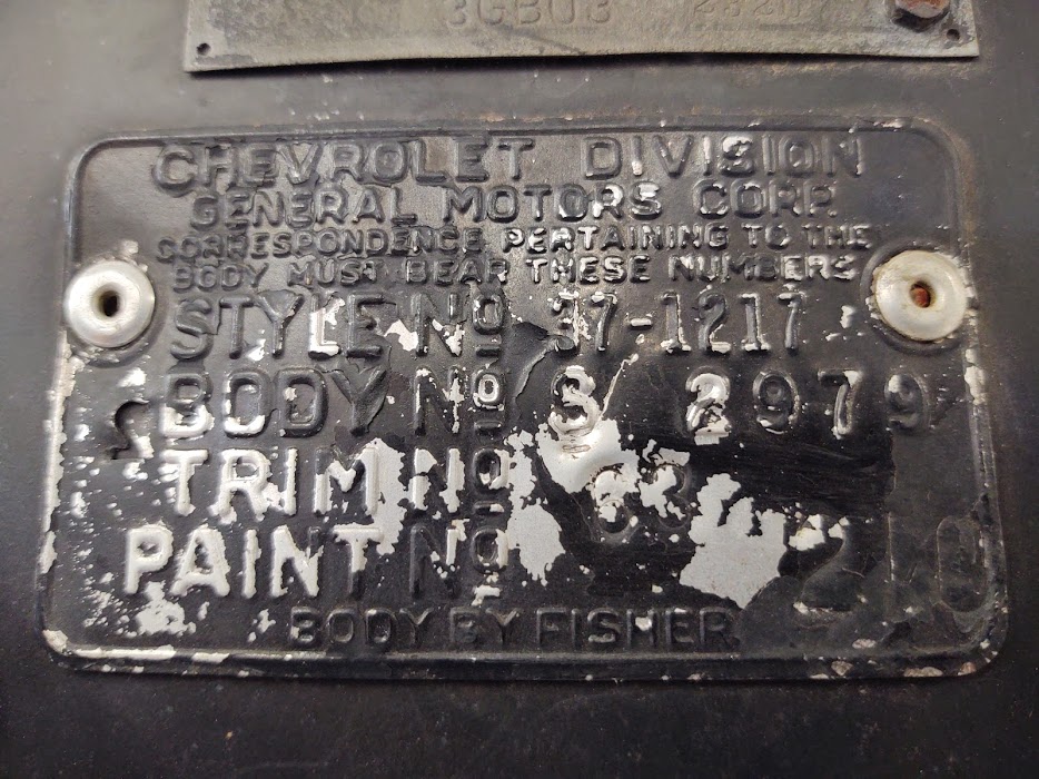

    This car has been very interesting to work on, every time I mess with it I see something new, or learn something!! I've been scraping some of the old tar based insulation off of everything inside, and one of my friends saw this ink stamp on the metal that we think is a manufacturer stamp from the mill on the raw sheet before stamping?!?! Then, a few days later, I was reaching my hand down into the bottom of the inside of the drivers door cleaning out old dried up weather stripping pieces, dirt, and other crap, I found a 1937 Buffalo head nickel!!! Its in pretty good shape for riding around inside the door for how long?! IMG_20210826_160502883.jpg IMG_20210826_160514731.jpg IMG_20210826_191049745.jpg IMG_20210826_191112885.jpg

    Awesome start to your project. I love 37 Chevy Coupes.
    Maybe set that 37 Buffalo nickel into the shifter knob or dash, that way it can stay with the car. It may have been dropped in the door when it was new.

  5. From what I know, your date deciphering looks right. How's it feel to be a hot rod archaeologist? I bet your dad would be pleased.:cool:

    I was told once by an oldtimer that putting a penny or coin into a brand new car was once considered good luck, and fairly common. When I was tearing my Austin apart back in 2010 to build my other gasser I found two Canadian pennies that were in perfect condition, but turned dark with age. They were hidden in the frontend metal, and dropped out when I removed the front clip. The car was imported to Canada, so made sense the coins would be Canadian.

    Cool story, never heard that before. I was told by a guy on the 37-39 Chevy page, his dad told him they would put coins between the glass and weather strip to help stop rattles, then they would end up in the bottom when you hit a bump, or rolled the window down?!?

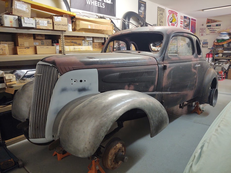

    Couldn't leave well enough alone! Started sanding a little on the mostly original paint. Paint wasn't savable, cracked really bad, with Houston humidity causing surface rust underneath. Looks like 3/4 + of the paint was original?! with some spot priming to cover bare spots. Started to sand, was making a awful mess, and taking a IMG_20210628_075710969.jpg IMG_20210701_172831239.jpg IMG_20210718_172825636.jpg IMG_20210719_144732738.jpg IMG_20210719_144617405.jpg lot longer than expected, so I started scraping with my gasket scraper, and it worked great on that old dried out cracked paint! Came off way faster, and a much easier mess to clean up

    My car is getting lighter all the time!! scraping off piles of old paint, and old sound deadener insulation. IMG_20210719_102314308.jpg IMG_20210719_181835273.jpg IMG_20210723_174829269.jpg IMG_20210725_102519956.jpg

    Wow! That thing is really clean underneath! It is always nice to start with a car that has little or no rust like yours.

    After scrapping and sanding quit a bit of the paint off the car, wanted to see what was under the lead of OLD repairs?! Whoever was slinging lead back then, would have been in love with Bondo, if it was available back then!! LOL Melted at least 10lbs out of the tail pan !! Hard to see in the pictures, but large areas where the lead was 1/2" thick!?!? IMG_20210801_164627889.jpg IMG_20210801_164644462.jpg IMG_20210810_170014711 (1).jpg

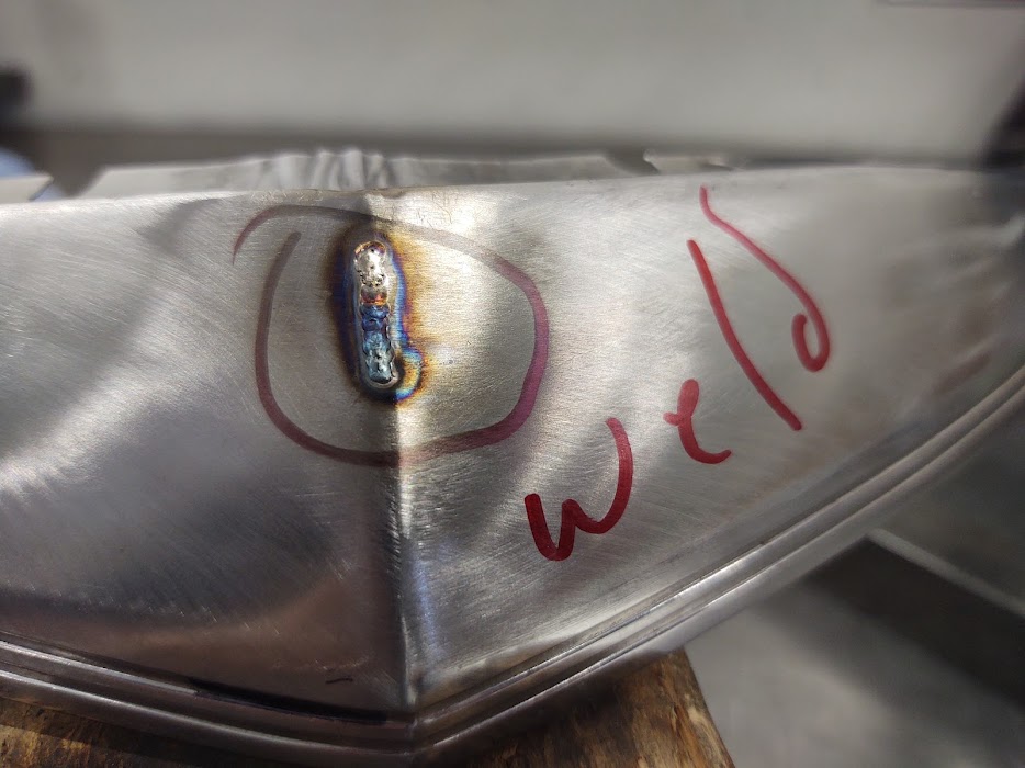

    Welded up crack in the thin stainless upper grill trim, metal finishing, and prepping for polishing. I did a lot of the metal finishing on all the stainless trim, prior to handing off to the polisher to finish up. IMG_20210811_143408366.jpg IMG_20210811_161108646.jpg IMG_20210811_165327264.jpg
