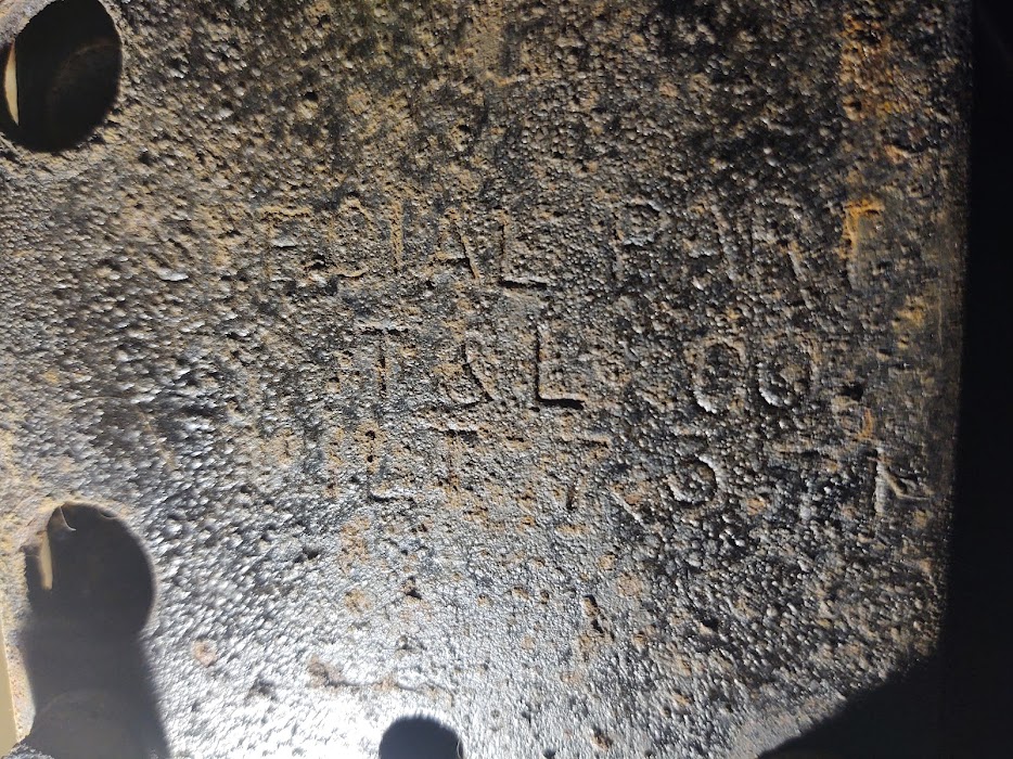

    RatPwrd
    1. 37-38 Chevys
    So here is why I believe this car and or parts were at least partially professionally shop built. The sticker in the rear window "McBride engineered competition racing machines Tulsa Okla" and a smaller version under the hood top. All of the chassis parts look very well thought out and made. These parts weren't made with a cutting torch, hammer, and a rat tail file!! LOL There are 1/8" plates reinforcing the bottom of the front frame rails from under the front floor boards, to the front cross member. There are 1/4" plates reinforcing the bottom of the frame rails about 18" long under the front spring eye on the rear leafs. All of the parts; rear upper shock mounts, frame reinforcements F/R, tow bar/upper front shock mounts, trans cross member mounts, and traction bar mounts F/R, all have stampings on them. They all say T&L CO, Special Part, built by, etc, etc, and a series of numbers like a part number or more likely a date?!?! But, if the numbers are a date, that put all these nice new Ricky Racer parts built/installed right before the car was parked in 1972, and didn't leave the storage building until 2015?!?! Would love to find out any information or history about the McBride company!! Any hot IMG_20210501_095939866.jpg IMG_20210502_102511513.jpg rod racing historians from the Tulsa area?!?!

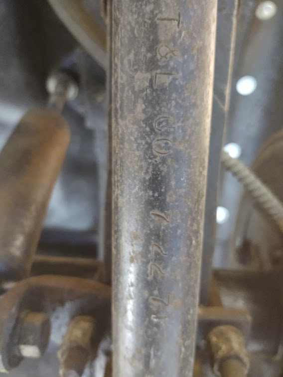

    RatPwrd
    1. 37-38 Chevys
    Front upper shock mount/tow bar brackets. T & L 7 8 71....July 8th 1971?? and if you look all of the hardware holding the chassis parts are all nice high quality, high strength bolts, not hardware store grade 5 stuff!! IMG_20210901_213058387.jpg IMG_20210901_213105985.jpg IMG_20210901_213144526.jpg IMG_20210901_213202452.jpg

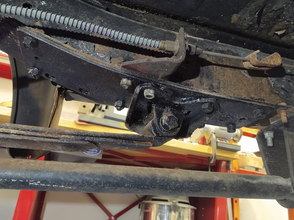

    RatPwrd
    1. 37-38 Chevys
    Trans crossmember and mounts. Factory muscle car era GM trans crossmember, probably a brand new part off of a then late model car?? Must be Camaro, or Nova? 31" wide, measured my Chevelle, its 54" wide IMG_20210901_211724195.jpg IMG_20210901_211736053.jpg IMG_20210901_211805548.jpg

    RatPwrd

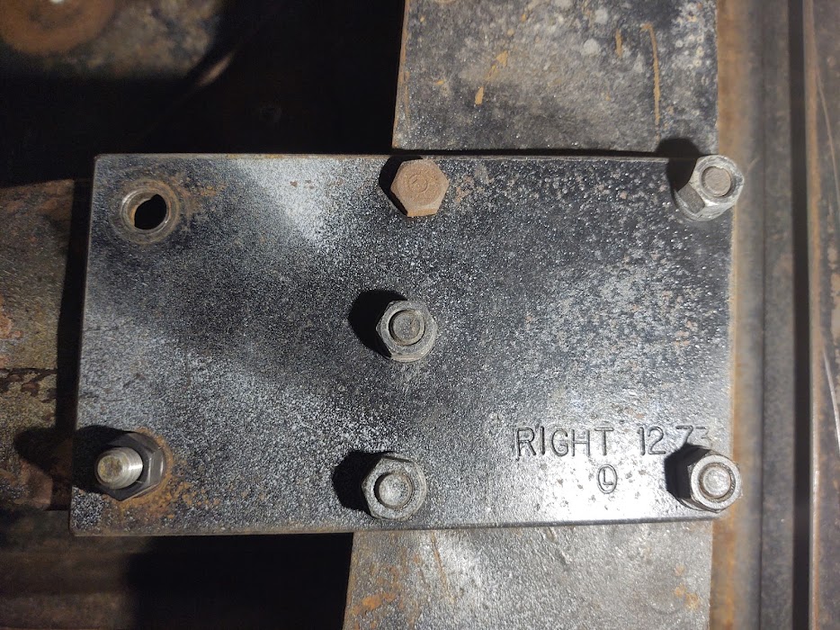

    1. 37-38 Chevys
    Front frame rail lower reinforcement plates. go from under the front toe boards forward, all the way to the front crossmember under the radiator. Bolted and stitch welded to the frame. IMG_20210901_211833816.jpg IMG_20210901_211900703.jpg IMG_20210901_213123826.jpg 1/8" plate cut to follow the gentle "S" bend of the frame

    RatPwrd
    1. 37-38 Chevys
    Rear spring, front spring eye reinforcement plates. 1/4" thick, about 18" long, factory mount welded to the bottom IMG_20210901_211322676.jpg IMG_20210901_211424819.jpg IMG_20210901_211440364.jpg IMG_20210901_211359234.jpg

    RatPwrd
    1. 37-38 Chevys
    Rear traction bars, and mounts, 1 1/2" diameter tube! all 1/4" thick plates IMG_20210901_211633253.jpg IMG_20210901_211615848.jpg IMG_20210901_211029104.jpg IMG_20210827_144147082.jpg

    RatPwrd
    1. 37-38 Chevys
    More close ups IMG_20210901_211209544.jpg IMG_20210901_211239076.jpg IMG_20210901_211407609.jpg IMG_20210901_211510296.jpg of the stampings on the parts

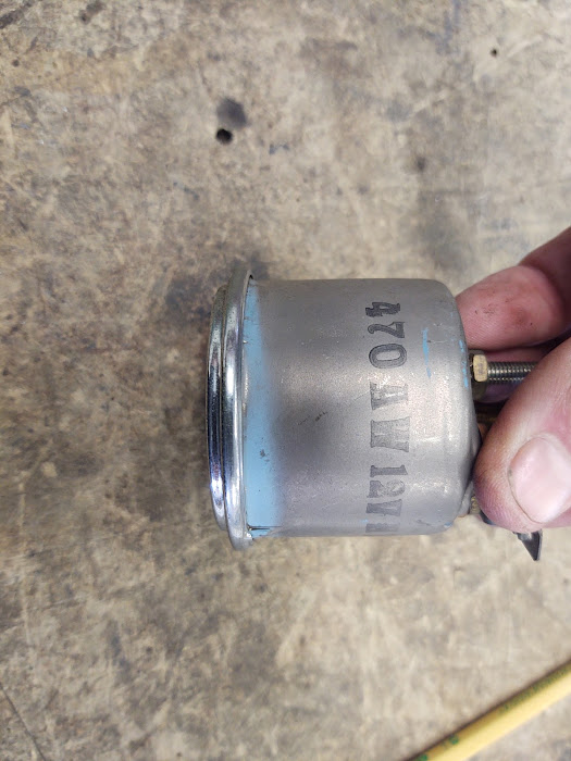

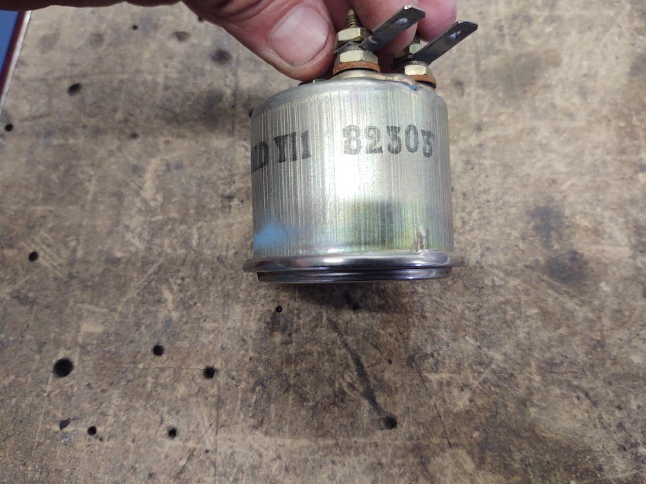

  22. Post pictures of the date codes on the sides of the gauges. That'll sorta establish a "no earlier than" race car build date. :)

  23. RatPwrd
    Joined: Apr 15, 2019
    Posts: 235
    RatPwrd
    1. 37-38 Chevys
    volt gauge, and fuel gauge, how do you read these date codes

  24. RatPwrd

    RatPwrd
    1. 37-38 Chevys
    oil psi, speedo, and tach, mech water temp had no markings
    loudbang and SilverJimmy like this.

    RatPwrd
    1. 37-38 Chevys
    OK......so this throws a whole new wrinkle in the time line of this car?!?! So "Just Gary" said to check date codes on the gauges, didn't know you could do that?! Speedo is N9 Sept 69, ok that lines up with the time line of the car. Tach has no numbers whatsoever? Water temp no markings? Oil PSI W 12 Dec 77, Volt Y 11 Nov 77, Fuel Y 9 Sept 79. Looking at gauges to see date code markings, I find along the bottom edge of the 2 panels..."built by Lynne 3 23 80 2E, and "built by Lynne 3 11 80 2E. So this car that I was led to believe was parked , and never moved from 1972-2015?! Had new gauge panels fabricated in March of 1980?, and newer 1977-1979 gauges installed?!?!
