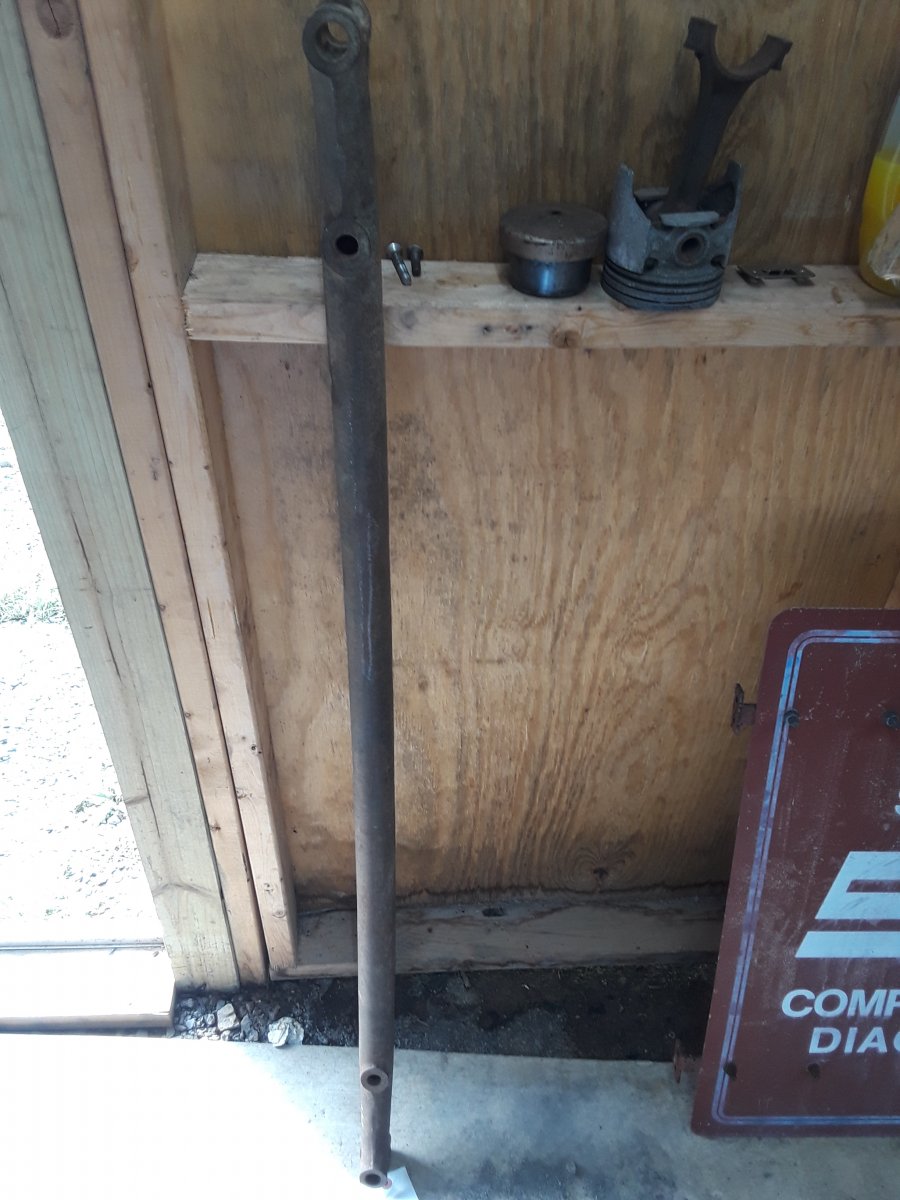

    This is what I believe to be the v860 axle

    Ok so there is not a difference in a truck and car v860 axle?

    There are two versions of V8-60 tube axles but they are so similar that most people would never spot the difference. And I’ve never heard of any of these tube axles on a truck.

    Oh ok. I didn't know there was more than one. I have two and they both look just alike. This person said the ones I have are from a truck because they are I little taller profile than the car ones.

    Those axles took a unique king pin and the k/p retainers are different too. The king pin has a radius machined in it and the retainer was a round cross section, not the typical wedge we are accustomed to seeing.
    If your axles have holes for the retainers smaller than 9/16” than they are unmodified, but if they are 9/16” somebody drilled the holes oversize to fit the wedge retainers and accompanying king pins.

    If you are talking about the place where the bump stop bolts go. I have 2 axles one does have a little bigger hole than the other one.

    Then I would expect the larger holes to be opened up to 9/16” for the wedge type k/p retainers, and the other axle is original as produced by Ford.
