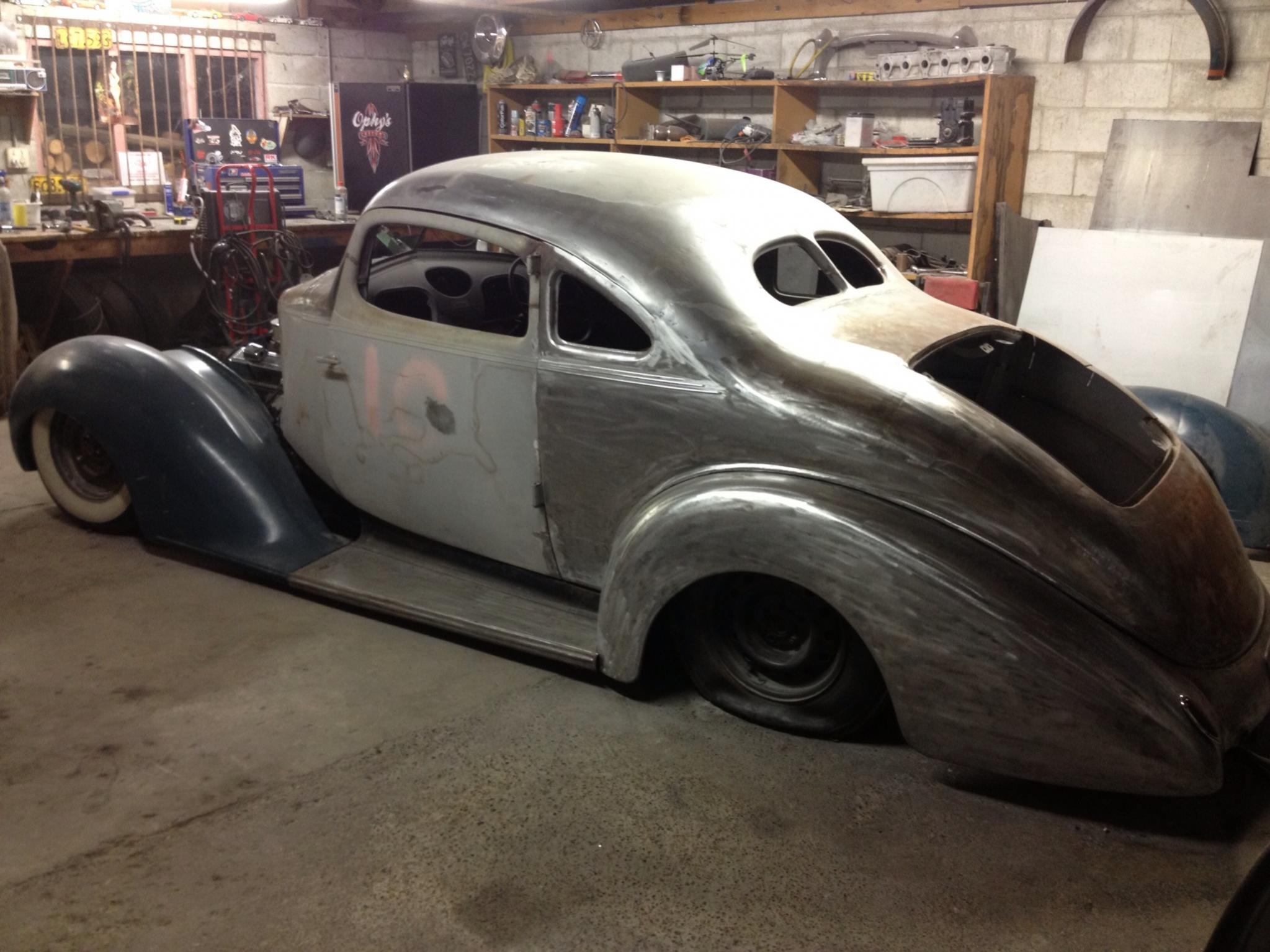

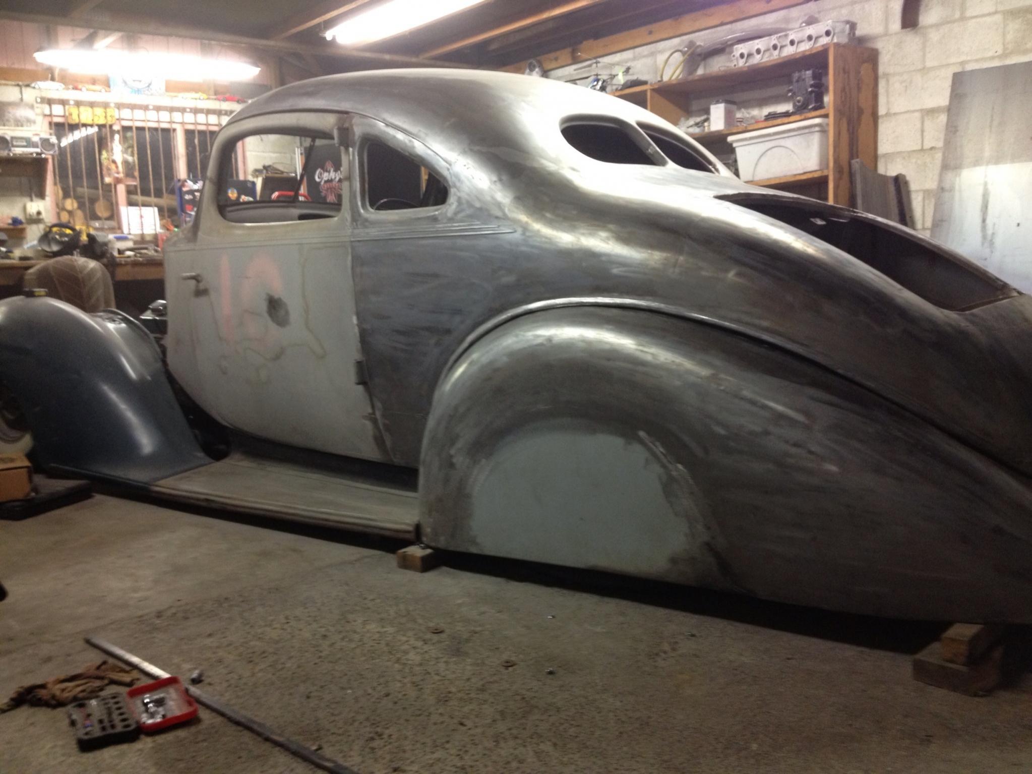

    Here's some pictures of my 36 hudson terraplane. Have always liked the 36 37 Chevy and ford coupes but couldn't afford anything in the condition I got this coupe in so il, try something different. Have chopped it 3 inches in the back laying the back window panel forward and only an inch in front screen and inch out of the roof. The back didn't flow with the roof so had to take 2 inches out of that too. Still not sold on the grill was thinking about making something my self le salle style maybe??? Any comments ideas would be appreciated

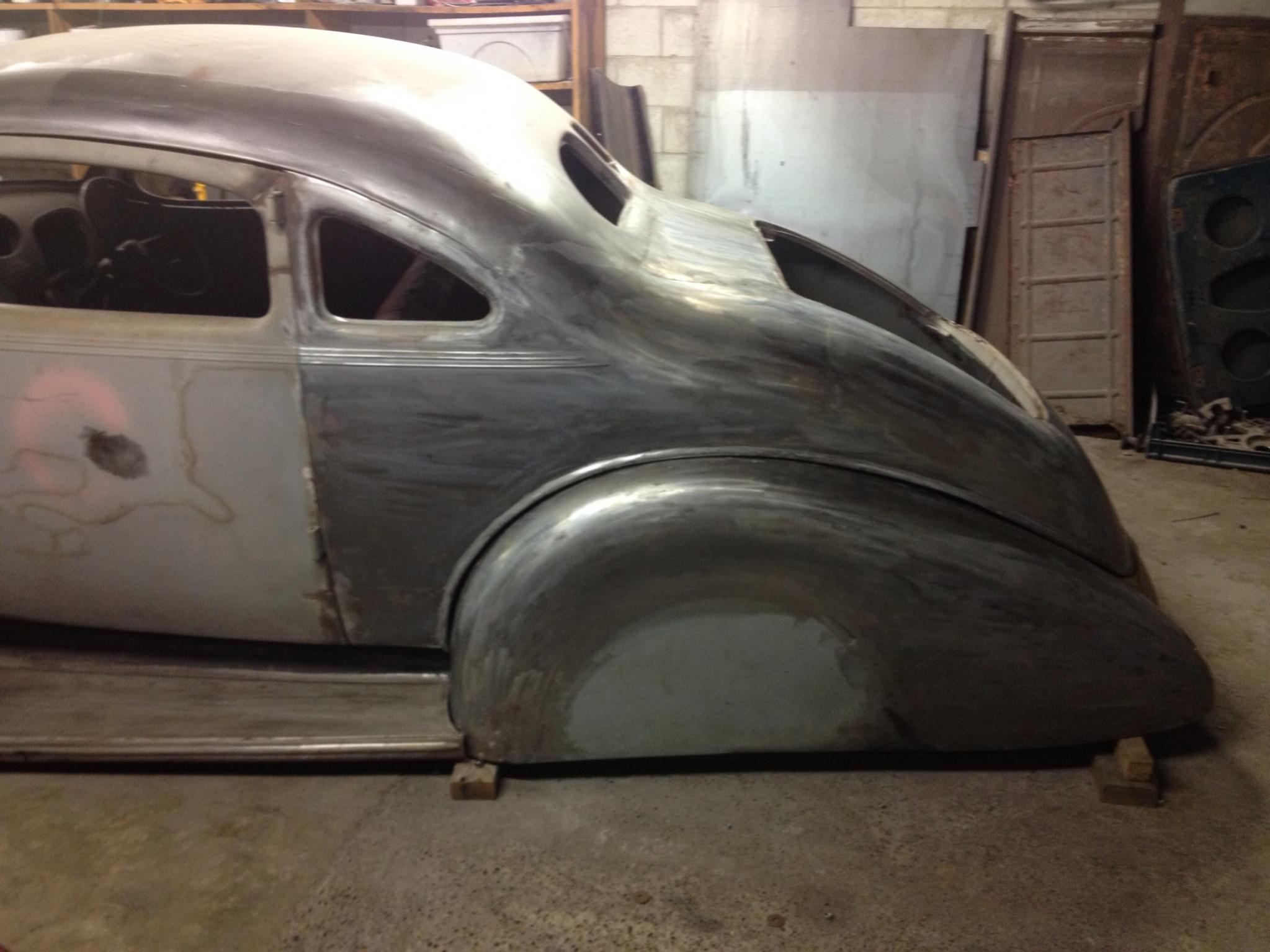

    Back guard filled in not to sure how going to get wheels off yet

    That's going to be interesting to watch. You may have to hinge them so they swing up or out from the body or set them up with pins that work like hood latches where you pull a handle to release the latches and take the whole fender off. Or skyjacker style hydraulics that lifts the rear of the car three feet like the Cali lowrider 63 Impalas.
    Truck bars, bags and a narrow rear end that sets the tires further to the inside than normal might help too.
