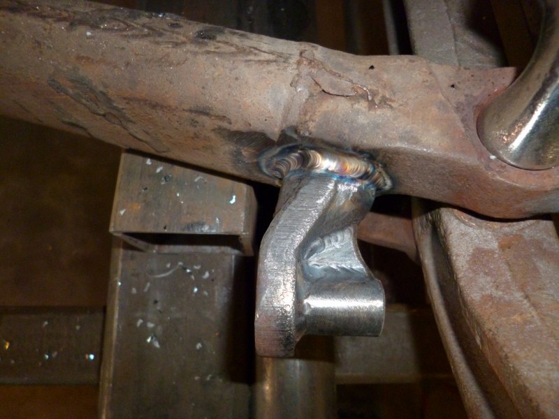

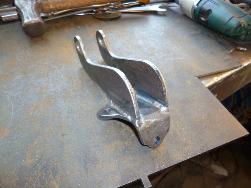

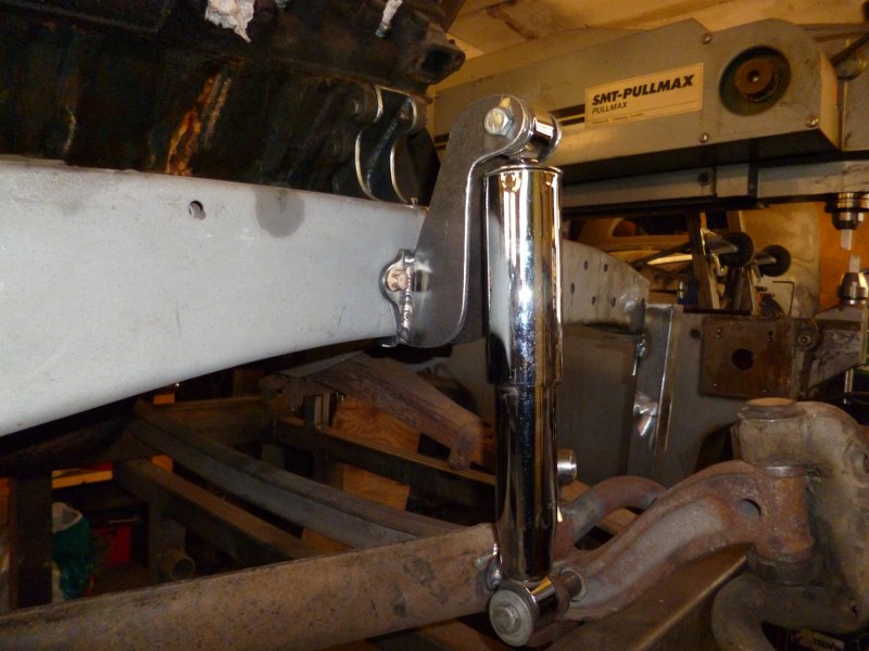

    Sneaked away from house painting this afternoon. Rain was in the air and that´s enough for me to go in the garage instead. Made some mountings for the front shocks. Finnished up the right side and now I just have to duplicate it mirror wise for the left side. Used the ends I cut off from the rear wishbones for the lower mount. I welded a sleeve on it for a sturdier application for the bolt and then welded it to the wishbone.Upper mount I made from 3/16" steel plate.

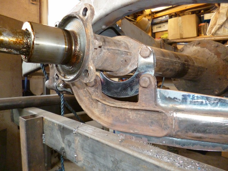

  14. Got some stuff made today. Finnished up front shock mounts and made two lowering mounts for the rear axel. Made them out off two pieces of 3/16" steel welded together in bottom and spliced as a fork in top where the axel attache.Raised the axel two inches but I believe another inch is necessary to bring the ass down where I want it.Think I´ll wait to do that untill everything is assambled and spring has set.Realized I have to eather c-notch the frame or make a higher kick-up for the rear axel.Think I´ll do a new kick-up, it´s a little more job but I get more space that way.

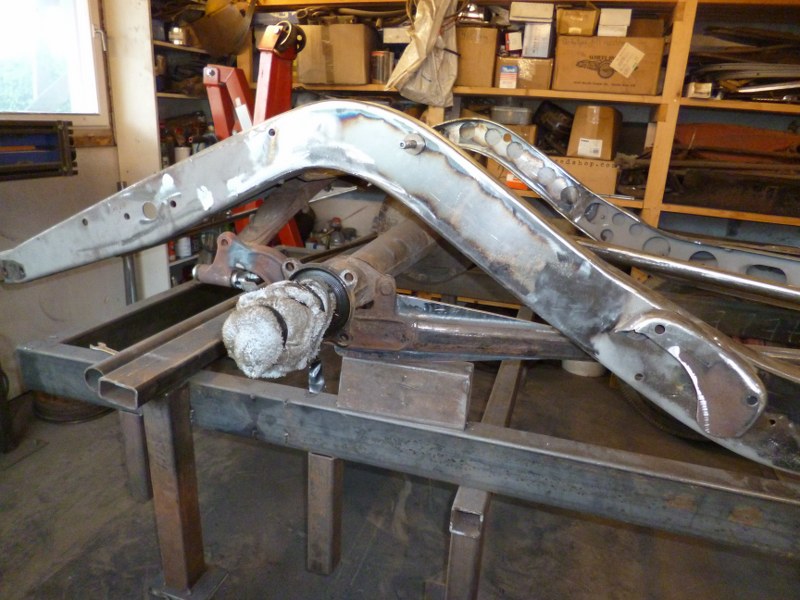

  18. Get started on the rear frame today.Rigged it up in the frame jigg again and start meassuring.Since I gonna cut the frame I decided to rise it enough so I can take away the risers between axel and wishbone.Lifted the back 4 inches meassured from the cross member.Cut some new kick-up pieces in the pullmax and welded on some flanges to make a u-shaped piece.Got the right side tucked up and it looks good enough for me.

  20. So here it is, the new kick-up.If the math is correct there will bee about 4 inches of clearance now.
