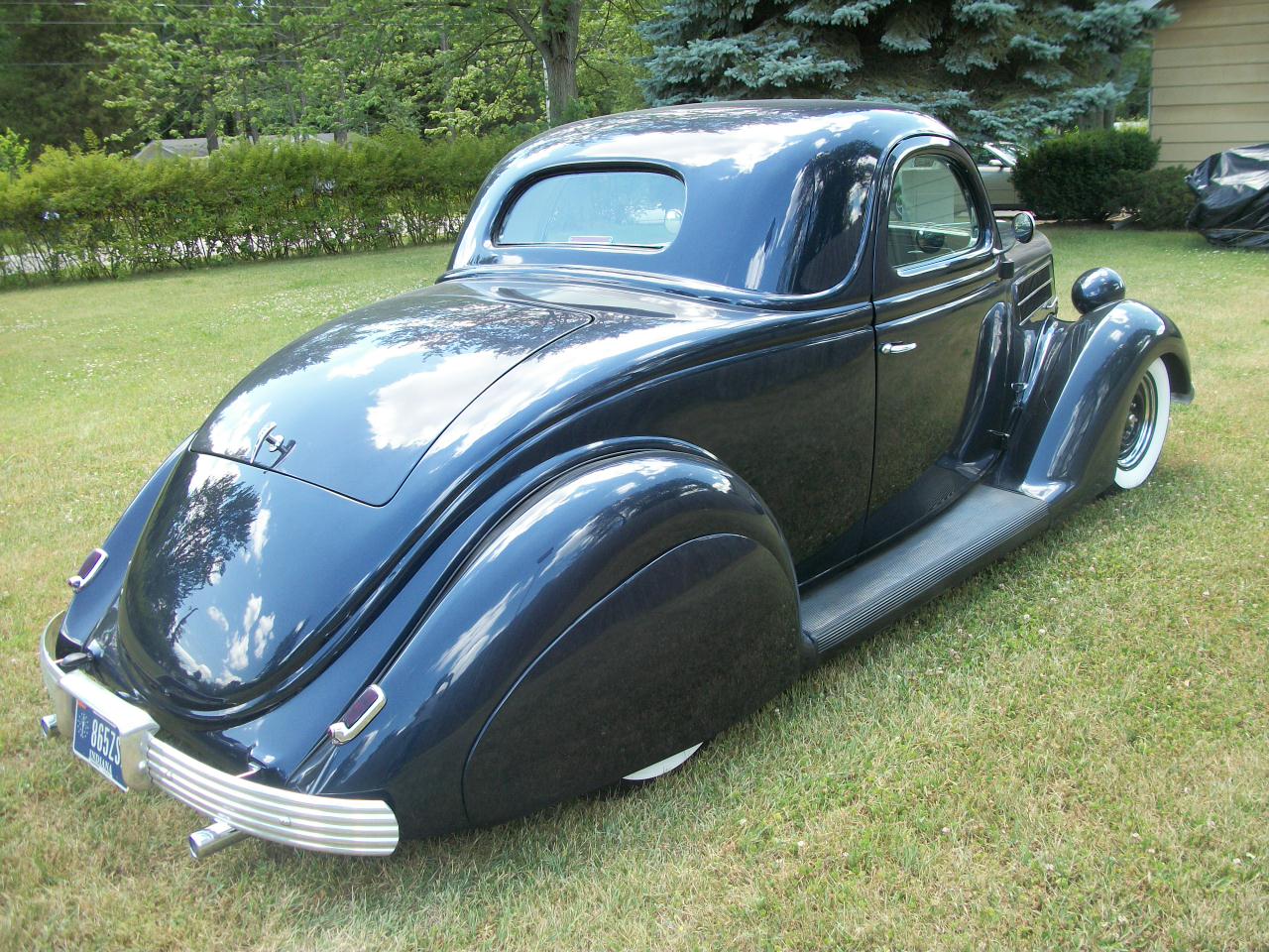

    I have the same tail lights, hub caps on my '36 3window. Great minds think a like!
    I am in the process of installing my '39 Zepher bumpers now.

    Sled is a friend of mine, I'll make sure I tell him aboat the thread, I'll know he will enjoy seeing the progress on the 36, p.s. I really like those bubble skirts.

    I saw this one this morning. It was beautiful. Sorry the photography is not doing it justice (phone).
