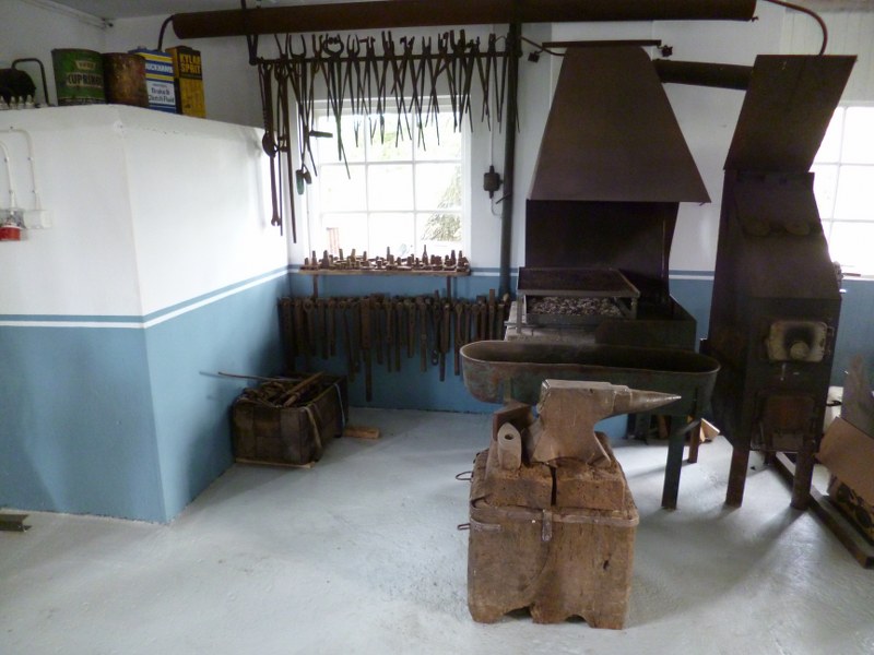

  7. UNBELIEVEABLE :eek: I thought it was impossible to ever break an anvil, can't imagine what did it after
    how many yrs. of use ?? Your forge & anvil are definitely a "keeper".
    Oh, nice rides, shop, work. :cool:
