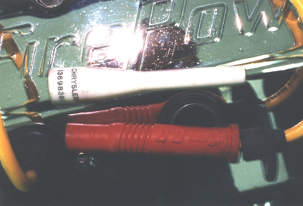

    Here is the stock hemi ceramic insulator next to an ACCEL silicone boot. The modern unit is the way to go.
