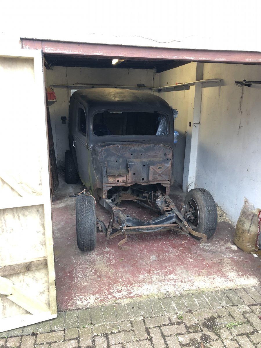

    this is how the truck is at the moment minus steering box , split bones as set up for a th350 , could I possibly modify this to hold the c4 ?

  3. Not really familiar with your chassis but you will need a rear sump or "double Hump" oil pan. they were available directly from Ford for the popular 351 W swap into the Fox Body Mustang. They came stock on a 351W Crown Vic or Mercury Grand Marquis from the mid to late 80's.

    The Fox body pan is not really all that great. You want the mid 70's van pan and pickup. The pan part number is
    E7TZ-6675-E, the oil pickup part number is E7TZ-6675-E. These are Ford part numbers. You will need to set the center of the firewall back some. With and IFS, you can get away with moving the driver side back about one inch. With the axle front, you will most likely have to move the engine back some to clear the suspension. We have motormounts for that application. You can probably just modify the existing trans mount to work with the C-4.

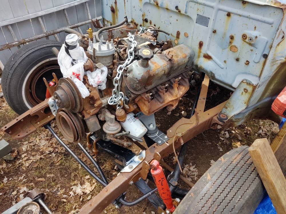

    This is my 47 Ford with a 351, setup looks similar, I went back to the original crossmember and the fuel pump is a little snug against the crossmember. IMG_20200322_142242585_HDR.jpeg
