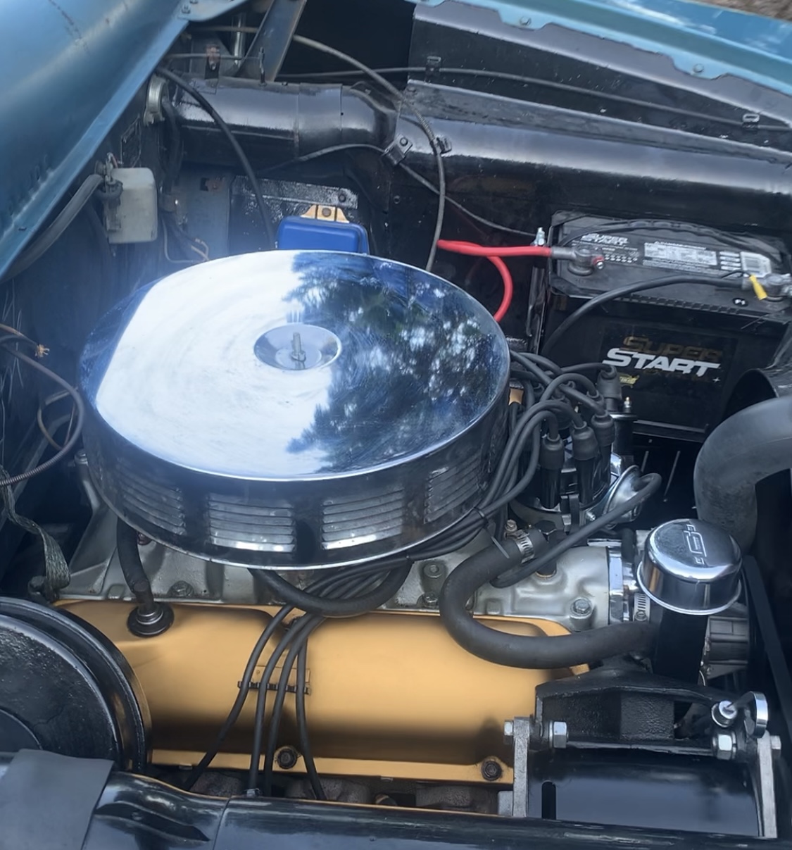

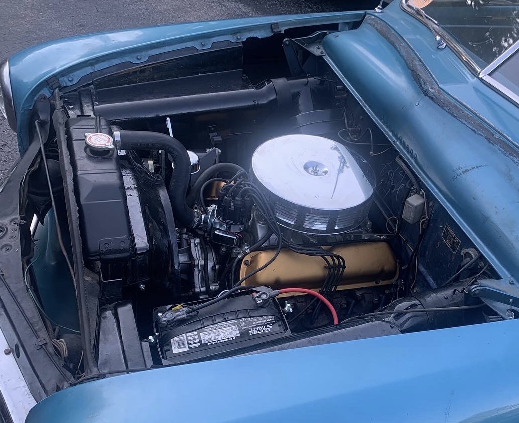

    @T&A Flathead has a 289 in his 49 ford coupe with the original 3 speed overdrive and he drives it all the time everywhere.

  16. T&A Flathead
    Joined: Apr 28, 2007
    Posts: 1,961
    T&A Flathead
    @flatout51 why anyone would put a sbc in a mercury or shoebox is strange to me. It’s just as easy to put in a Ford or something other than a cookie cutter and actually have something unique.
  17. MeanGene427
    Joined: Dec 15, 2010
    Posts: 2,212
    MeanGene427
    from Napa
    Sweet! Looks like it belongs there, doesn't it? I see you also have the nice stock 221-260-early 289 aluminum water pump setup. Funny, the Chebbrainwashed insist that you can't do that! Firewall looks OK, has a shroud, fits fine- but it must be blasphemy, as it can't be done without bazillions of dollars and specialty parts- but that engine looks just like the dead-stock 260 in my 64 Falcon ragtop- except mine still has the rubber boot on the generator

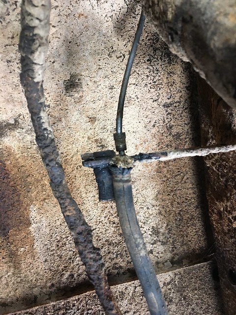

    [​IMG]Untitled by Travis Brown, on Flickr
    The first thing a project car has to do is roll, steer and stop. This is a great place to start.
    Do a complete brake rebuild. It's hard dirty work. It takes skill and there is a learning curve. You start out of the shop manual. As far as investment it's expensive but it's still minimal in grand scheme of things. Completing or attempting to complete a total brake rebuild will tell you if you and your son can hang through this project.
    Rebuild the stock 1950 brakes. Although both my children had wrecks, neither had to do with brakes. Both incidents were caused by driving foolishly.
    New brake lines...
    New shoes...
    Backing plates repaired/renewed...
    New hardware...
    New rubber hoses...
    New front axle seals and bearings re packed or replaced...
    New metal brake lines...
    Drums inspected repaired (turned) or replaced
    Rear axle inspection (seals)
    Emergency brake renewed
    This is hard, nasty and can be frustrating work.
    Doing this work, you will see the condition of the chassis floor and suspension. Again, if you can accomplish this work...hang through it and solve problems.
    If there is loss of interest. Sell the car. You have not modified it and invested a lot in power plants and special zippity-doo-dah stuff you are not going to use.
    Do the brakes. Finish them and move on.
    If your son going to bail, he'll bail out over the brake job.
    It's hard ass work.
    Be safe...an old car is like the river. It can kill you in hundreds of ways...
