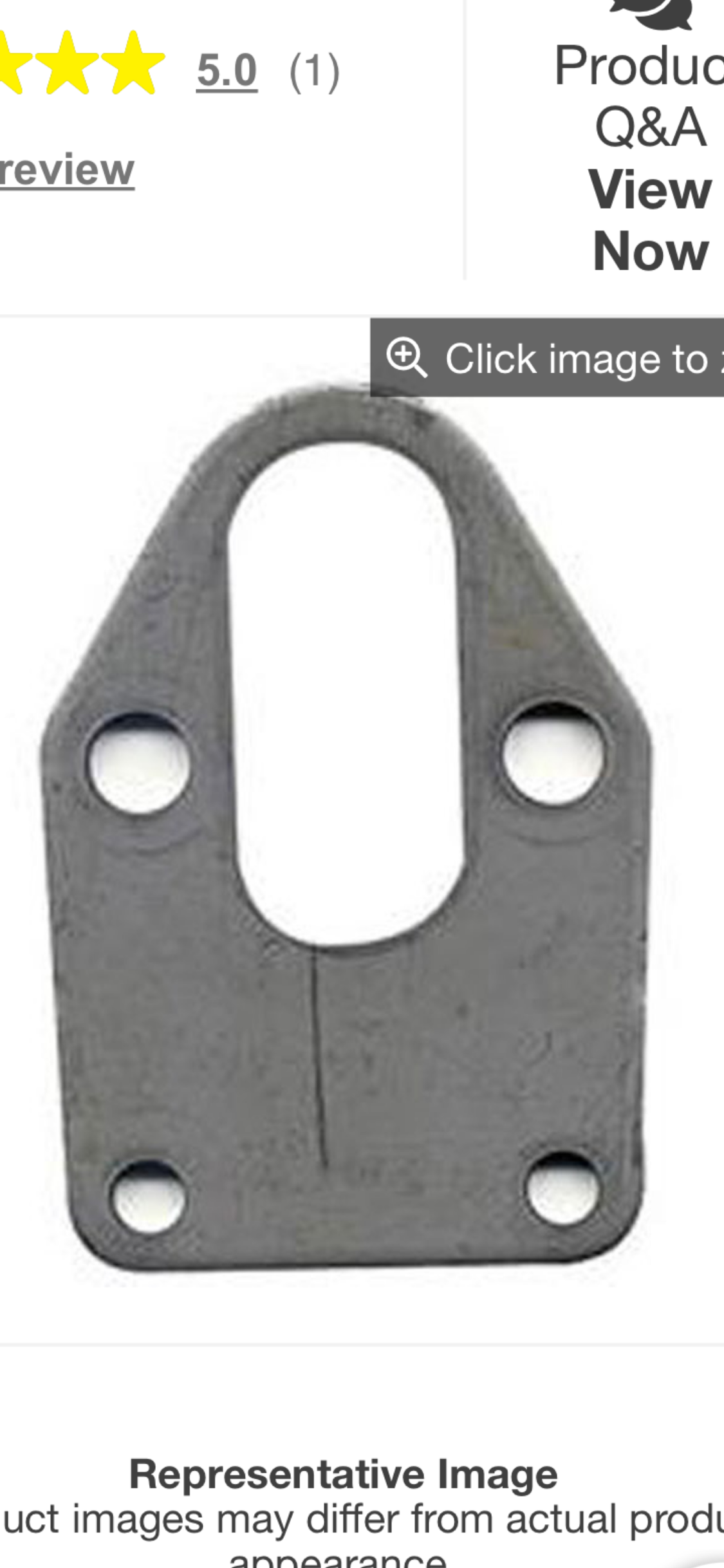

    This is the spacer 34Phil referred to. [​IMG]

    This is what otheres are calling spacer ,
    Not a spacer, its a part , plate to install & seal fuel pump rod & lube pump ,oil from lifter / cam back to oil pan block on sbc IMG_2396.png

    That's a block off plate not a spacer .

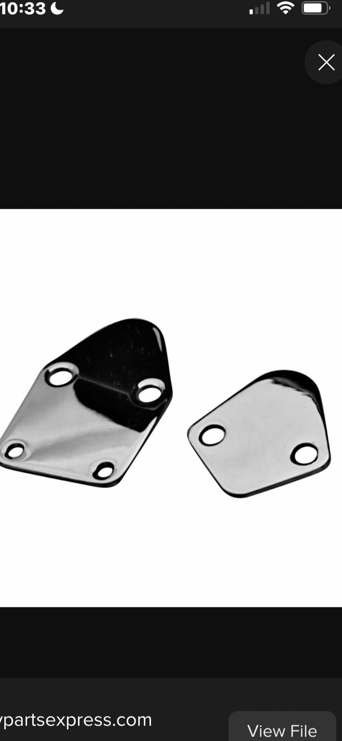

    Block off plates “do not” have the oval hole for pump arm to pass thru. IMG_3196.jpeg

    maybe Gm calls it ablock off ,
    But most consider pic below
    Block off plates .

    Those are aftermarket , not stock Chevy issue , they're differently designed block off plates . The stock Chevy plate blocks off the casting on a stock SBC .

    Share a pic , I know the pic I posted after market ,
    Around 86 ish , some of block , where equipped start of Efi, I do not know if I have seen a Gm plate ,maybe boat motor , I would think a Gm would look like the plate on left steel maybe cast & more likely with Gm #

    They do make a "block off" plate that looks the same but has no hole for the fuel pump arm. Those are used for electric pumps. What you need is a mounting plate. Every SBC w mech pump I've ever replaced required that. Also the new pump should come w a gasket as well.

    OK , the plate with the hole for the pump is called a FUEL PUMP MOUNTING PLATE . The blank plates are both fuel pump block off or " fuel pump Delete" plates . There , we good now ?

    What you are calling spacer is fuel pump plat,,, If plate not installed/missing it will pump a lot of oil out , no little leak ,,
    There are 2 gaskets required one between blocked and plate the other between plate and fuel pump ,
    one square with point on top and one diamond shaped .
