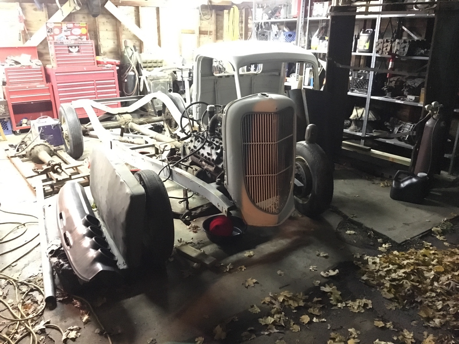

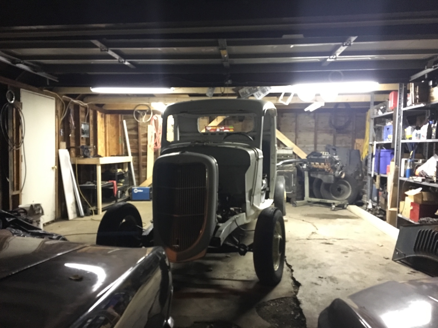

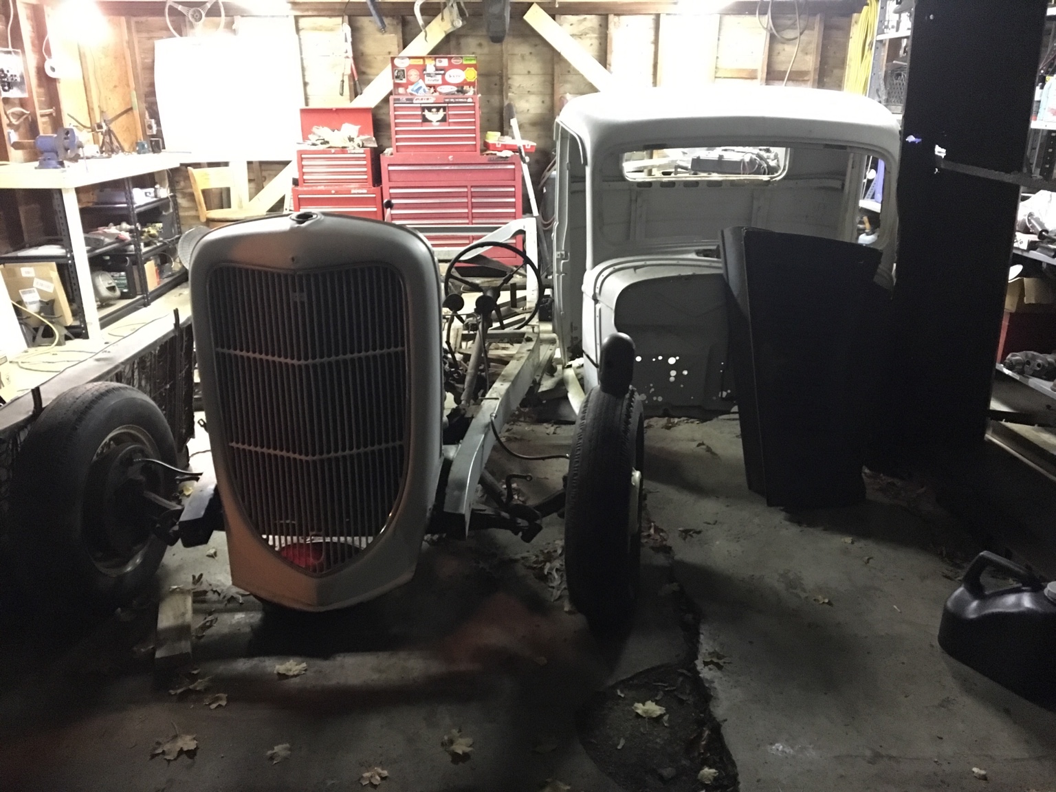

    And we have updates! I got the truck in the garage, after hanging some lights, building a workbench, and putting up some shelves. Now I can finally get to work.
    Got the cab off the other day with some help, now to get this rolling chassis driving!

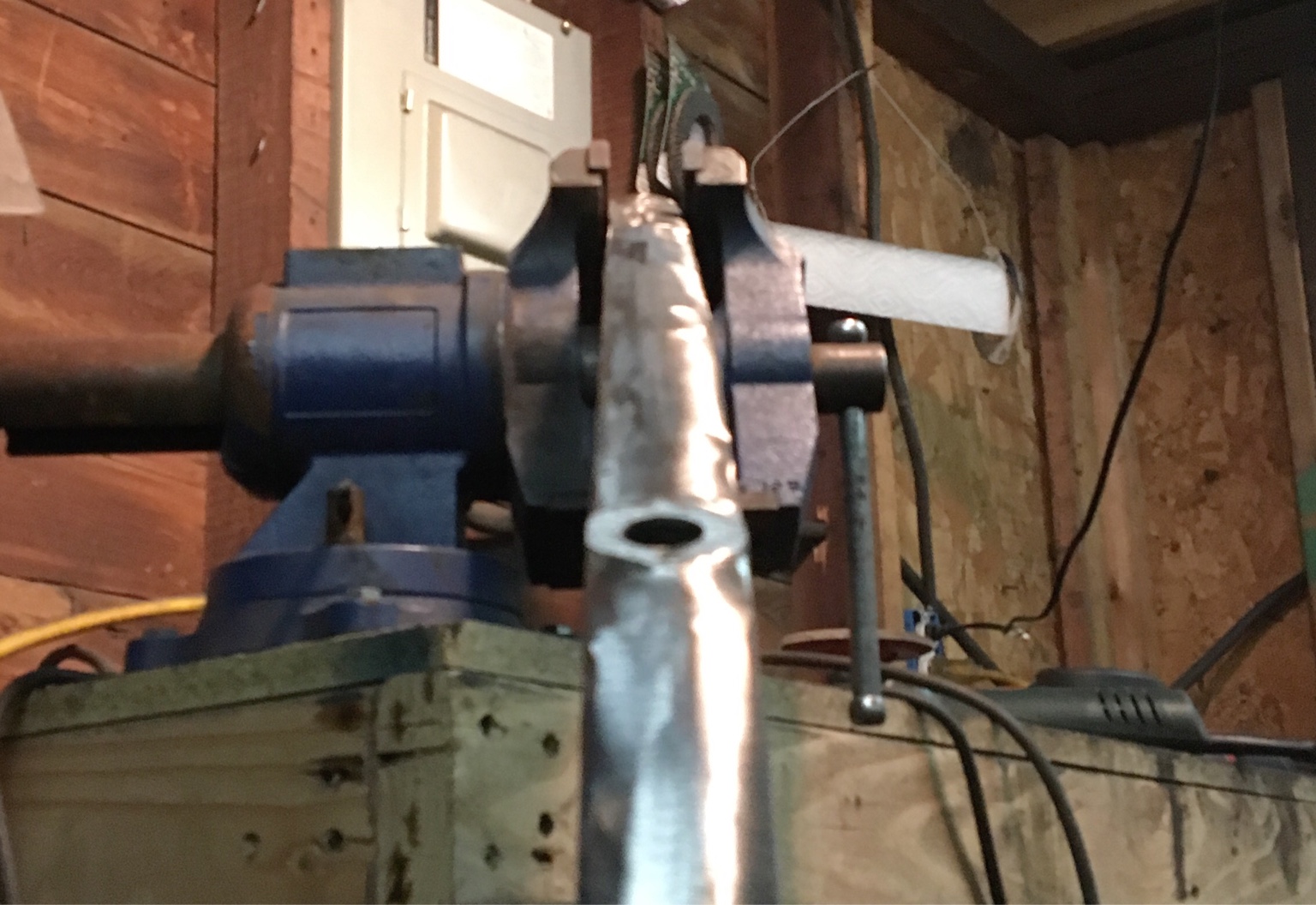

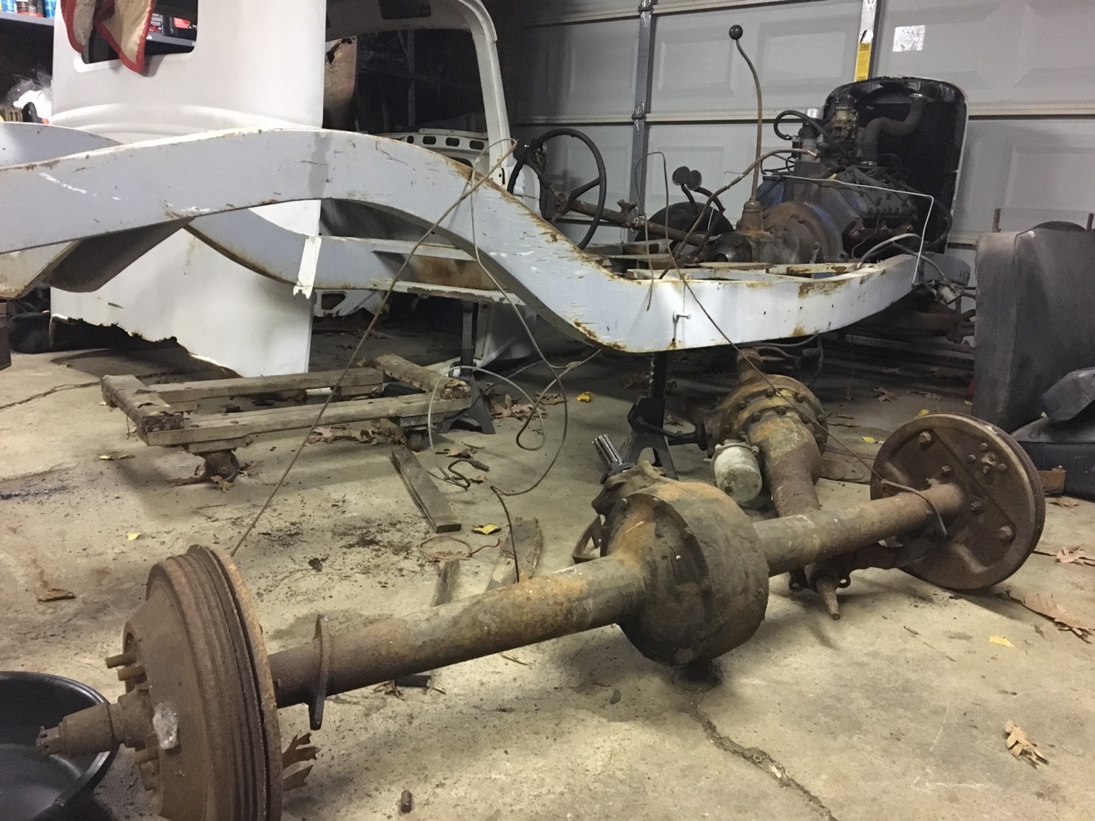

    Today I got the rear end out along with associated parts. Now to clean them up a bit and get them to the powder-coat guys. I'm also planning on using the '35 radius rods with the late Columbia 2-speed, so I'll have to fab some brackets for that.

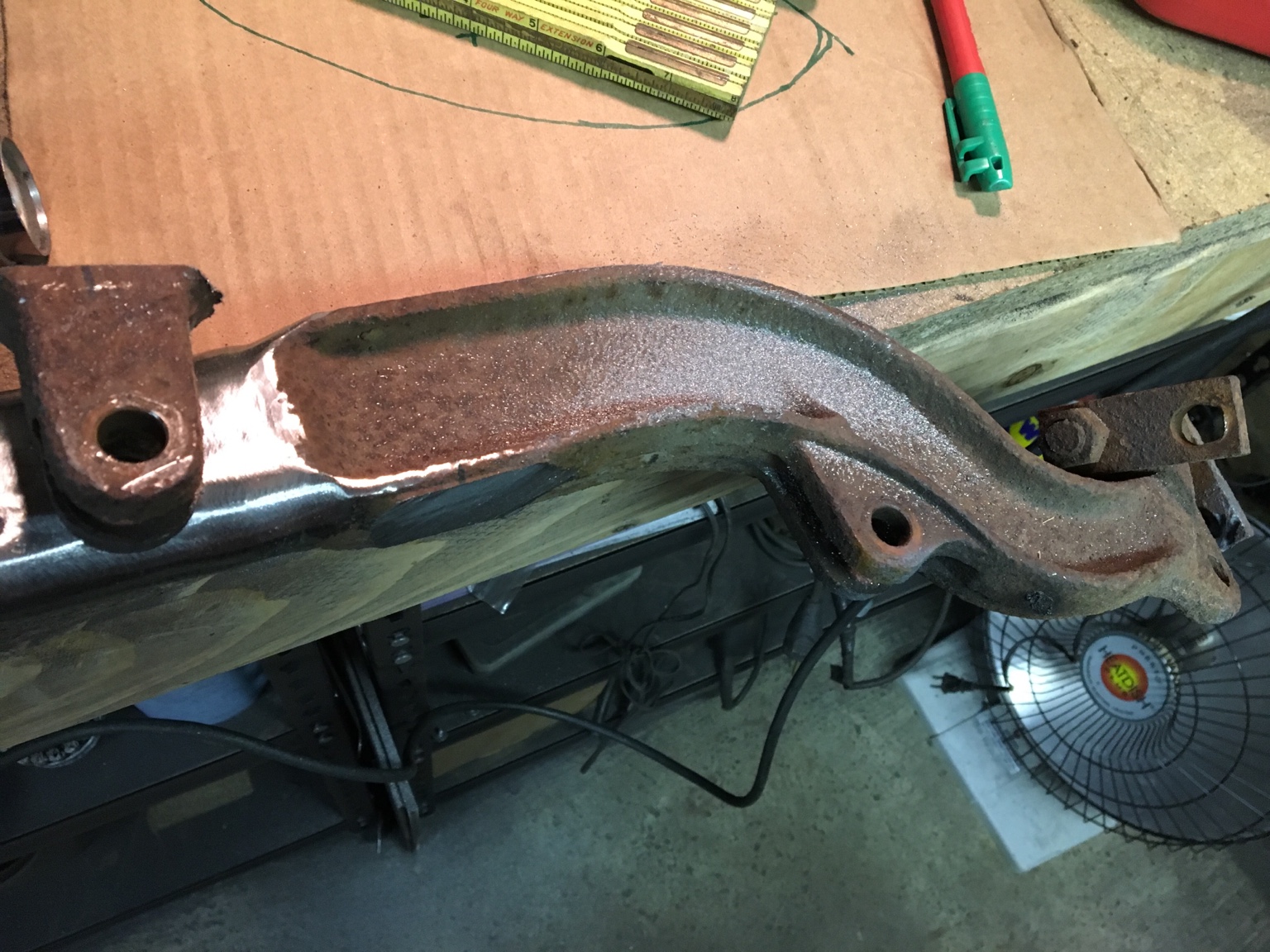

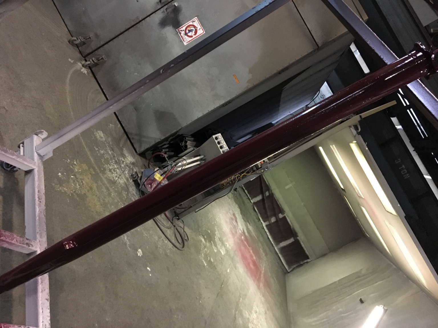

    Update! I've been busy, despite my lack of showing it here... got the rear radius rods all cleaned up and shiny, same with the torque tube. I'm currently working on adapting the '35 rods to the '46 ish Columbia with its larger axle diameter.

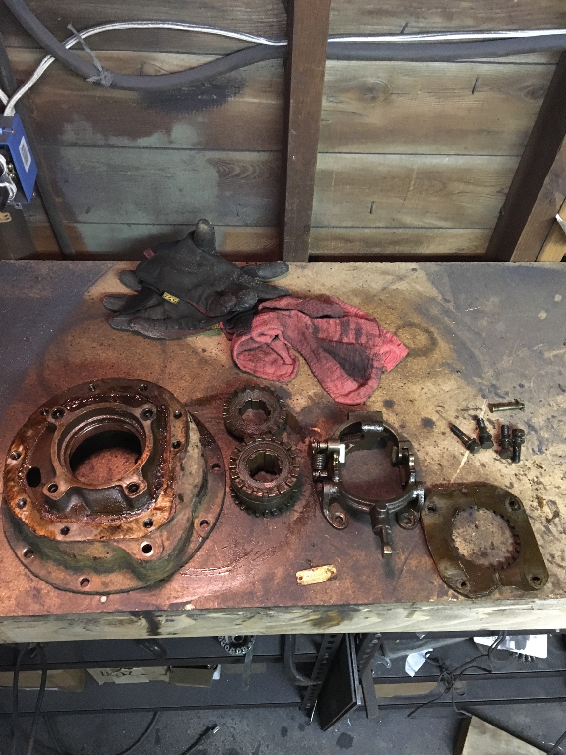

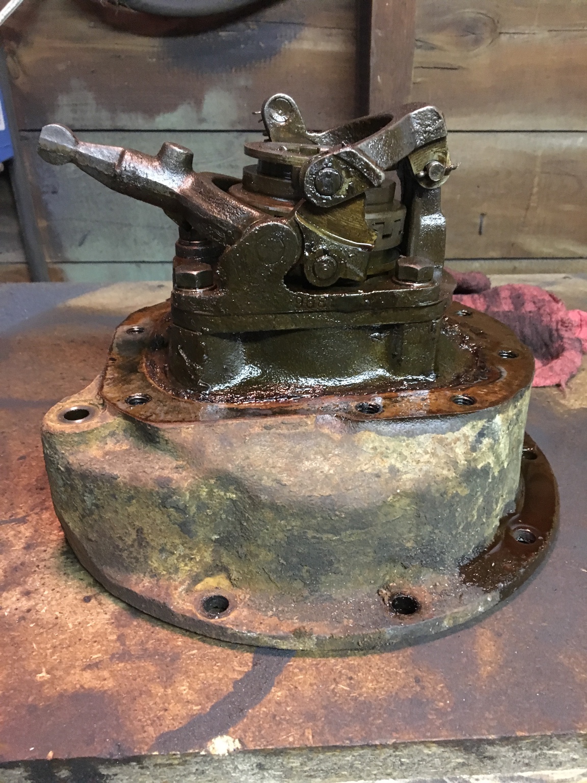

    Got some more things done! Rear driveline pieces are ready for powder coat. Columbia internals look real good aside from one gear that's a bit pitted, and front end is mostly apart.

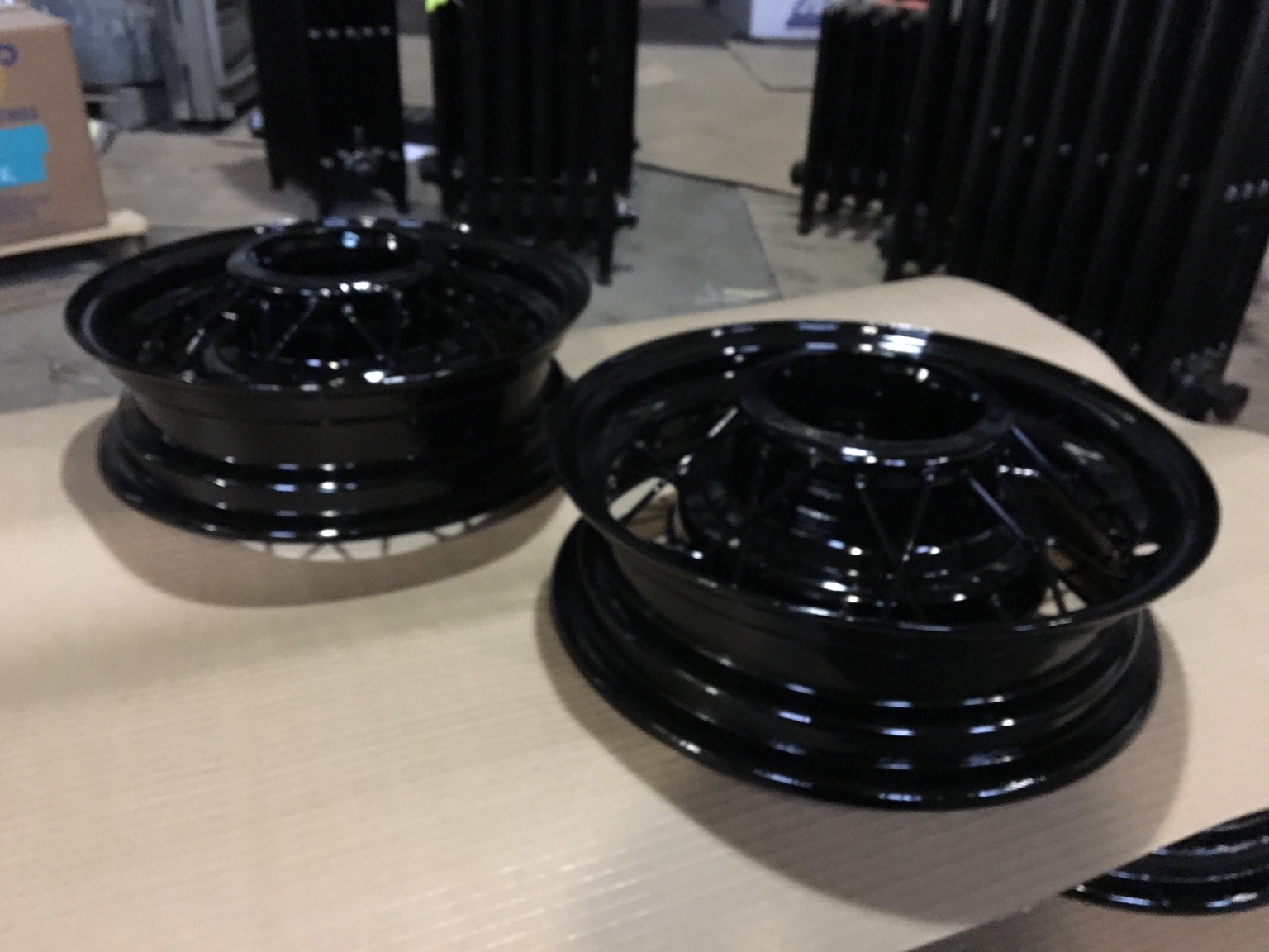

    Tires are off and wheels are ready for blasting and painting. Took the front end off too, and boy are those axle perch bolts stuck! did a lot of heating and hammering to no avail, so my buddy Tom took the whole thing up to his dad's shop and got it disassembled.

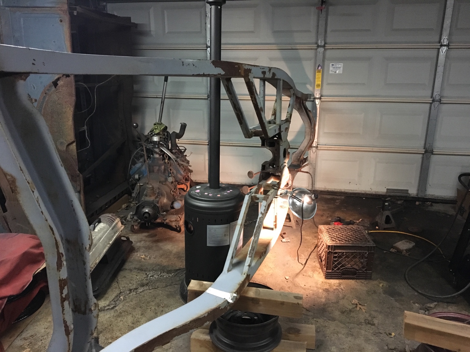

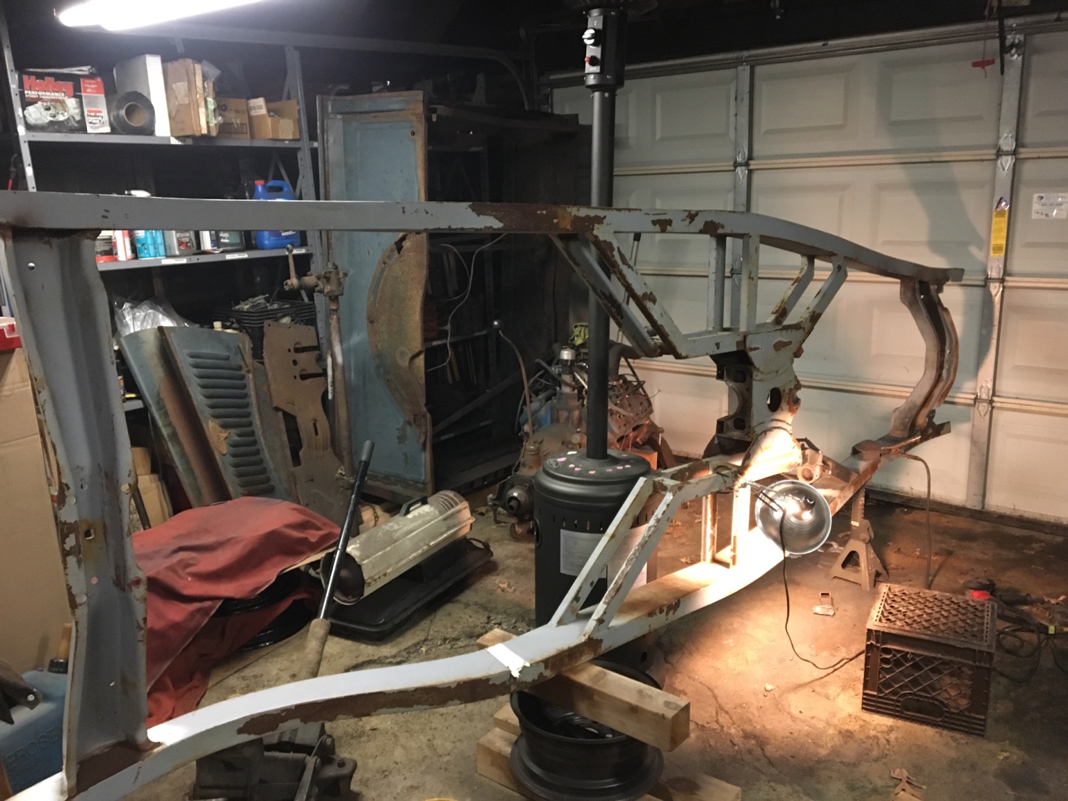

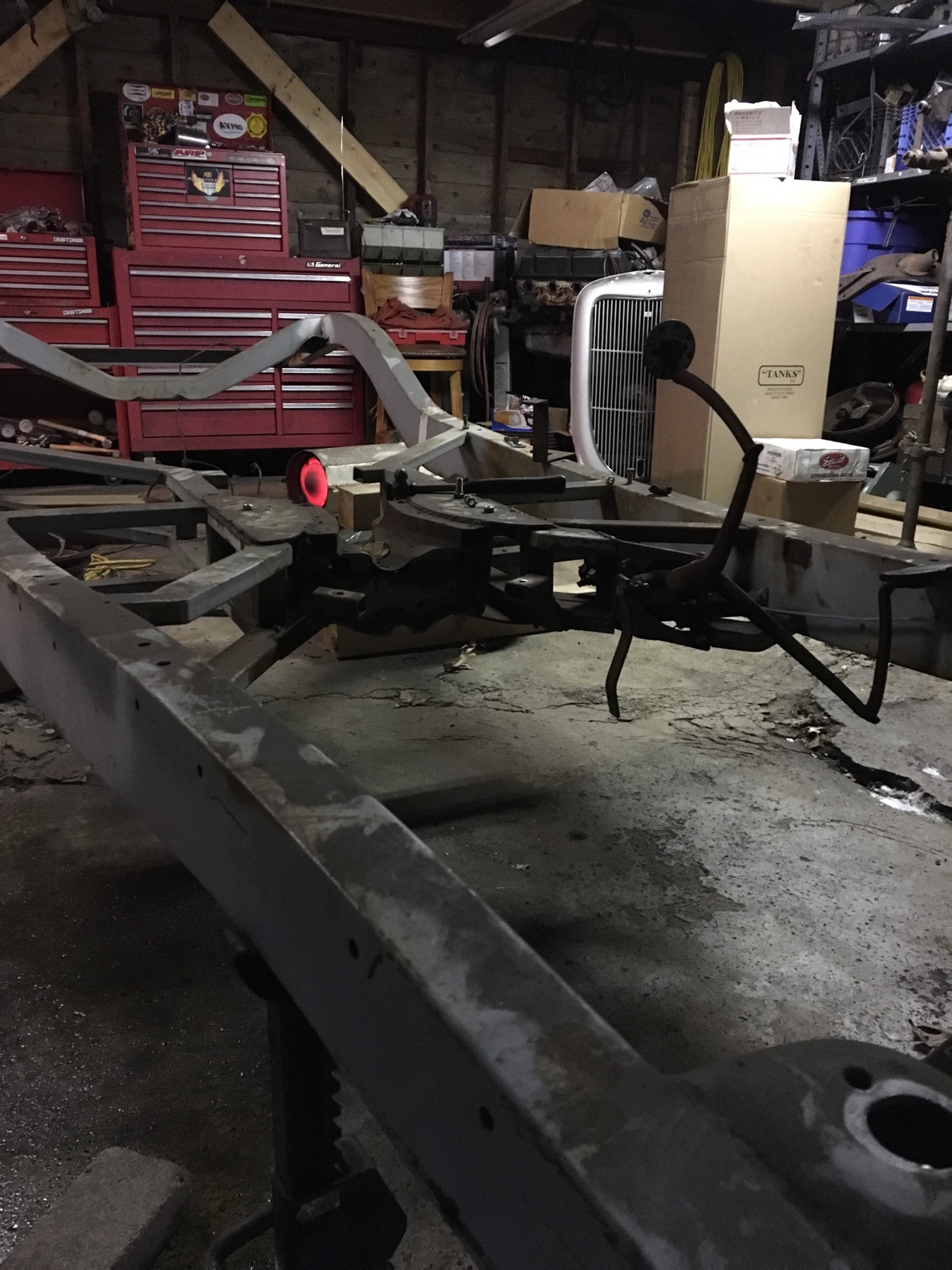

    I got some things done this weekend in the cold. Engine and trans are out, and some small parts are at the powder coater. Since I have a manufactured frame, I measured all the holes and such, and found that I'm missing a couple, so I'll have to add those in.
    Also, I found that the front crossmember (and thus my motor mounting position) is flush with the frame - correct for '39 and later I believe - and I need it 1" under the frame rails, so I cut that out and will be modifying and reinstalling this week.

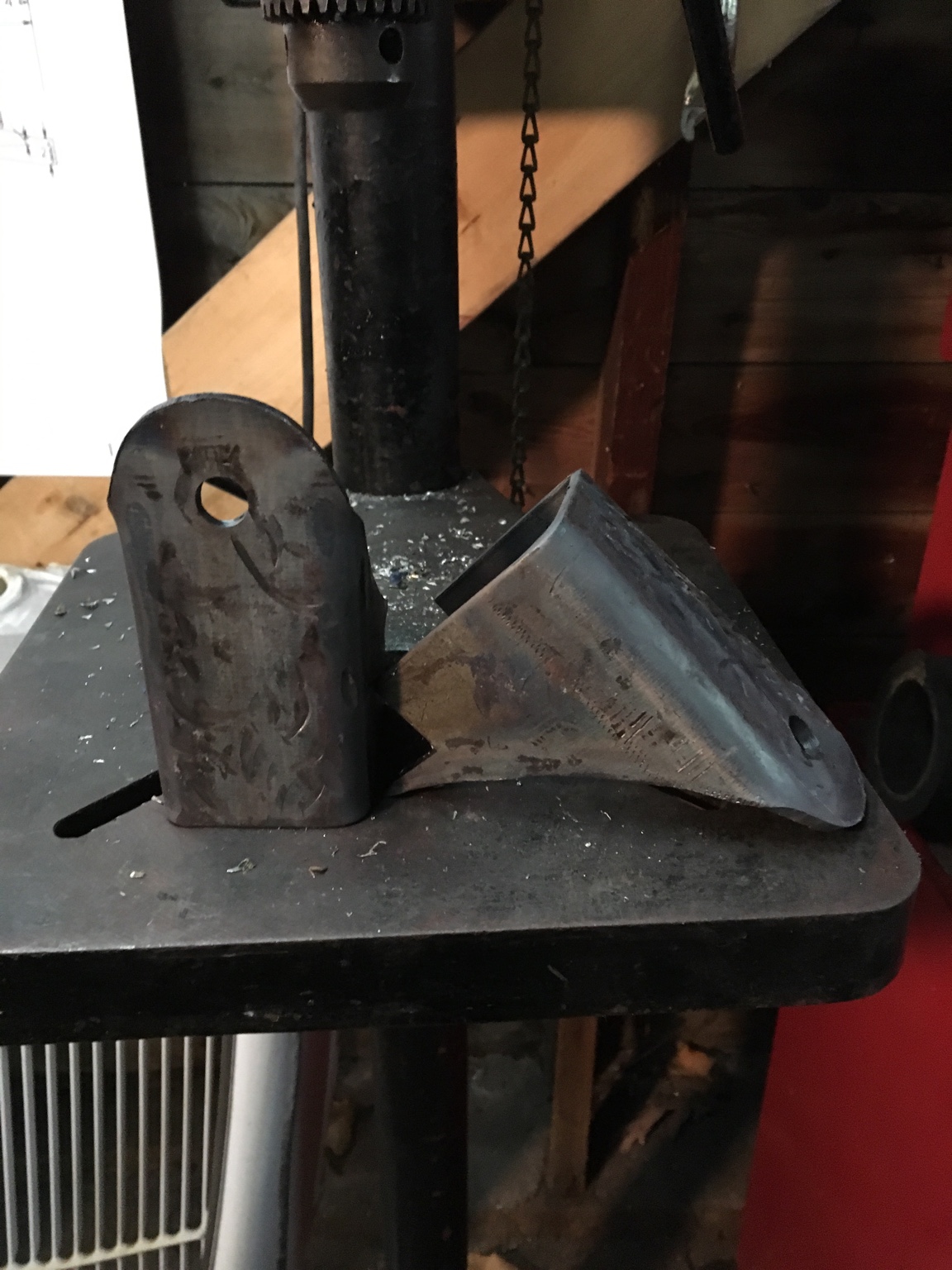

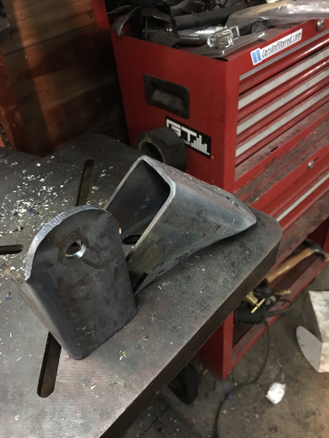

    I did some work this weekend fabricating trans mounts and welding them in. Planning on using a rubber spacer to mount, not unlike the front engine mounts. I've got the rest of the frame pretty much sorted, so I think it may be time to clean and paint!

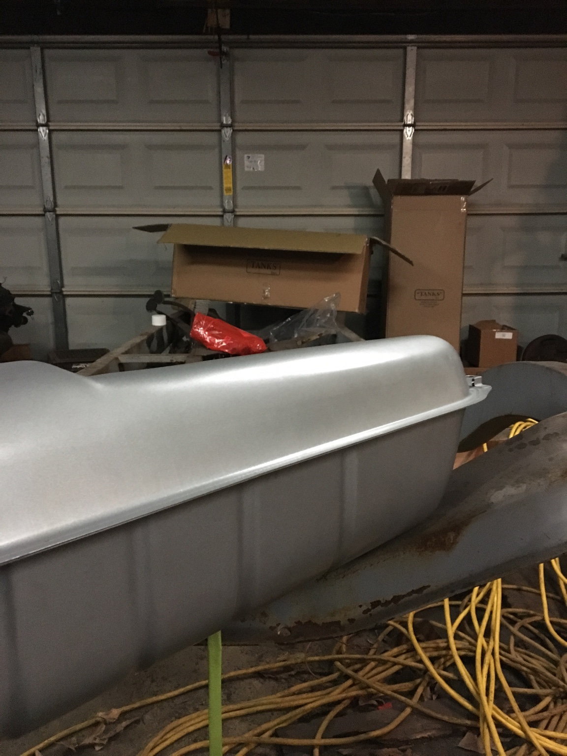

    Trans mounts are in and welded and such, and the wishbone and front axle are off to get prettied up with some powder coating. I drilled some holes and test fit the tank yesterday.

    Well gents, I’ve been getting a little work done over here, namely finishing the frame mounting points and getting the axle housing tubes machined and repaired.

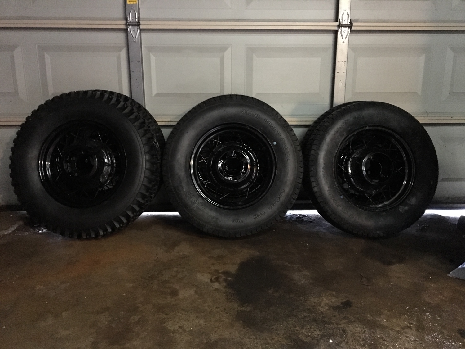

    Took the frame in this week for blasting and powder coating, along with some small parts. While I’m waiting to get it back, I finished mounting tires. The traditional way...
