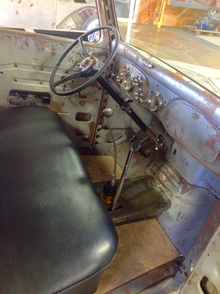

    Please pardon the surface rust, it has been incredibly humid lately. Here's the hood stuff I promised. Built a structure inside the hood using 1/4" steel rod. Mounted dzus fastener plates to that. Then made brackets that bolted to the firewall/cowl lip and grill shell to attach the dzus fasteners (with the thumb screw handle thing built into them). The hood props are from Carolina Custom, one on each side. Both hood top pieces can be held open at the same time. The dzus fastener setup is very sturdy and keeps the hood lined up exactly where it needs to be every time.
    Some other small stuff. I filled the seams in the cowl under the beltline. Fit the inside door handles, window mechanisms, and made glass patterns. The steering column is completely mounted. The stock column was shortened and made to use a U-joint at the bottom with a kit from CPP called the "column saver." Did a little modification to the toe board and welded a ring around the column for mounting. The firewall still needs to be filled there. Shortened the shifter about 1.5" for better clearance around the steering wheel and modified the end to use this cool knob found on eBay. Pedal pads are Lokar. Dash switches are SoCal though the knobs will be changed, one is headlights and the other horn.

    Neat gauge panel...neat shift knob...
