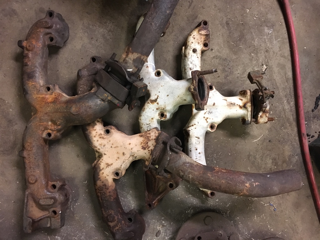

    I used a 1969-72 full sized Chevy truck passenger side rams horn exhaust manifold on the driver's side to clear the steering box on my 1940 Ford Coupe.

    Thanks for the kind words guys. Soooo..... I picked these up last weekend from my buddy, but hadn't had a chance it test fit before I posted the other pics.
    Next up is finishing the reenforcement for the shifter notch and repair and fit a pair of rough '39 pedals. The bracket and shaft are ok, but the pedal arms have been hacked and welded.

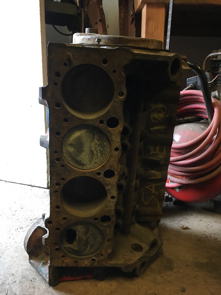

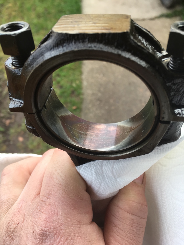

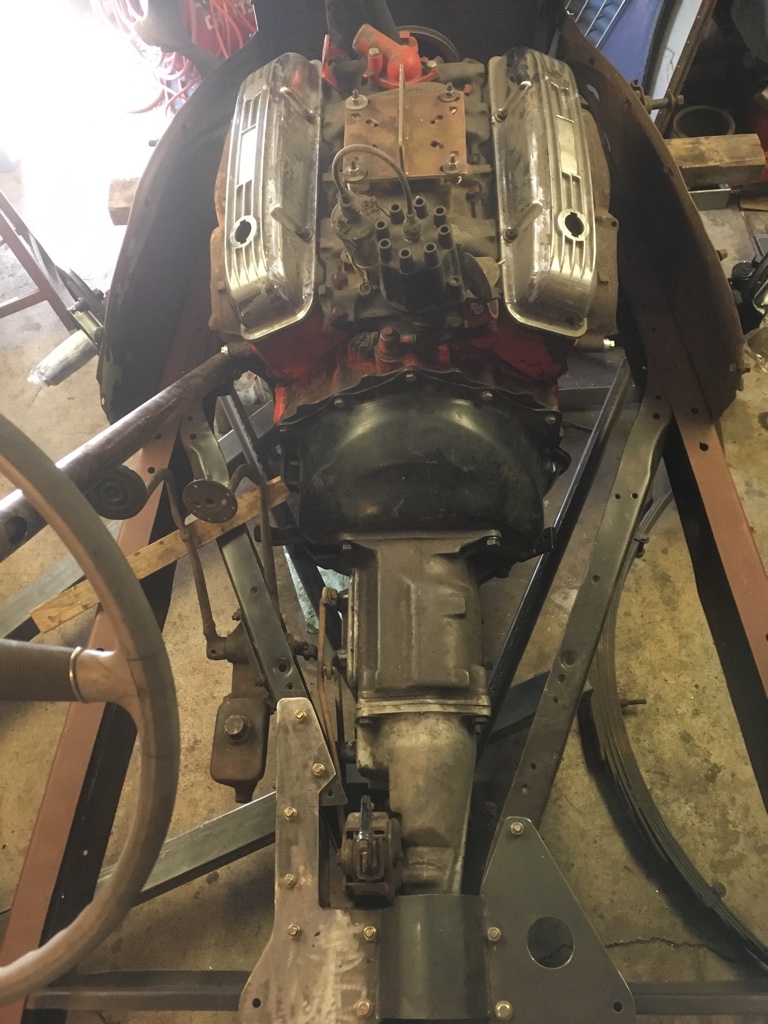

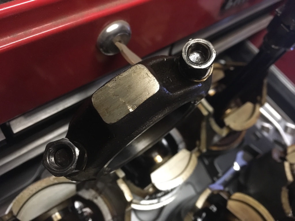

    I tore down my "new" 327 and found that it was bored .060, has worn valves, a broken ring land, gallons of sludge, copper showing on the rod bearings, a K-Mart oil filter, hammer marks on the rod caps, and weird fluffy gravel shit in one of the bores. I think I can get the bores clean with a hone, and I haven't found any cracks yet.

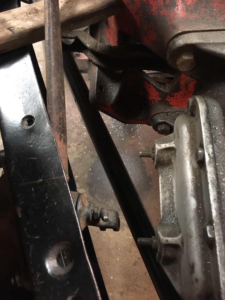

    After making a template off of a friend's '40 frame, I whittled a hole in my frame for my '39 pedals.
    I mostly finished my bracing for my shifter hole in the frame. There's a little more to do when I flip the frame over again.

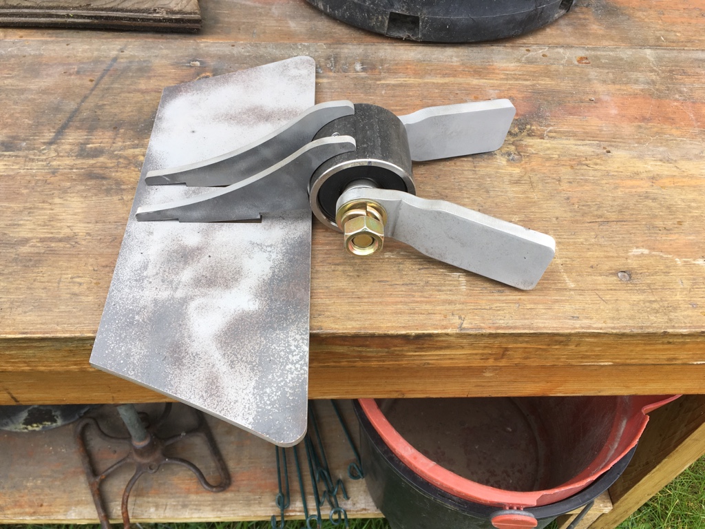

    Next up, I'm hanging the rear suspension with my laser cut parts and my Johnny Joint.

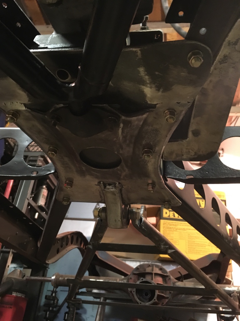

    My center mount has come together. I fooled with it longer than I should have. It went in well and right now my wheelbase is within 1/16" from side to side. I'll know more when it's sitting on the ground I suppose.

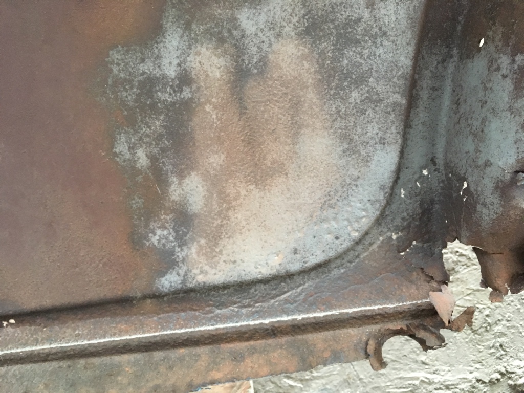

    The body has been sitting on a pallet in the driveway. The floor is shot and the sub rails are so so. I've got a good sedan floor, and an ok one too. The trunk riser is 9.5" farther back on coupes, so I'll need both of them. Between the 3 floors, I think I can get where I need to go.
    I've been out in the dark with a headlamp drilling spot welds. Can't play until the kids are in bed.... excuse the bad picks. Floor and sub rails are out.

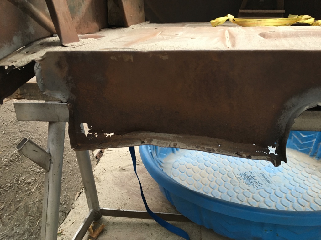

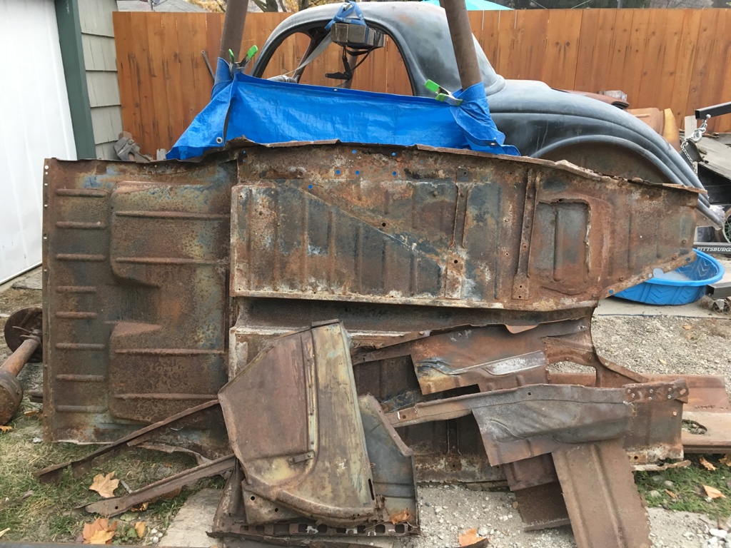

    I've been trying to get the floor and subrails sorted so I could get the body on the chassis and in my garage before it snowed. I failed, winter seems to have arrived. Anyway, I've been trying to clean up the lower parts of the car I'm keeping. My compressor is small, so I've only been blasting hard to reach pitted stuff. I'm in for a lot of wire wheeling and sanding this winter.
    Parts floor, coupe subrails, cowl chunks.
    Cleaning up my best sedan floor. It's upside down.
    There are a couple rough spots, but between the coupe floor and parts floor, I think I've got most of what I need.
    So the plan is piece the subrails and floor together, strip the rusty crap out of the cowl feet, set the body on, rebuild the cowl feet, fix the B pillars, and then deal with the missing 9 1/2" of coupe floor and the damaged coupe riser. I think I've got cowl feet parts and B pillar parts somewhere in the pile.

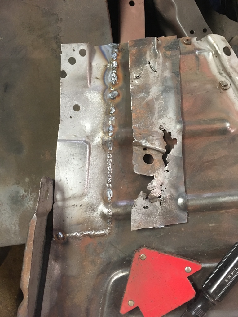

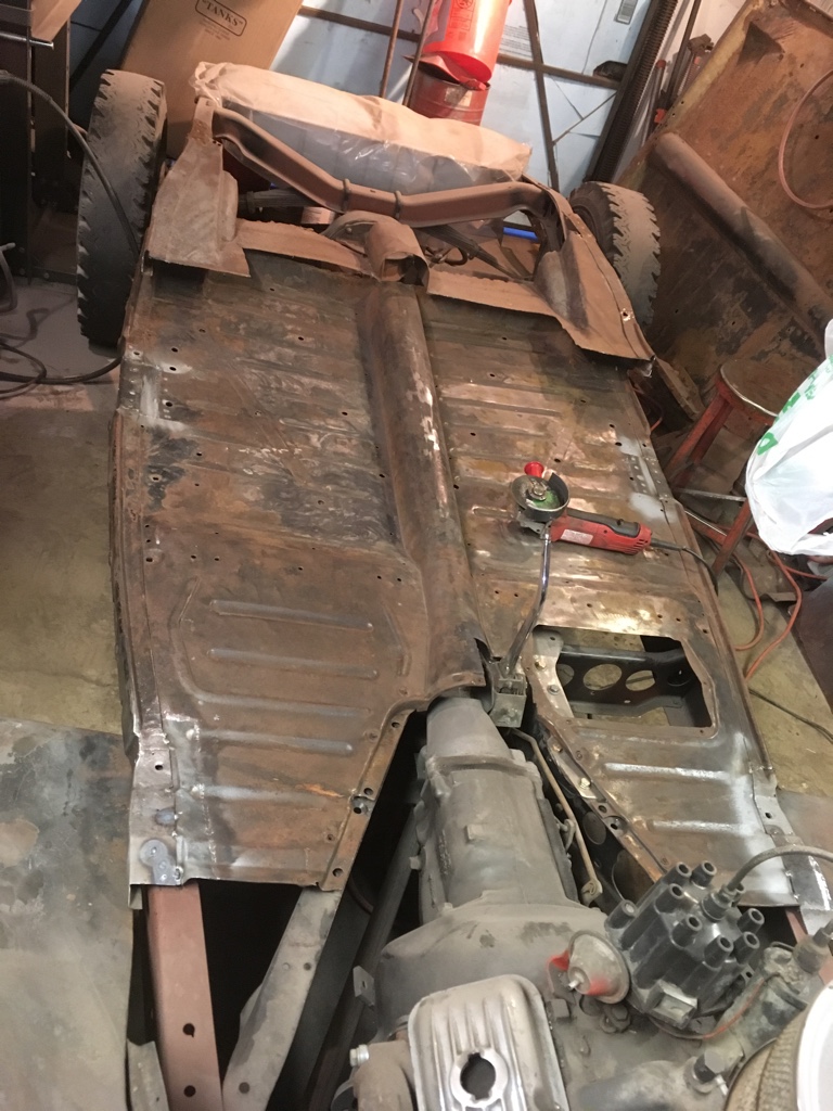

    I've been pecking away at the sedan floor and subrails hoping to get the body on. I'm not there yet, but other than 3 pin holes and a 22 hole, the subrails and floor are rebuilt up to the rear kick up. There will be parts from 5 cars in this floor/subrail assembly. I've still got a couple welds to grind and some hammer and dolly work too. My welds aren't the prettiest, but I'm getting good penetration and they grind out nice. I'm using 10000 tiny tack welds and moving around a lot to minimize warping. This is all a learning experience for me.
    Next up is repairing and attaching the coupe kick ups.

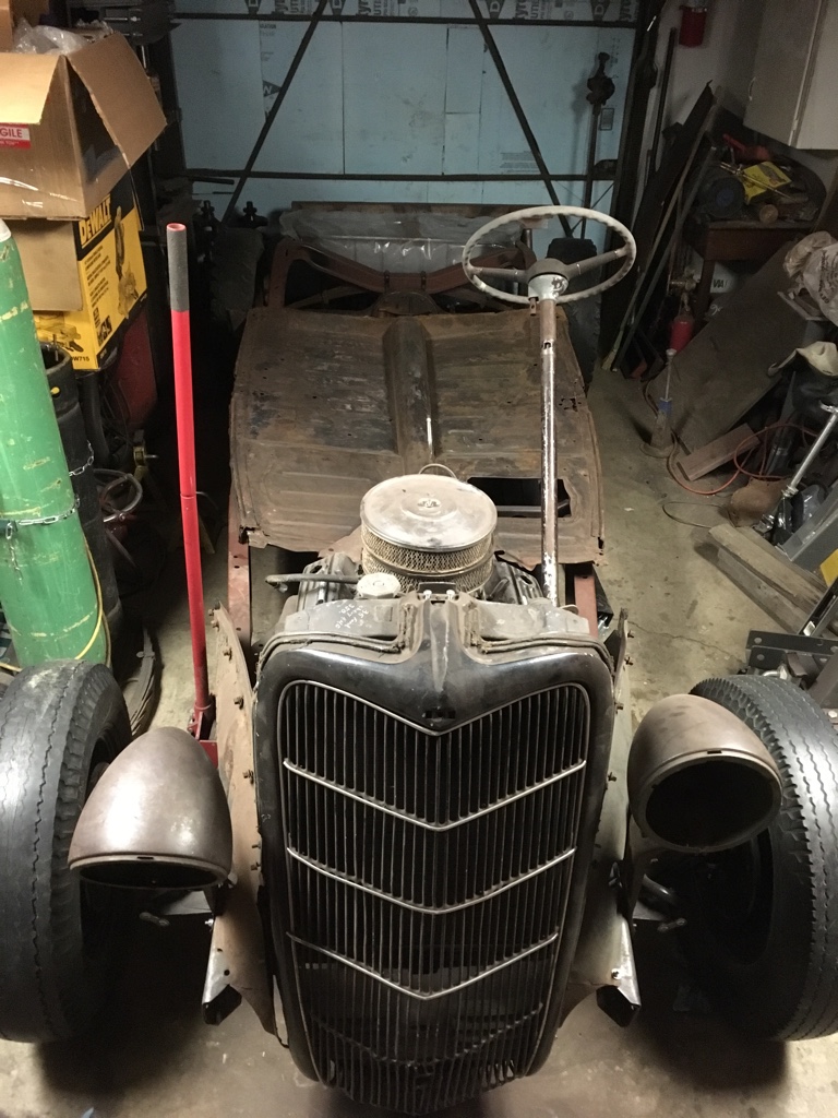

    I was going to get the body on before snow flew.
    That didn’t work. I got the cowl feet gutted and the internal areas sand blasted. I got my kick ups welded in.
    I’ll do the middle area with the tunnel when the body is on the floor for good. I scored a stuck 301 for $40. It’s a 58-62 283 bored an eighth over with old pop up Jahns pistons. I’ll soak the pistons out and see if it’s a winner soon. It came with a $20 ‘73 4 bolt 350. Dished pistons. It got wet at some point. 993 heads that look like they might have been ported at some point. I’ll save it for a future project.
    Here’s the fun part. I finally put my body on tonight.
    Winter is a pain in my ass. My pea gravel driveway full of ice ridges, everything is wet and cold, and it’s hard to go out in the cold to work after the kids are in bed. I can’t believe my wife wants me to go ski in this junk.
    Next up is clean/reorganize the driveway and garage. Then I’ll bolt the body down properly, rebuild the cowl feet and start working my way back.

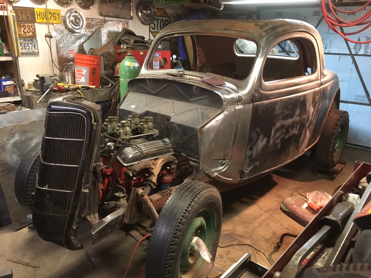

    I’ve now had the coupe a little over 2 years. I’m not setting any records but I’m having fun. I hit a late winter lull and didn’t go in the garage for a while but now I’m back at it. I finally pulled the trigger on some parts I’ve known about for a while. I got a really decent set of ‘37 bumpers and a Offy 4 deuce intake with 94s on it. The carbs and intake are nice but the linkage is cheese ball.
    I’ve been doing rinky dink stuff on the cowl. I got the dash out, the hinges out including the cut lower ones, and opening up the cowl vent that was welded shut. I’m hoping to save the opening but I have another (or 3) if I need it.

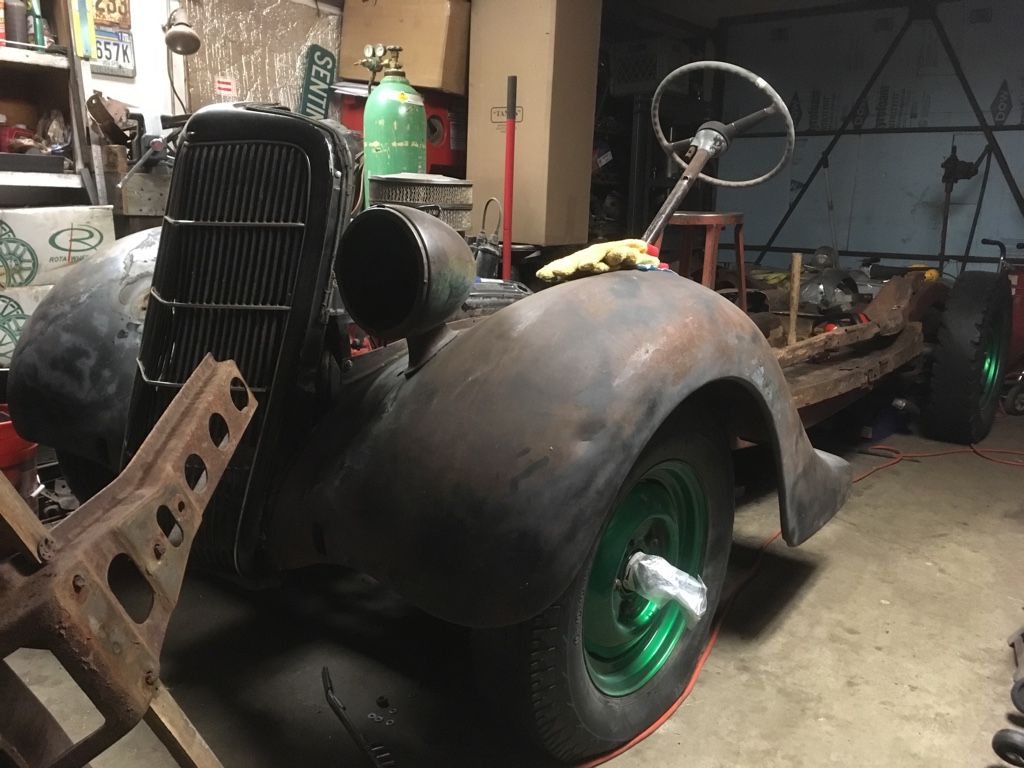

    I’m still in the game.... I pushed hard on house stuff most of 2019 and lifted my Jeep but I’m getting a little ford time in too.

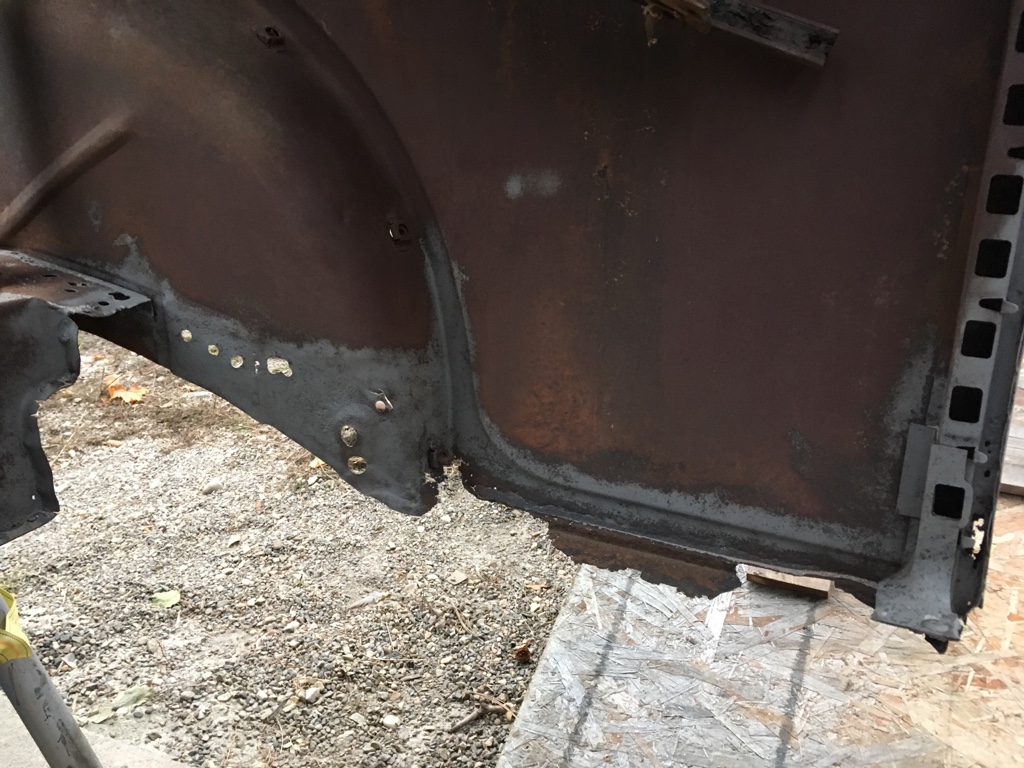

    Passenger side cowl bottom was rough. It had lumpy old patchwork that hat rotted out. After cutting this is what I had:
    And after rebuilding and replacing the inner structure:
    The windshield drain dumps into the A pillar and rotted out this area. It’s like peeling a sun burn. It just gets bigger....
    I’ve got the inner structure patched and soaked with Ospho. I’m waiting for the outer patch to get out of the vinegar.
    Next up will be fixing the cowl vent that was welded shut and dealing with my butchered roof opening. I’ve got a messed up 3 window opening and a nice sedan header. The 3 window I got that opening from was either wrecked hard or a tree fell on it.
