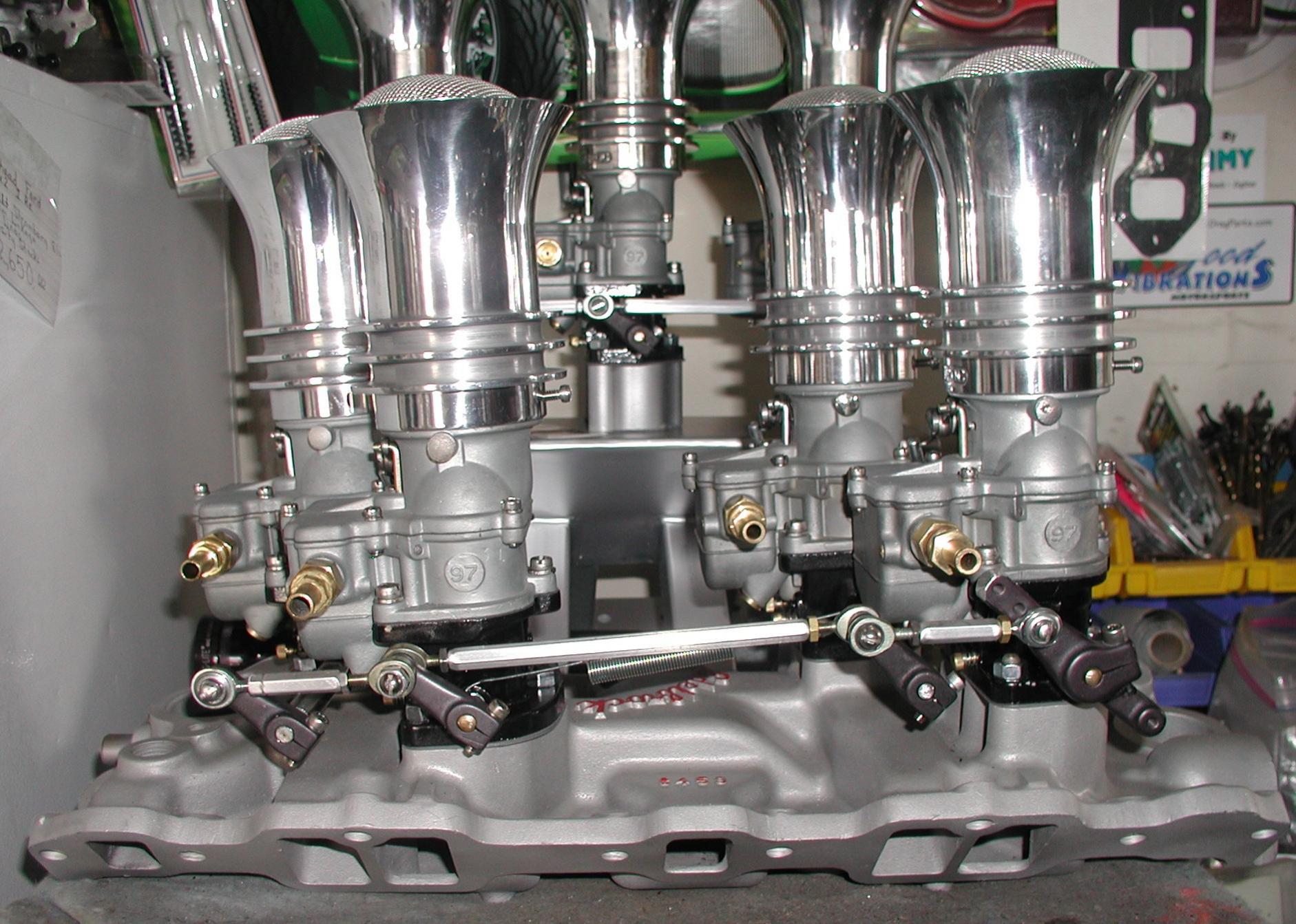

    OK..This would look great sitting on top of that 348..
    Duane.
