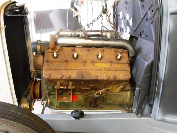

  18. fiftyv8
    Joined: Mar 11, 2007
    Posts: 5,072
    fiftyv8
    from CO & WA
    Simplest exhaust is like this, but still will require some effort.
  19. squirrel
    Joined: Sep 23, 2004
    Posts: 46,362
    squirrel
    Lots of heat near the carb(s) with these engines....
    54caddycoupe likes this.
  20. 54caddycoupe
    Joined: Oct 11, 2011
    Posts: 23
    54caddycoupe
    The exhaust I saw and thought would be doable was on a 346 that used the factory left side exhaust manifold exit port and eliminated the crossover from the right side and ran the right exhaust pipe from the crossover port on the right side manifold.
